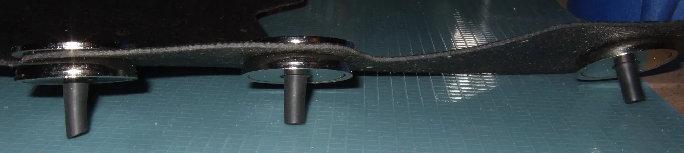

Beveled side of washer facing out, flap, and magnet ring side (beveled hole) facing the frame. I then inserted the wood screw through it all. I then cut some small diameter hose black hose I had laying around in my hose bin, in 1/2" lengths. I tightened the beveled wood screws onto the hose hose to hold it all together. The hose fits the diameter of the smallest frame holes perfectly. The hose was intentionally cut 1/8" longer than the screw to act as a guide when installing the flap. It also insures the flap won't be moving around any under any abnormal adverse conditions, (high winds or water).

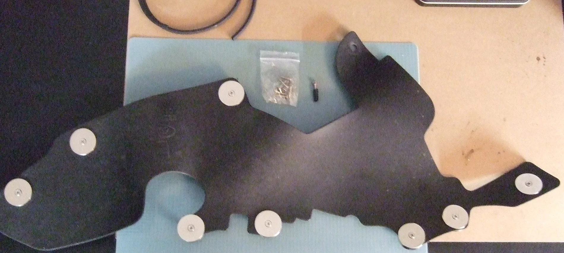

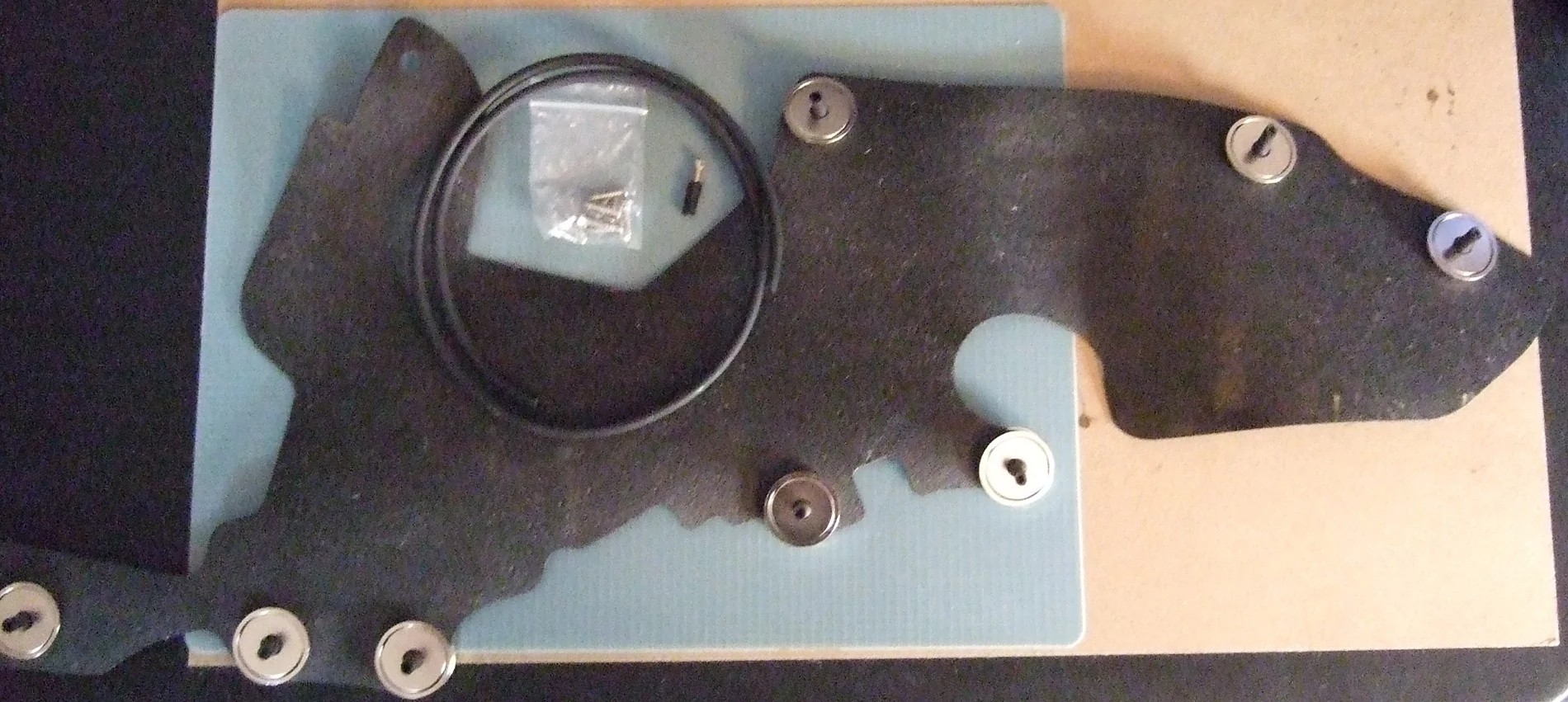

Here's a couple of picture showing both sides of the flap (minus the one that is going in tomorrow when the order arrives), Already tested and it goes off and on easy enough, with plenty of staying power.
The front side

The back side - The screws and hose used.

Impossible not to remember as they are attached to the liner. There is nothing to install. I simply line up the hole and the magnet does the rest, guided my the hose threaded on the screw. See the picture.
The hose (stud) correctly positions the liner and then inhibits lateral movement. The top is the beveled washer and screw, The underside is the magnet facing outward towards the frame, the screw is tightened onto the hose which holds everything together, and the hose fits perfectly in the frame hole.
