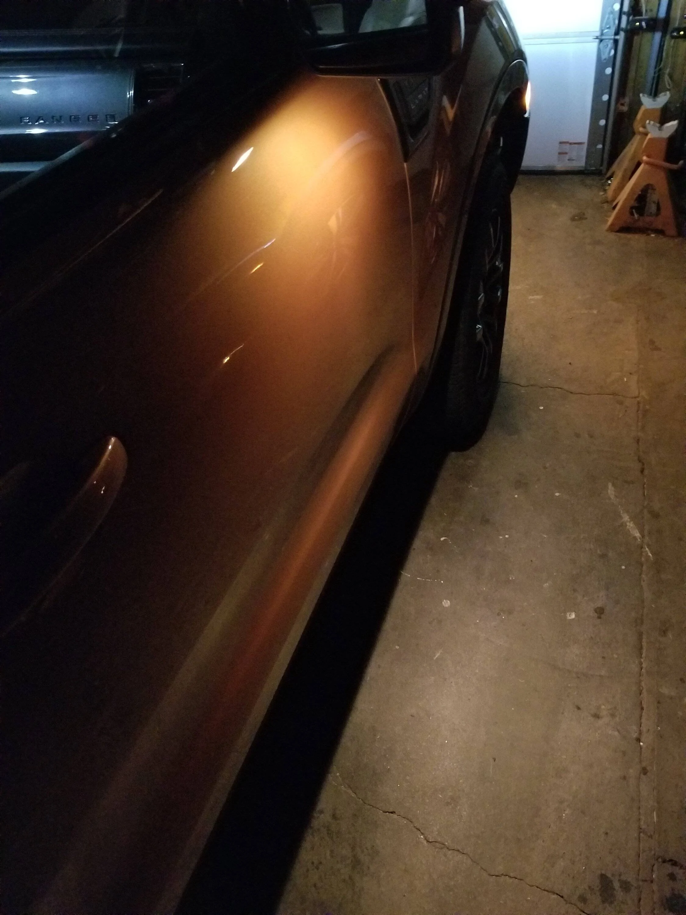

The factory puddle lights are so piddly that I didn't even realize they were there at first.

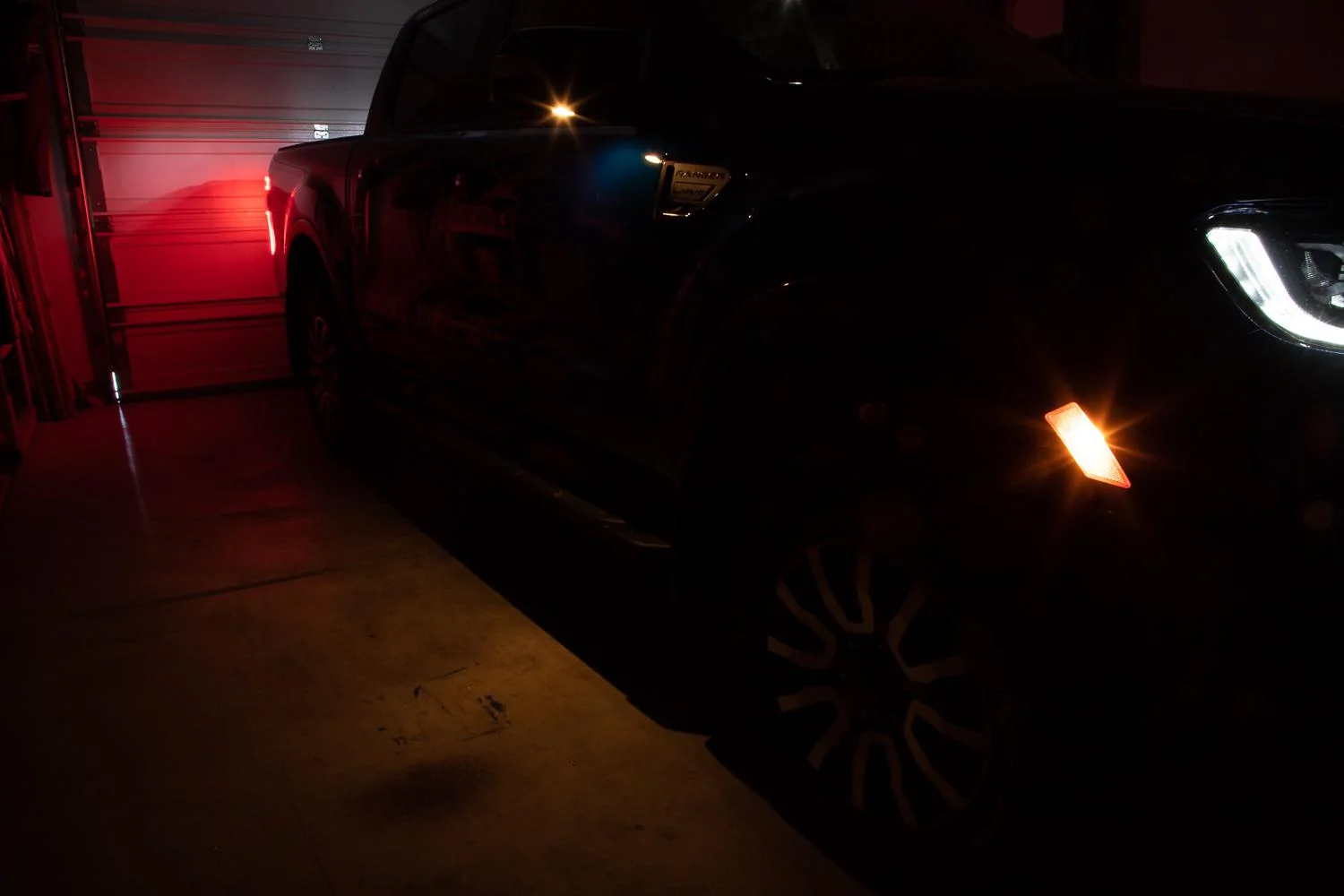

Here is a before and after picture, with the camera settings (ISO, shutter speed, F-stop and color temperature) all locked to exactly the same settings, shot from exactly the same angle.
Before:
After:

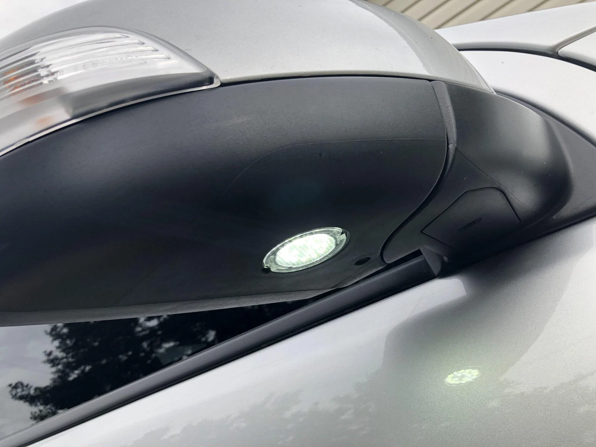

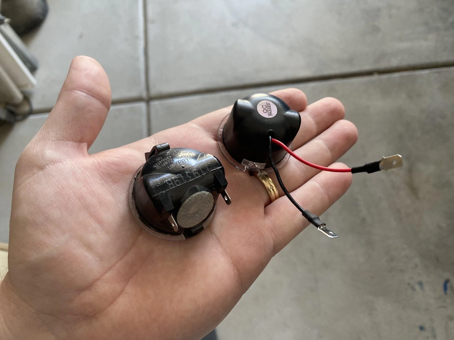

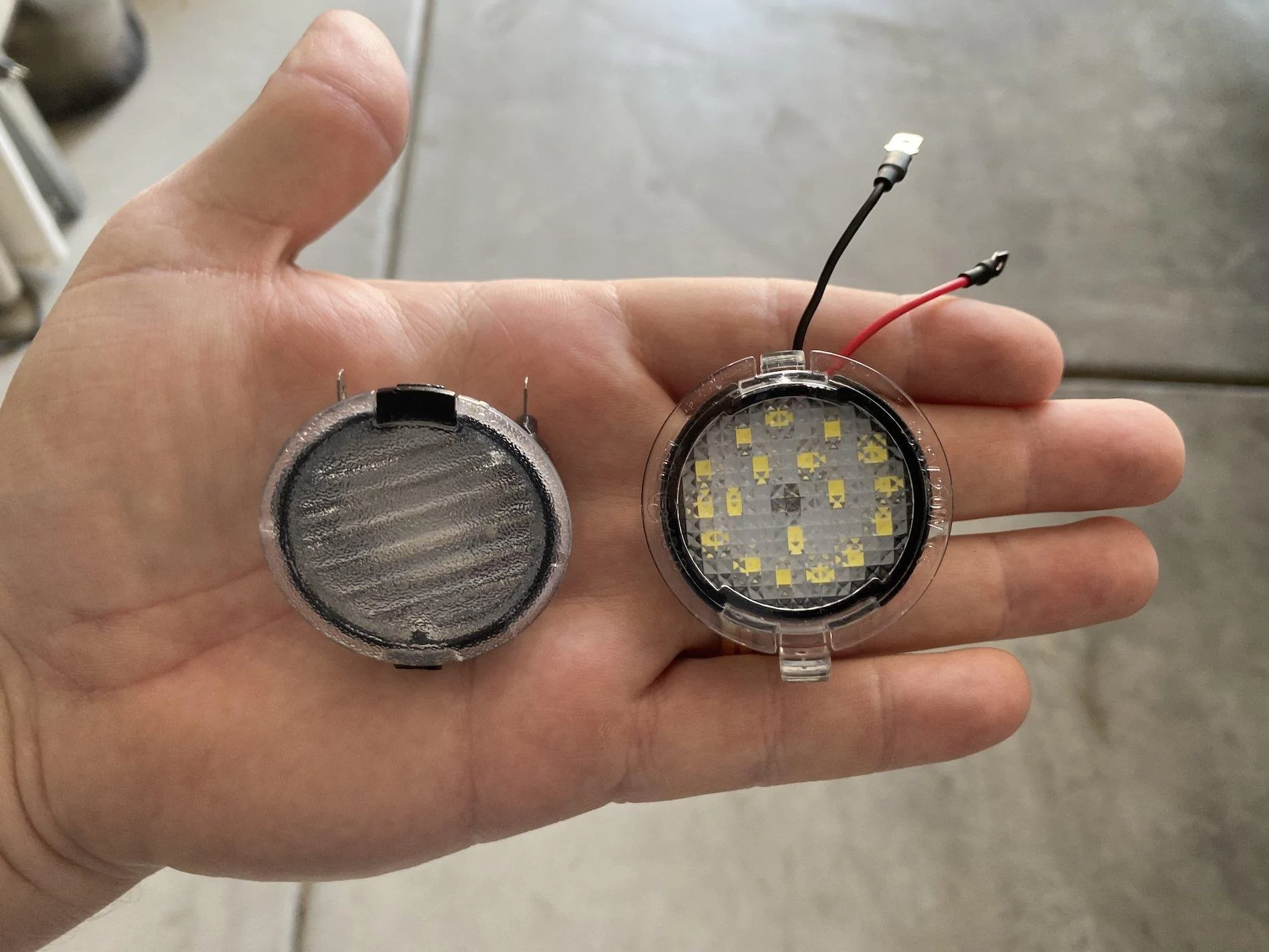

And here are a few pictures that are a little better than the video.
Factory light on the left, upgraded light on the right:

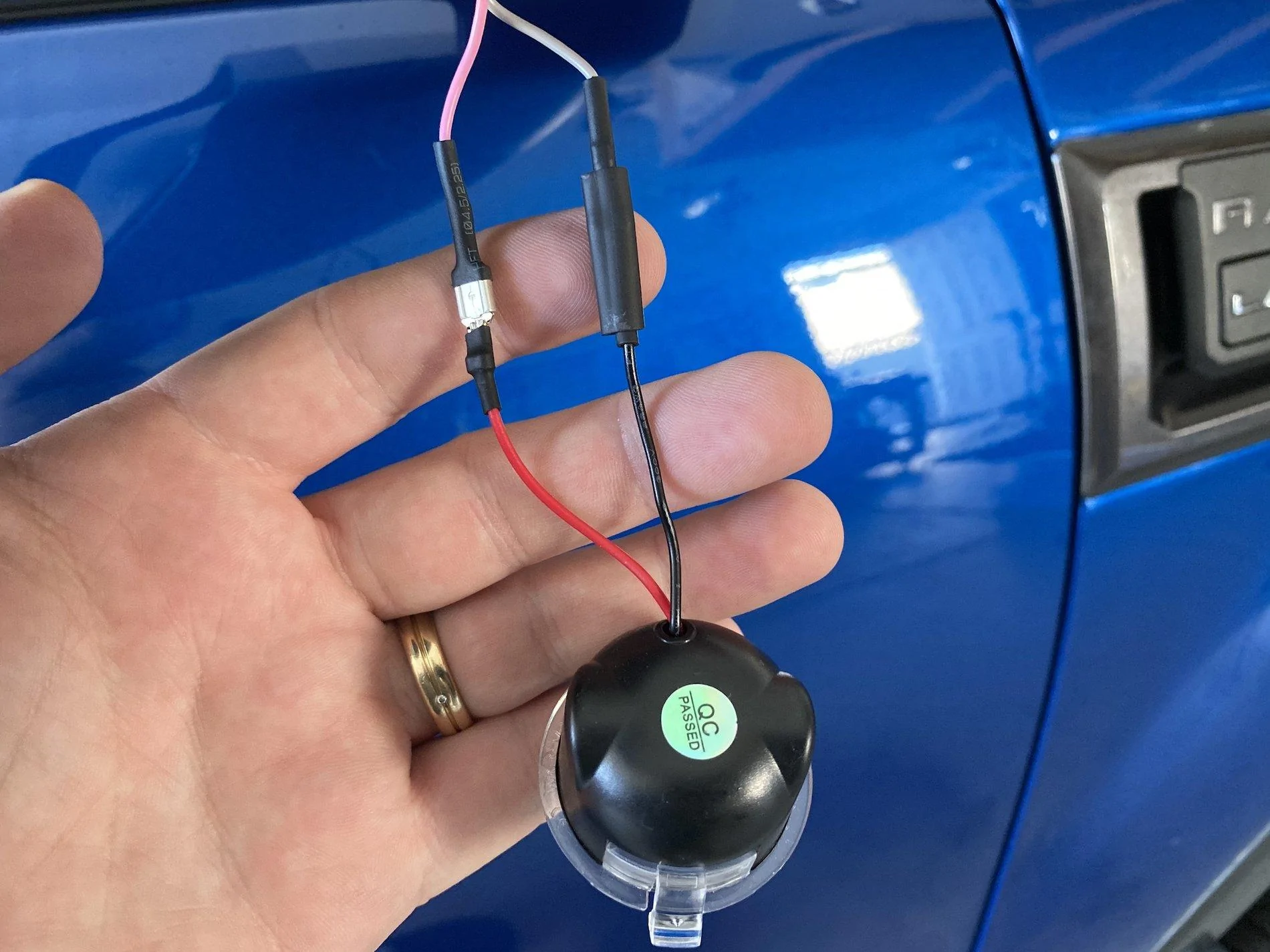

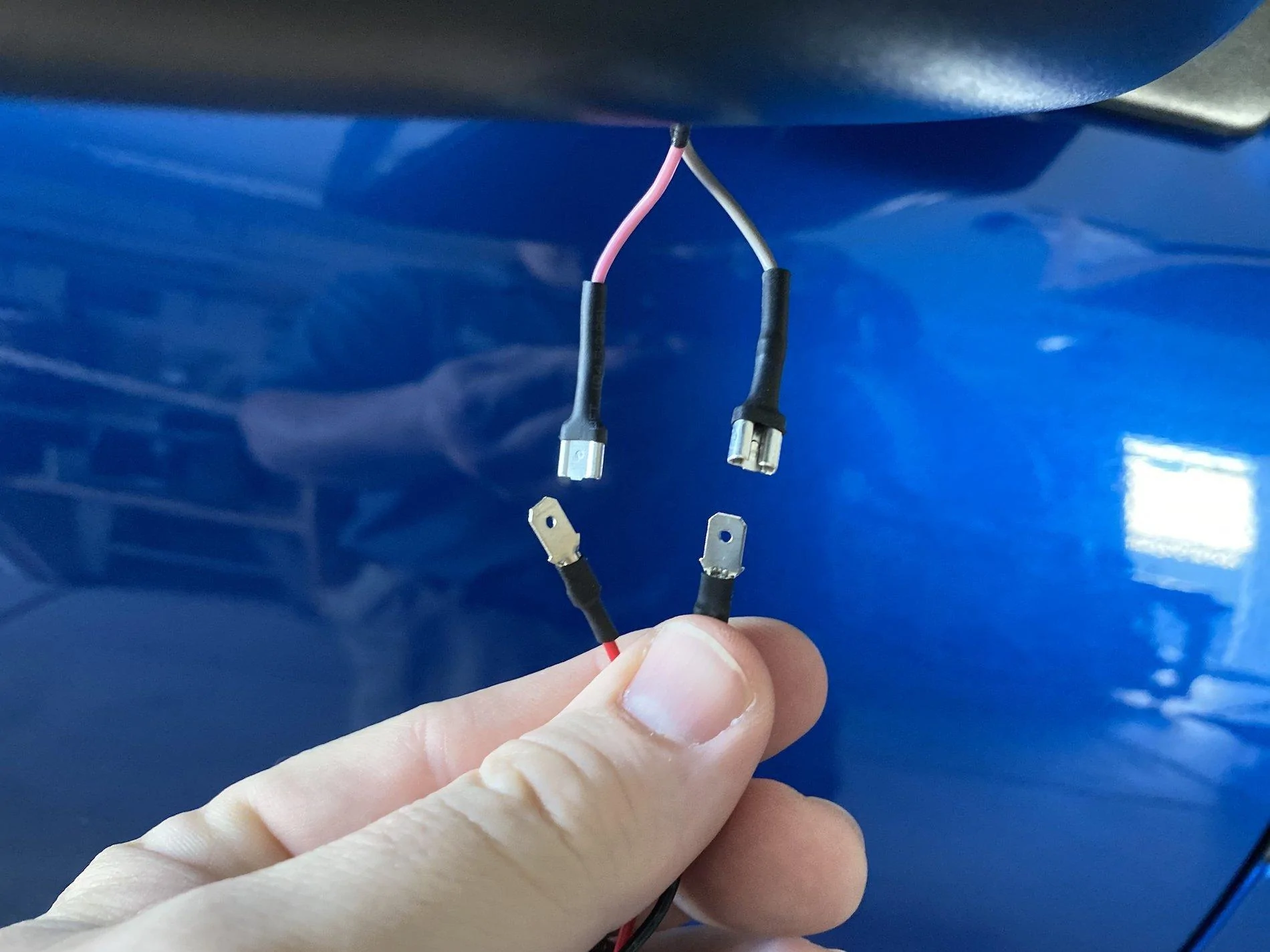

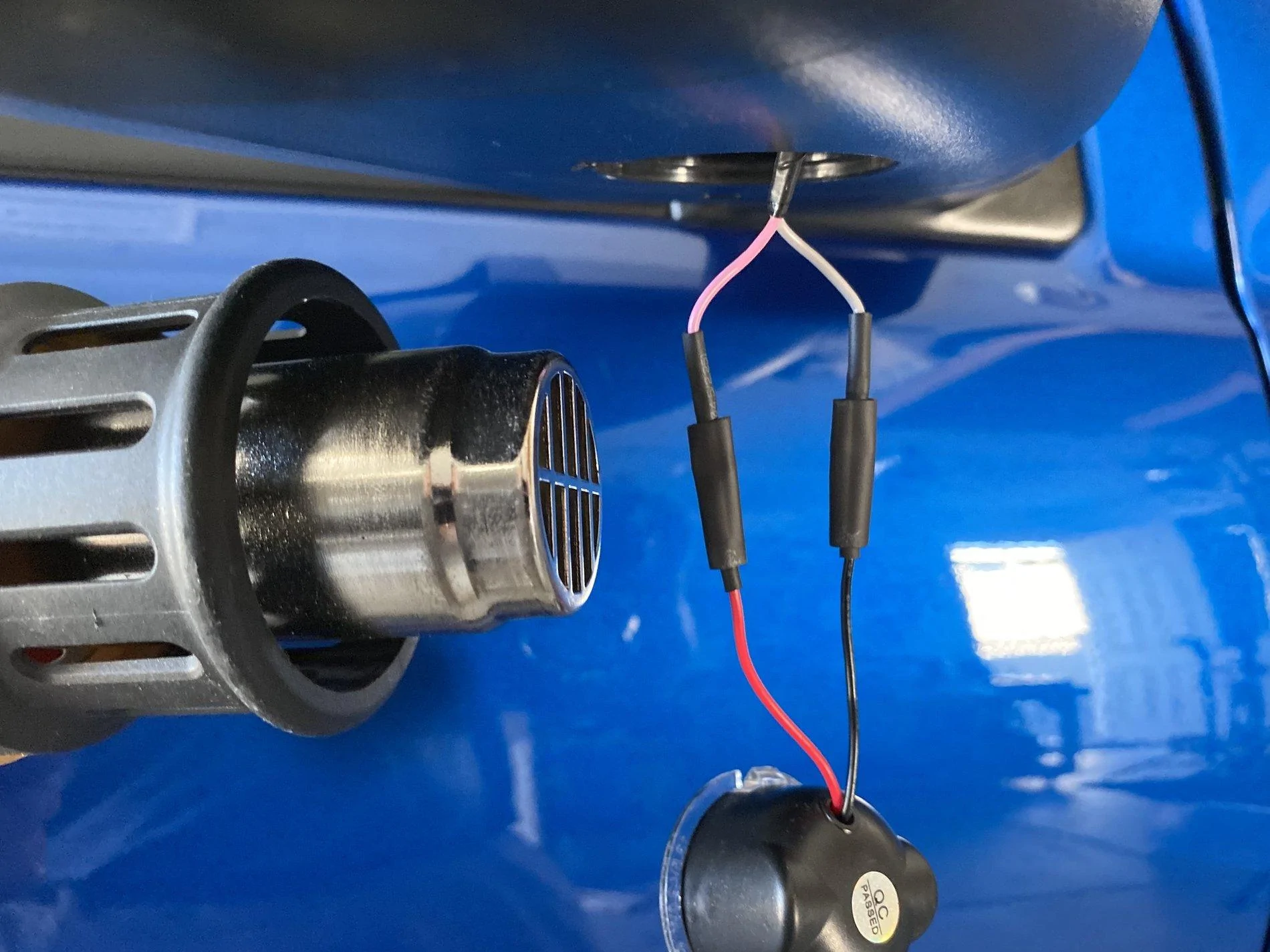

The factory wiring harness could easily short out without some extra insulation, so either use some heat-shrink tube or electrical tape to insulate the connectors from touching each other:
I decided to use heat shrink. Here it is on one side, before I shrank it:

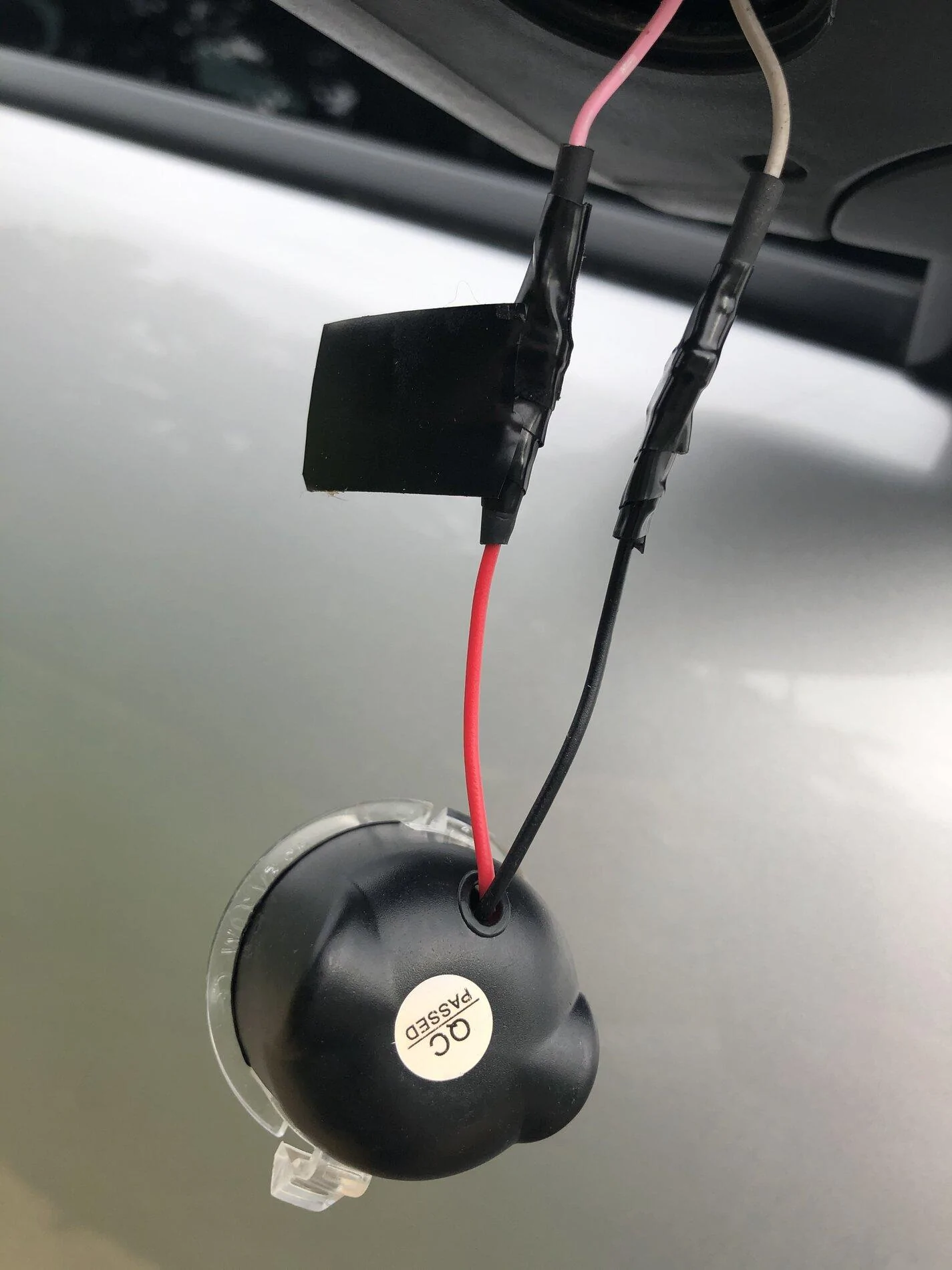

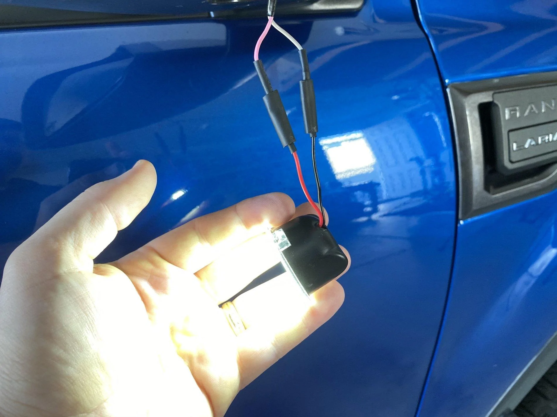

Both sides with heat shrink on, but not yet shrunk. Test the light to make sure it's wired correctly before you shrink the insulation:
Use a heat gun to shrink the insulation. Tuck the wires up into the body, snap the light back into place:

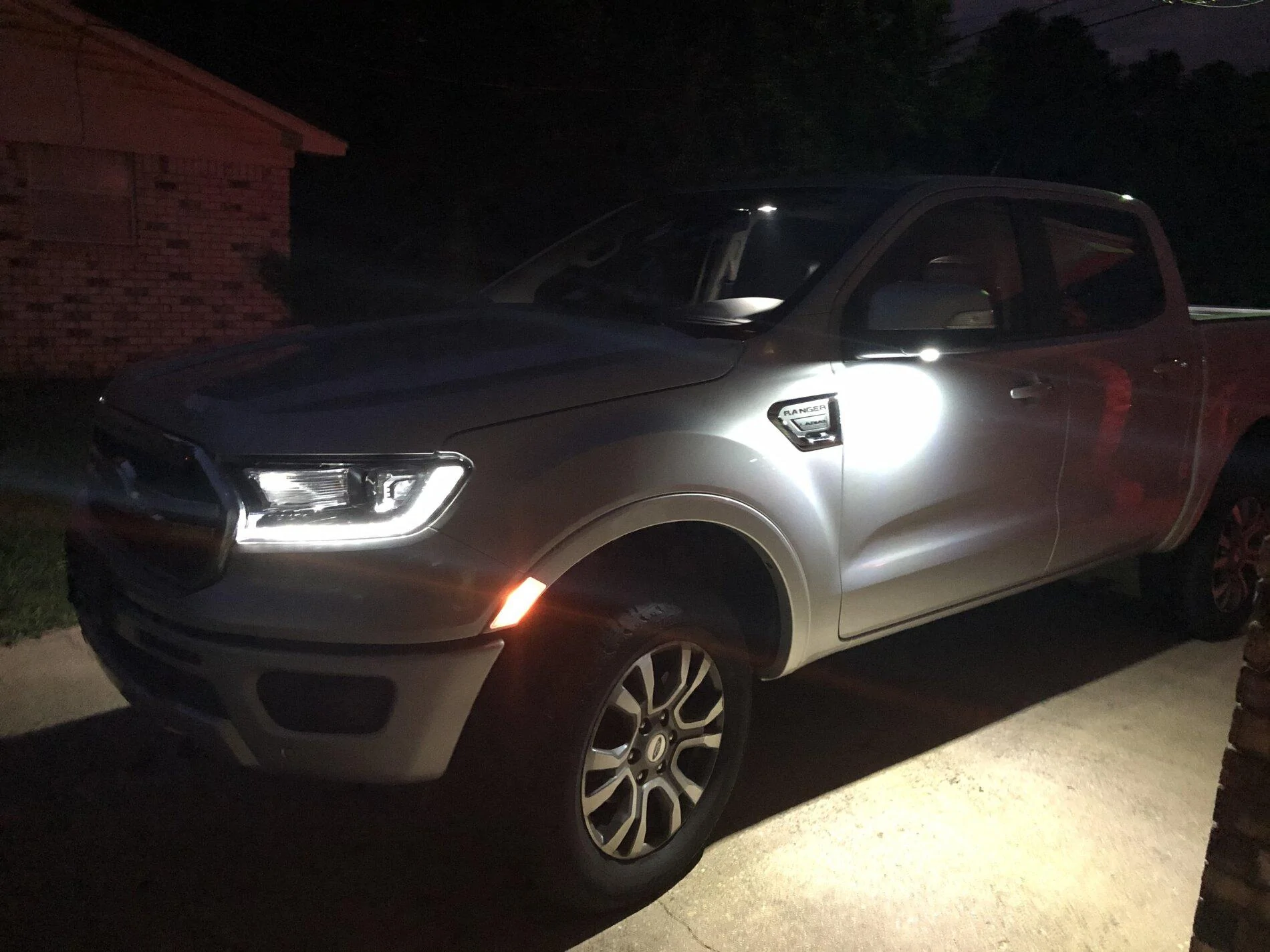

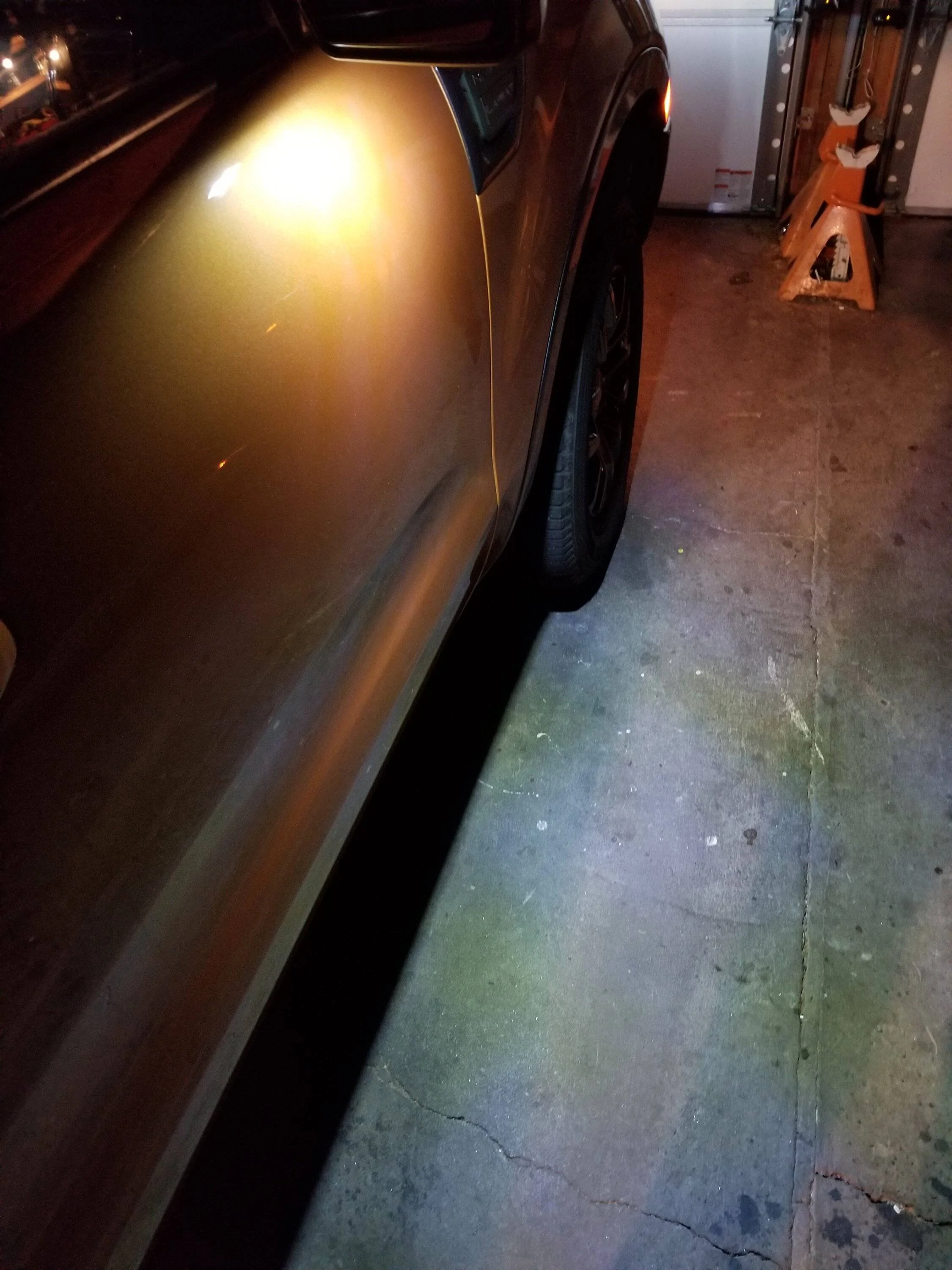

Installed them today, brighter and whiter light. Stock are kind of orange in the first pic.
