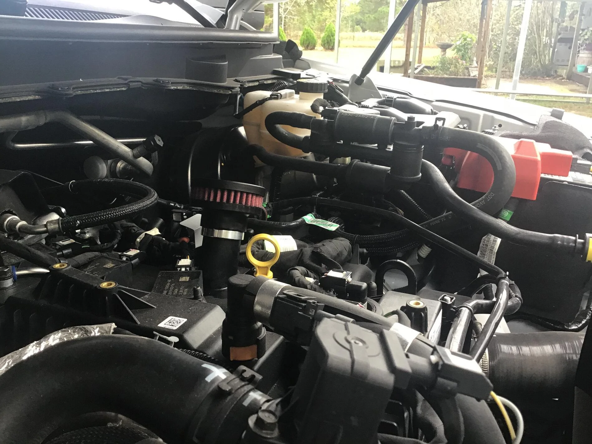

Under boost the valve closes.
CFM Performance valve cover breathers are the best money can buy and is the reason they have become extremely popular so quickly. They are so much more than a pretty filter on top of your valve cover and offer features that no other kits offer.
It is the only breather on the market which incorporates a check ball to keep unmetered air from coming through while the PCV system is active and the crankcase is under vacuum. In other words, this breather works just like a factory oil cap under normal driving conditions but will vent any positive crankcase pressure present under full or part throttle. It is also the only breather with an integrated baffle to help contain oil particles in the engine rather than allowing them to exit the valve cover and saturate the filter element. Filter tops are available in several popular powdercoat finishes, chrome, hydrocarbon and select OEM colors.
These breathers seem like an intriguing option, though I have to admit being completely naive about the potential effects. Can anybody come up with any possible detrimental effects (other than venting of fumes to the atmosphere) of using one? I don't typically push my truck very hard.
You probably will not have any need for it then, but honestly it cannot hurt. Maybe spend your money elsewhere though. As far as the "OMG! Unmetered air!" crowd... Ignore them, just ignore them.

I haven't had a chance to dig around in the engine bay yet and it's been a while since I've looked at the PCV operation, but does the PCV valve return crank gasses to the intake tract before the turbo or after the turbo?
In case the latter, I can see how the oil cap breather may be of value. Now that I'm thinking about it, I think that is how it works. I remember some of the higher hp speed3 guys were pushing their dipsticks out at higher boost levels.
