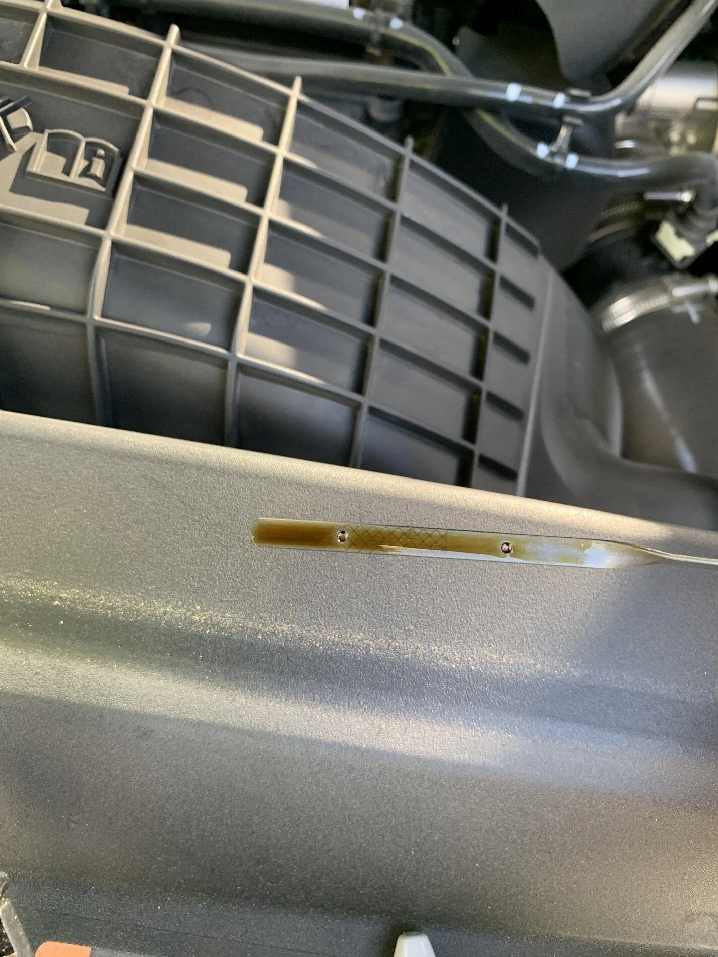

I've only had one oil change and paid the difference to switch to full synthetic. Been checking the dipstick evel every other week or so, but the thing that seems odd is how dark the oil looks. Just turned over 15,000 miles and my 80,000 mile Saturn or 70,000 mile Mitsubishi had cleaner oil between changes.

Mine was the same. Appeared to have lots of soot in the oil. I wonder if the soot is worse because of the 87 octane gas (running richer to avoid knocking)?
