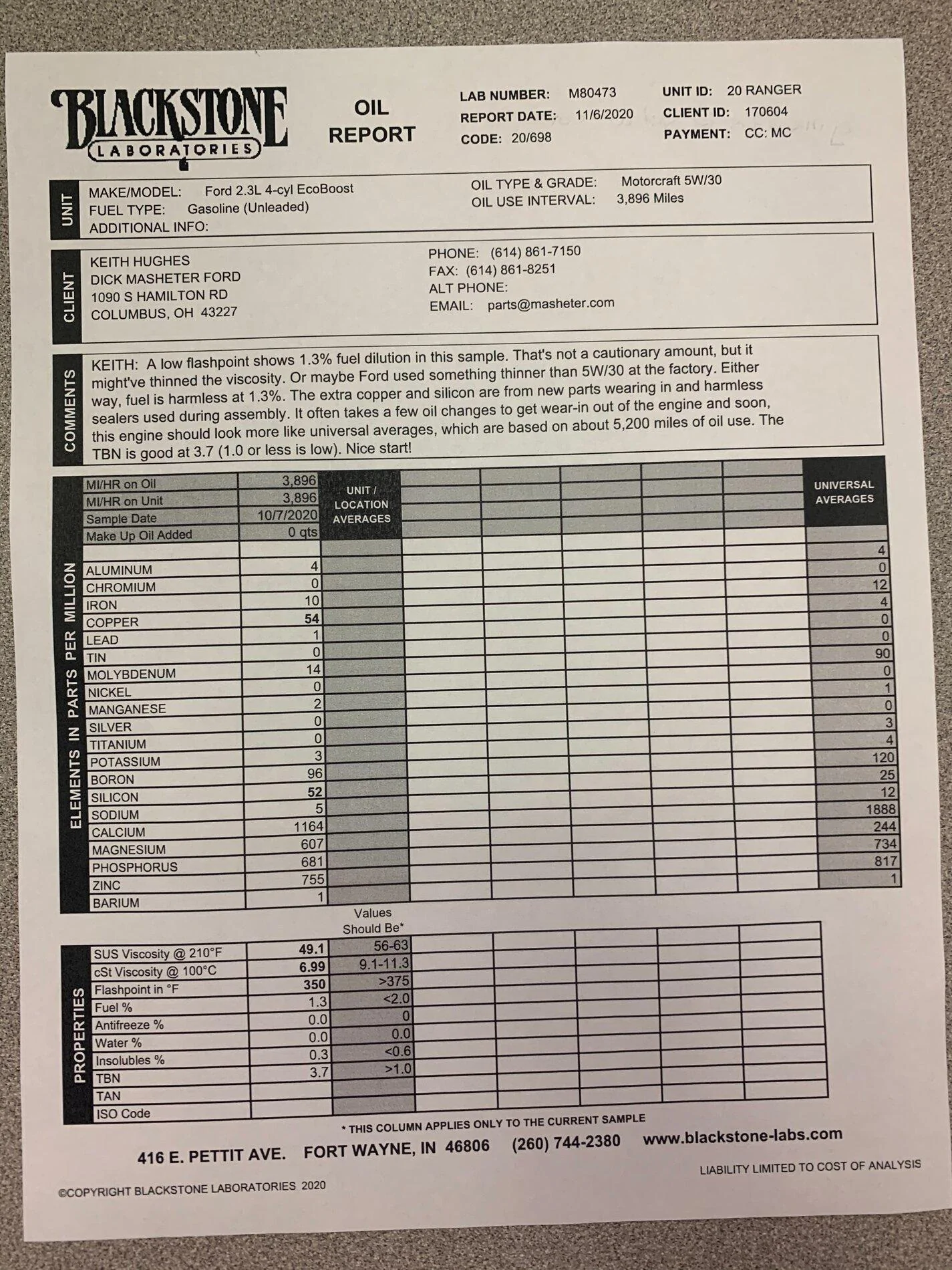

Just got my results that dealer sent to black stone. Any concerns feel free to respond.
Looks pretty good to my completely unqualified eye.
One odd observation though: your report says the flashpoint should be >375. I pulled up my first Blackstone report to compare numbers, and it says flashpoint should be >385. Looks back at other members' reports and they appear to be a mix of 375 and 385. That's a small variation for the folks who've had flashpoints measured <300, but it does add to my concern about how precise and reliable Blackstone's determination of % fuel is, since it's extrapolated from the drop in flashpoint.
