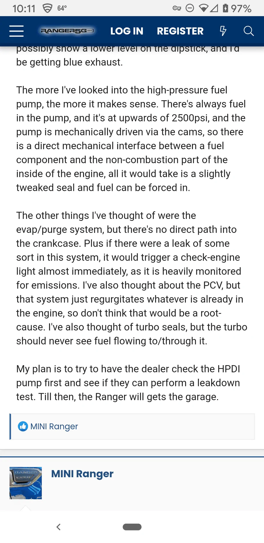

Don't know what happened with that post here is what I was trying to show and does the Mustang fuel pump work the same way?
