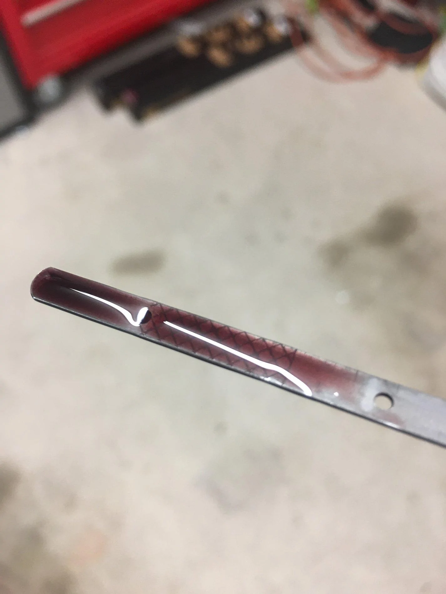

I just checked my oil. I’m 2,000 miles into this oil change With Amsoil and the oil level is between the dots but above the hash marks just a little bit.
What throws me off is how red/purple the oil looks. Almost like I changed it with royal purple?
Engine build date 06-AUG-19
That oil is a really odd color. Last time I saw that color I was looking at transmission fluid!
Well, I drive my truck home from the dealer and then back to the dealer (my parents live really close to them) and then home again. Next day, I went on that long (ish) drive. 30 minutes at highway speed, let it idle for 15 (picking up stuff from Grandma's) and then home. Left it until today (so it sat 2 days) and checked it again. Damn oil is back perfectly at the top of the hatch marks. Will have to monitor some more.
Thanks for reporting back! :clap:
What you are experiencing is the stock PCV system doing it's job.

Well, I have an appt. a week from Friday to have it looked at. When I changed it last Monday at just over 3000 miles on the oil and filter, I drained out over 7.5 qts. I changed it because it was way over on the level and smelled of gas. I added 6 qts exactly and it was just a hair above the hash marks. I have been checking it every morning, after it sits overnight, and recording the level with pictures. It has gone up every day and after only ~350 miles, the level is up to the top hole. I will probably have to do another oil change before my appt. that is 10 days out. I do not take short drives as I live in the sticks and have a 25mi, each way commute, to and from work, that is almost all highway. There is something definitely going on that only started recently. I am approaching 14,000 miles on the odo. and next week will be my 1 year anniversary for having the truck. Sucks, hopefully the dealer will take it seriously.
So... Is it just a shitty design? I've never experienced my oil level going up and down like that. I have another direct injection engine in the home fleet and it doesn't go up and down like that.

Good question. You would think Ford could answer it.
But since they seem unable, with as many folks here that are experiencing the problem I would think if you all did a comparison of driving habits, trip data over a period of time, etc. you could possibly drill down on what the issue is

Sounds like a plan. I guess I need to stick to the short trips for a bit and see if the level goes up. Maybe that longer trip fixed things. In the same breath, what's the consensus now on catch cans? I really don't like the idea of this crap ending up in the oil to hopefully be burnt off one day (if that is in fact what's happening). I'd gladly at it to the routine to drain the catch can if it means keeping the oil clean.
Whiskey Tango Foxtrot! Did you accidently grab a quart of Amsoil ATF by mistake during fillup?!

Does anyone know what the pressure of the fuel pump should be? According to my torque app, mine is varying between 2100 & 3600 psi. I've got less than 400 miles since my last oil change and have been checking the level every day. It has gone from the top of the hash marks to now above the top hole and smells of fuel. I have an appointment this coming Friday with the dealer. I will probably get the mustang out of hibernation since I am afraid of what damage I may be doing to the truck in the meantime.
For those interested, I just turned over 14,000 miles and have been running Mobil 1 since my first oil change at 4,000 miles. Almost all trips with the truck have been at least 25 miles one way and I never use the start/stop feature. Truck is stock and the fuel in oil problem only started within the last month. Drained well over 7.5 qts during the last oil change 2 weeks ago and the level on the dipstick is approaching similar height. Truck drives well and I have had no other issues. I am hoping the dealer doesn't brush me off as others have apparently been.
