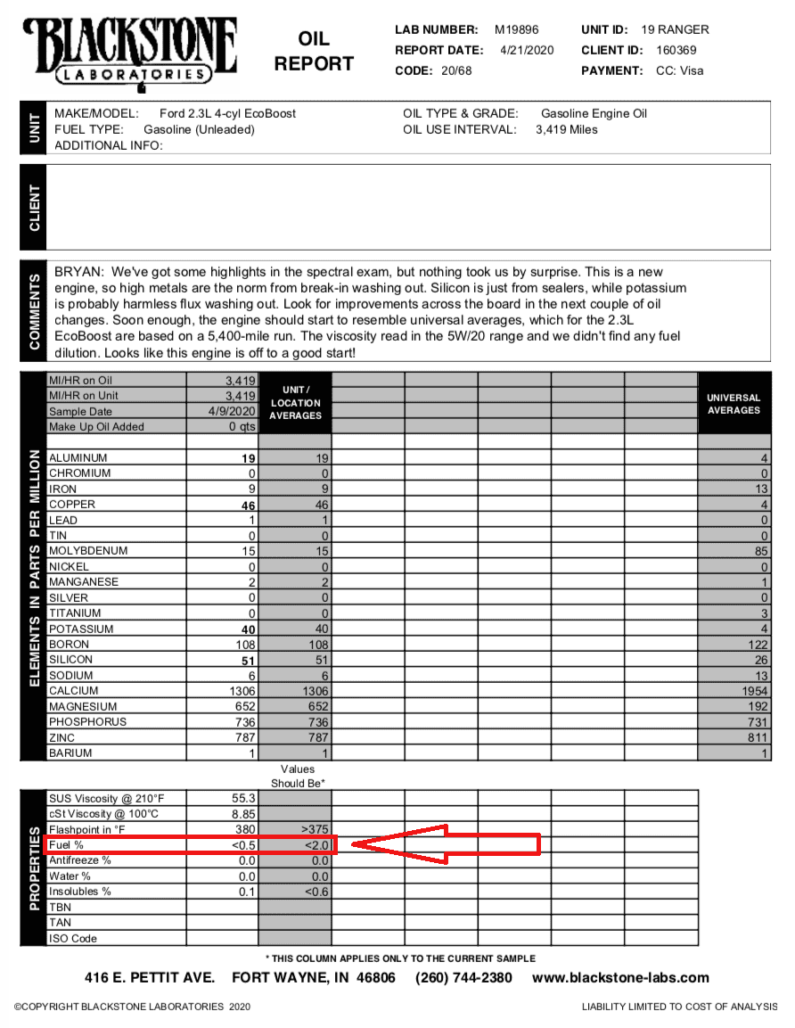

Just did my first oil change at 3419 miles. (My truck was built July 2019 FWIW)
I have attached the Blackstone Test Results below.
In the comments, they say: "nothing took us by surprise".
Perhaps someone else here at 5G has another opinion or a different interpretation of these results?
I should be doing my first change this weekend and sending off a sample to Blackstone. If my report looks like this, I'll be happy.
Looks good.. congrats!
Hey thanks John!
To all.... FWIW.... when I checked my oil several times after reading/following this thread, it did smell of gas. It wasn’t overwhelming, but I definitely smelled fuel. I am very happy with this report. However, I am going to send a sample with each/every oil change to document, and I will continue to follow this thread to help others if I can.
