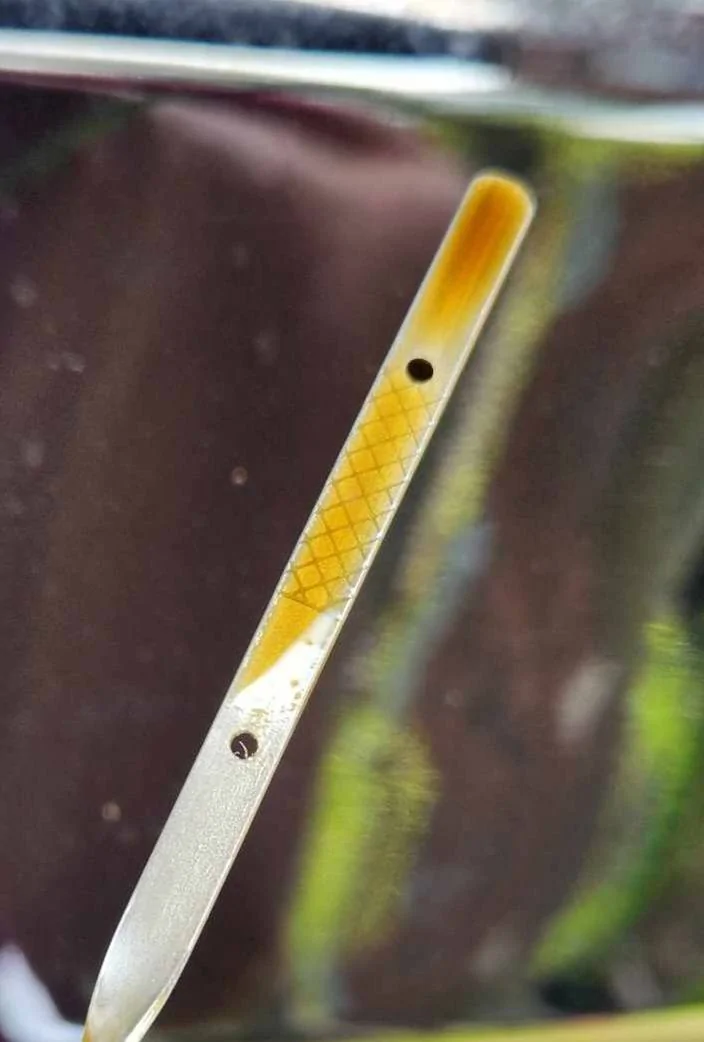

are not following the recommended way to check the oil
What IS the good way to check it? The oil is incredibly tricky to check on this vehicle -- every other vehicle i've checked oil on, has been simple. There seems to be a large margin of error on the 5g ranger, given how poor the checking can be (despite best efforts).
Agreed - 100% so;
Dead cold on this one. Reads the same as waiting 30+ minutes when hot. I tend to swap back and forth when I check to make sure I am not gaining fluid in the crankcase or dropping.
Book says to wait 15min but I've had mixed results with that. Checking at the gas station is just laughable at the mess on the stick.. but i also tend to fill up at half a tank.
Got that info from someone here. Owner of many ecoboosts. Don't remember the name. So stealing their method.

Thanks. Dead cold is still challenging for me; oil is smeared over a pretty wide area...
Wow. That is extra special for an already special engine when it comes to this issue.
Check when cold and on a flat surface. Pull the dip stick, wipe it clean, re-insert and pull again to check the level. Pull slowly and with purpose. I never check the oil if the truck has been running within the last couple of hours. I always check in the morning, usually every week or so.

After 5k miles. Same spot I left it on the last change.
So got lucky with that issue I guess.
Also a check at dead cold this morning. Yanked the stick, cleaned it, and got a good reading. Sucks for those that can't even check it cold.
Warm just after shut down..... it would somehow be up my arm for no logical reason.
