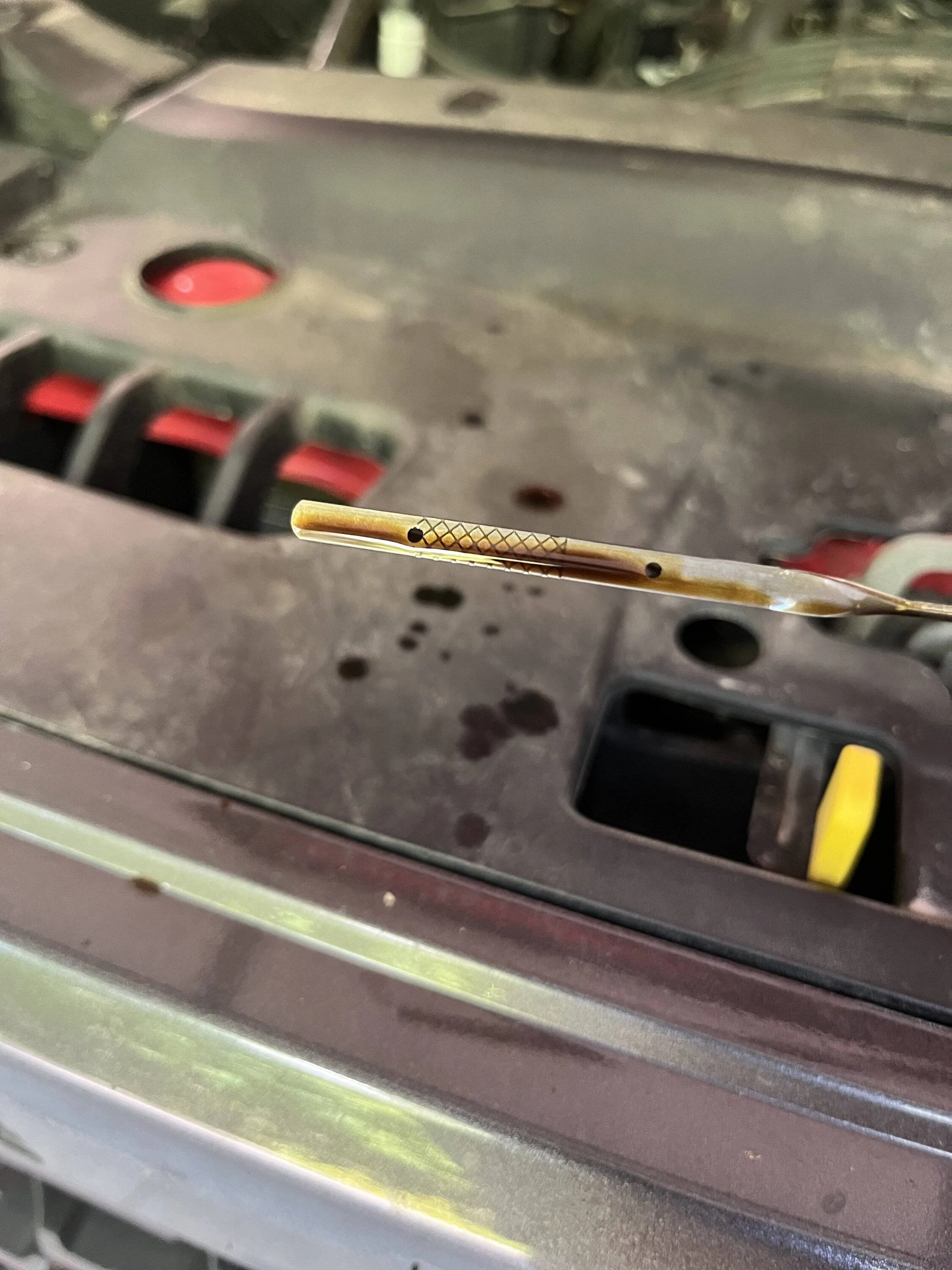

Just a small update. Taking a short road trip this weekend and since I was cleaning windshield and filling washer fluid I figured I’d check the oil. It’s slightly above maximum, not as bad in winter, but is definitely still overfull and the moment I went to wipe the dipstick I could smell the gas. I folllowed the recommended oil checking procedure in the manual before someone asks. At this point I just shook my head and closed the hood. I believe the fuel does not burn off like some had said here, or if it does, it is constantly leaking in. Ford is gonna have a hell of a repair bill eventually, especially since they are calling it normal.
On the bright side the Bosch envisions I installed this past December are doing awesome still! Also I forgot how easy the air filter is to check, only one hose clamp and three levers, not 6 or 7 screws like my old focus! What a love hate relationship.

Pull the dipstick clear with it pointing downward. if it appears hard to read then read the opposite side, it will often show better. only check the oil when cold and sitting on a level surface.
Common reasons for excess fuel in the oil that do not point to a defect.
1] Too many short trips of under 3-4 miles.
2] Failure to wait a few seconds after a cold start to engage the trans.
3] (most important) absolutely no hard acceleration until until the temperature gauge has at least moved up half way to warm, better fully warm.
These engines are designed to have a lot of ring clearance when cold and the fuel management likely runs rich prior to warm up (that's a double whammy)
