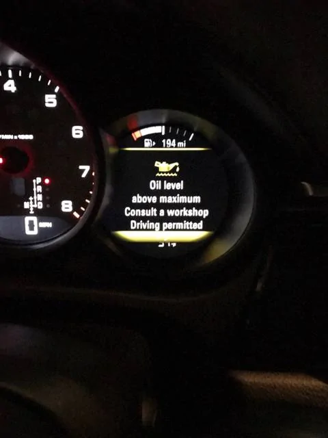

I just had my 2019 in for The Works plus an check engine light. I asked if Ford had changed its position on ignoring the rising oil on the dipstick. In 4,000 miles it had gone from the top of the hashmarks to above the round hole. The Ford service center's response was that there was not new guidance from Ford. Continue to ignore the issue is still the official Ford guidance to Ford service centers.
I was told that the only way Ford would know people are complaining is if there is a warranty claim. There can't be a warranty claim if Ford service centers are refusing - at Ford's direction - to even look into the issue. And if an engine blows up after 60k miles, there won't be a warranty claim.

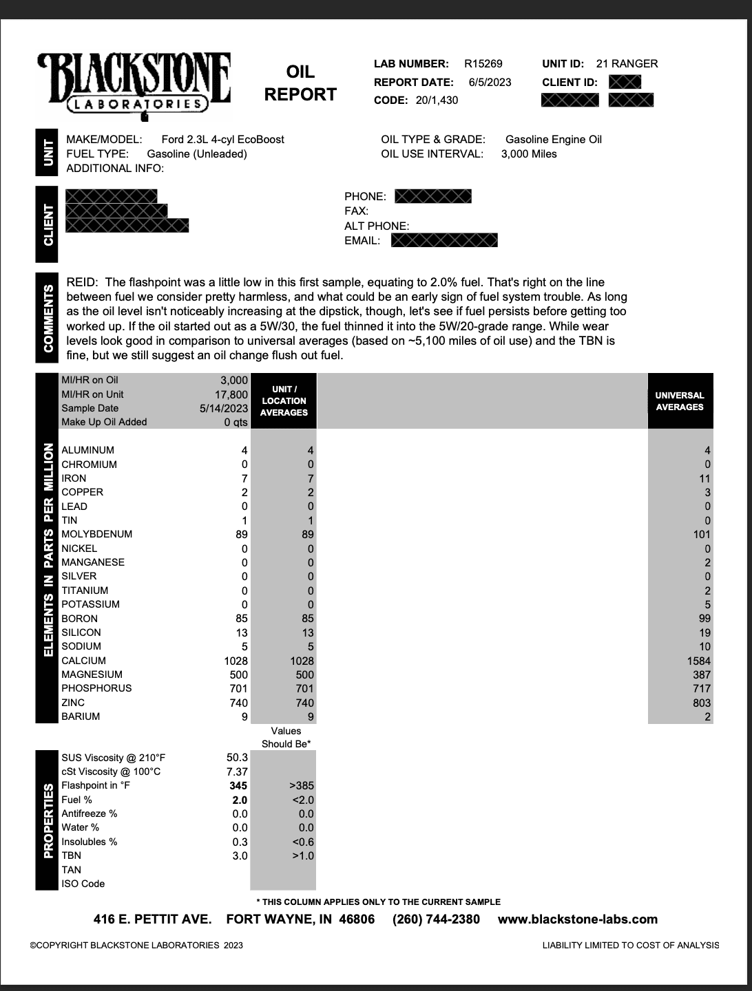

I did my first oil change since purchasing my truck, and sent a sample to Blackstone. According to the CarFax, the oil was changed by the selling dealer at 14,700 miles. I changed it at 17,800 miles, so about 3000 miles on the oil. I assume* that the dealer I bought it from used the default synthetic blend oil for the change. I put in Pennzoil Platinum 5w30 synthetic.
Blackstone Labs showed about 2% fuel dilution. Kind of disappointing, but not dangerous at this point.
The plus side: the vehicle was CPO ("Ford Gold") so has a long extended warranty (still under original factory warranty, and has another 3 years past that). Also the plus side: fuel injector replacement seems to fix this, and seems pretty cheap to do even if warranty for some reason didn't cover it.
To back up ccasanova22's thought: in the winter I did drive the truck short distances often in the cold. I might try and use it less this coming winter, and will pull some samples for Blackstone in the fall before the cold hits, and the winter when it's been cold a while.
When in doubt send a sample to Blackstone or another lab. My truck did smell slightly of fuel in the winter, nothing in the fall or spring or summer though. Kind of makes me wonder if something about parts contraction in extreme cold, lets fuel dribble out of the injectors while the truck is off, or something. In Iowa the winter pretty regularly sees below 0F/-20C temperatures. But yeah at least replacing them seems to fix the problem for others and isn't too bad to do.
