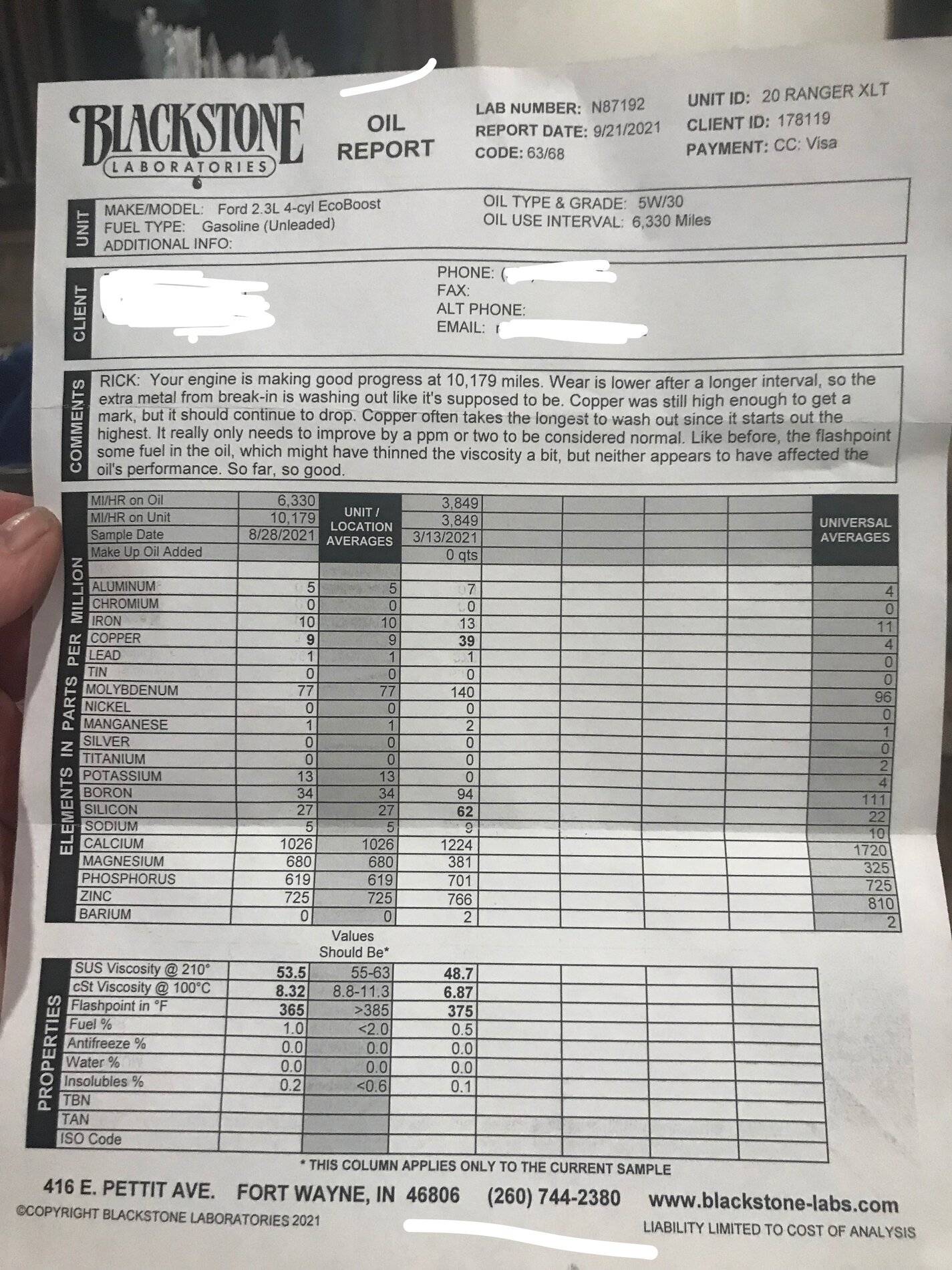

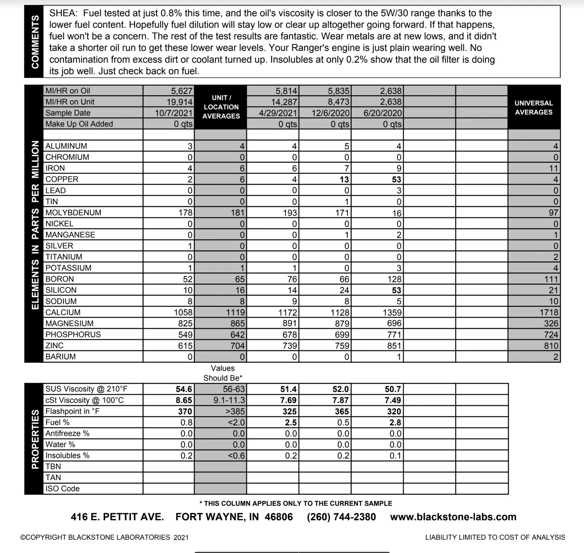

Send a sample to Blackstone and it will put your worries and dots/hashes to restso i have read 48 pages so far........ with that said, here is my story.
