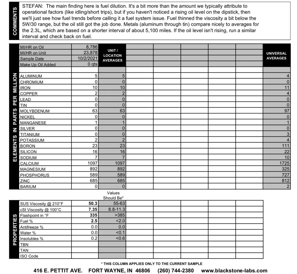

I have had two reports done. Thought I would post the results here. I am a little concerned but not alarmed at this point. I will probably use 5000 miles as my oil change interval.
I wouldn't worry about 3% my last one was 5%. You should be alright with a good synthetic!

Nice. My fuel dilution was in an OCI that spanned the winter. The Ranger can safely get 10k miles (OLM ran to 0% / change oil warning) on synthetic oil. My TBN was still 1.4 at 9k miles OCI (OLM 8%). You're spending the extra $50-$100 changing the oil twice as often for no return.

Maybe yes. Maybe no. But I am OK with it. Cheap insurance. :)

I'm with you Ave on the 5,000 mile oil change. I always changed every 3,000 when I used conventional, I figured to cover the additional cost of synthetic 2,000 more miles would do it and also give me piece of mind. Cheep insurance!

Read a couple good articles that stated modern day synthetics can handle up to 4% fuel dilution. It also stated it was in their tests , although it did stand up to it they said it was not recommended. Legal line to cover their ass!

I think there is validity in that thinking. That is why I am going with the 5000 mile interval. I will continue to use full synthetic. I drive 8,000/10,000 miles per year so a couple hundred bucks a year is no biggie. My dilution level should be under 3% at all times. Probably less since there was 7,000 miles on the oil in my last test.

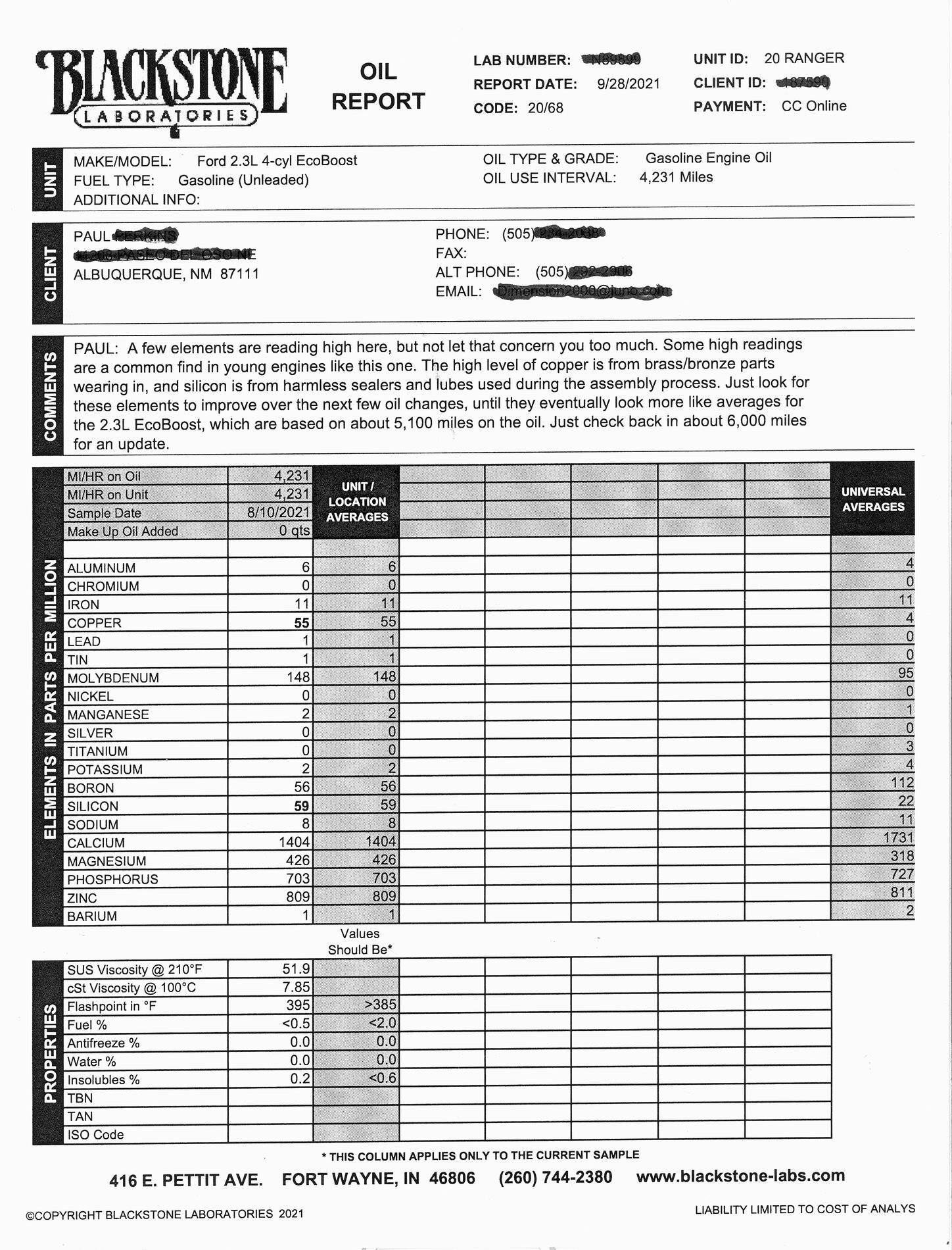

Hi Doc,
Did you have your oil analysed by Blackstone? I sent a sample to them of my 1st oil change and waiting for the results.

I took my oil sample physically to the Post Office on 09/02/21 and got a receipt. I placed a tracer on it with USPS on 09/09/21 and they didn't follow up on it. Called them Friday and they didn't know where the item is and said to wait a few more days. Called Blackstone and they said that the samples take longer than normal mail to arrive because they are oil and USPS processes them differently than normal mail. Its been 17 days since mailing it.
Have any of you had this kind of delay on your samples?
Checked the tracking status this morning and still no update as to it's location (other than it is still in transit) since it left my Post Office:
