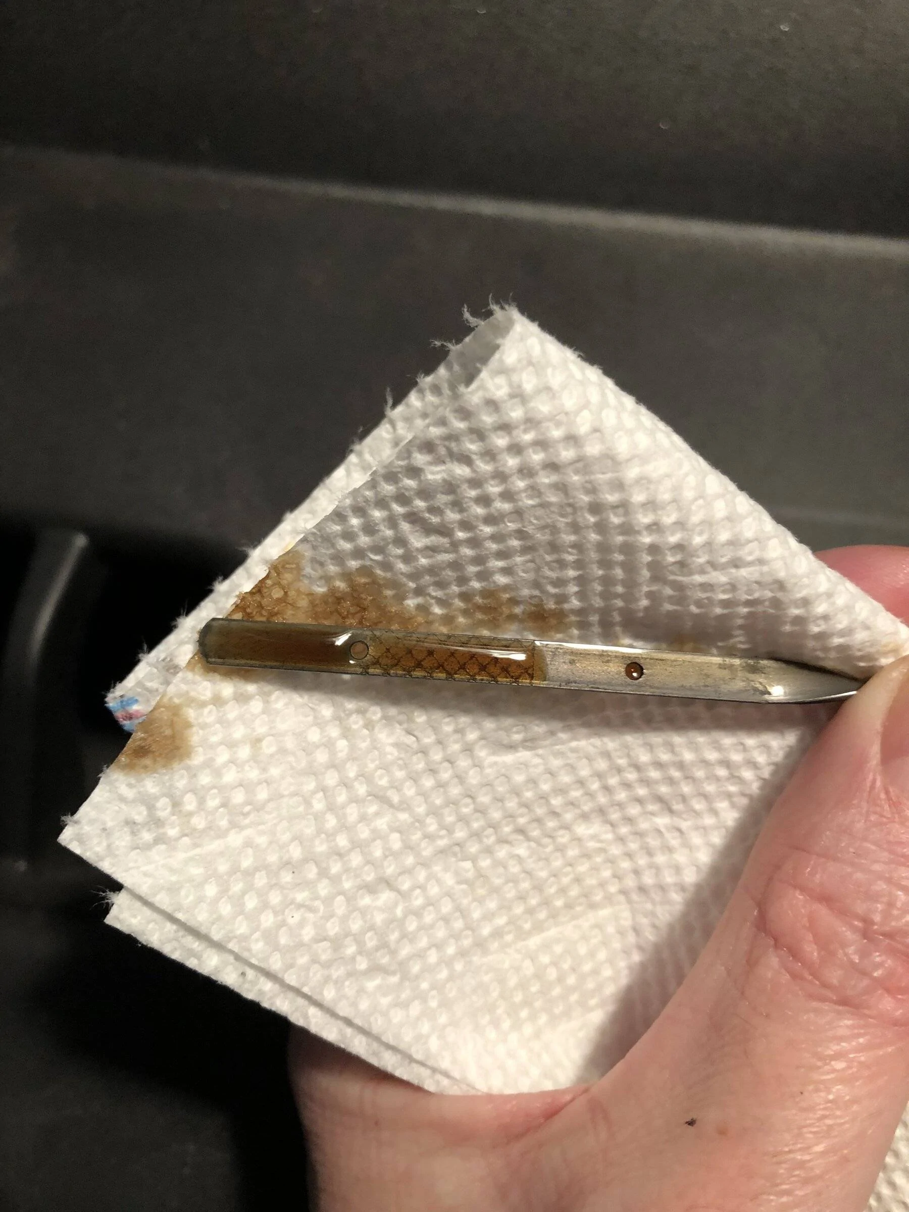

Here’s mine with 10,200 miles on the truck and about 2,200 on this oil change. I don’t daily drive my truck. I drive on weekends, an hour and a half to my cabin, short trips while I’m there, and an hour and a half back. I drive 90% in D, locking out gears when needed and occasionally use S or tow/haul. I generally drive with a light foot and average 22 mpg combined.

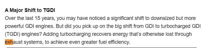

taken from an article posted by Porpoise Hork
Out with the Old: New Oil for New Engines | MOTOR
the exhaust angle is intersting, now forgive me guys, I havent made thru all 137+ pages yet,
also, So far I'm thinking Amsoil is looking better everyday.
