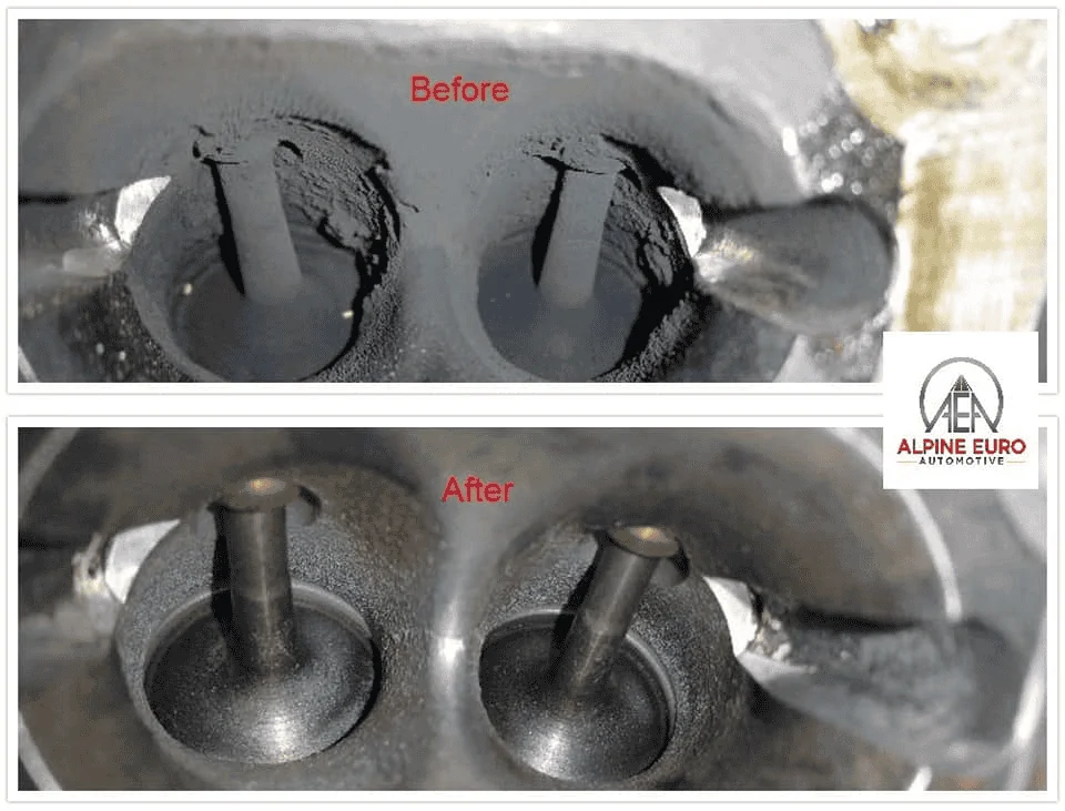

Here's a good video showing how dirty the valves in the Ecoboost get after just 44,000 miles. This is the same 2.3 we have in our Rangers. This is a reasonably priced ($500) DIY system for those who want to attempt this but also a good reminder that this should be done by a pro at some point.
Before:
Ford-EcoBoost-engine-carbon-buildup-Ford-Tech-Makuloco-video-screenshot-001-dirty-intake-valve.jpg
After:
Ford-EcoBoost-engine-carbon-buildup-Ford-Tech-Makuloco-video-screenshot-002-clean-intake-valve.jpg
You can also do this without the machine by hand with a pick and brush.
Looking back at this with my photos. That looks a bit worst than mine at 36k so it seems like the Ranger falls in line with other ecoboosts. ofc a lot of same engines in the line up but good to know.

A heads up, a lot of is wet/sludge like. This is more than likely oil/vapors. Carbon build up would look drier like this. I think a catch can is worth it for the sludge like material. Ofc, this is more than likely a mixture of both but still. Eliminating sludge seems to be worth it.
