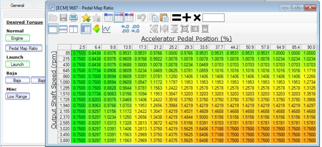

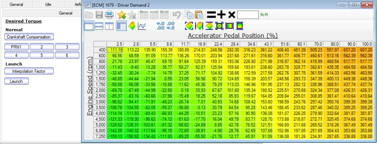

Rather than use a Driver Demanded Torque setup that is varied by gear like the Focus RS uses, the Ranger uses a different strategy that is based on modifying the Driver Demanded Torque value based on the Pedal % and the corresponding Output Shaft Speed of the transmission. This is a multiplier that is factored on top of the Driver Demanded Torque table to offset that value either positively or negatively.
The Ranger's table is not as cut and dry as the one in the manual transmission equipped Focus RS. The Ranger has the disadvantage of having a sort of convoluted calculation seeing as how different speeds across different gears can be equal to the exact same Output Shaft Speed. The OSS is not always equal to a specific RPM in a specific gear like you would get with the Gear-based torque tables in the Focus RS.
One way you could eliminate the confusion of this table would be to set all of the values to 1.00 in the Ranger table so that you would command only what was in your Driver Demand table. I would only recommend doing this if you are struggling with inconsistencies in boost targets between gears, and are trying to make sense of the Driver Demanded Torque relative to your RPM only without the added factor of the transmission's Output Shaft Speed coming into play.
What we can infer from reading the Ranger's stock PEDAL MAP RATIO table is that at lower driveshaft speeds the amount of torque commanded from the ECU is reduced by as much as 25%. This is no doubt a way of reducing drivetrain stress during launches, but it can also be a source of hesitation off the line if you are trying to floor it from a stop or from slow speeds. Additionally the multiplication factor in the bottom right part of the MAP would be adding to demanded torque at higher speeds, and could be a source of unintended overboosting (followed by subsequent part throttle closures).

FORD RANGER OUTPUT SHAFT SPEED FACTOR TABLE:

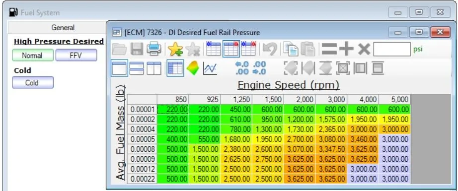

The stock Fuel Rail Pressure (created by the High Pressure Fuel Pump) has an intentional taper at higher load and higher RPM. This is fine due to the stock Driver Demand Torque table having a similar taper in commanded power output too. But if you plan to add more power at higher RPMs you should consider increasing the values in the bottom right of the table to something that maintains the peak Fuel Rail Pressure.
By increasing the duty cycle of pump at higher loads and higher RPMs will likely increase the wear and tear on the High Pressure Fuel Pump over the long run, but it is a necessary evil if you want to make power up top. The stock pump is definitely capable of maintaining the 3625psi of Fuel Rail Pressure well above 5,000 RPMs.
By increasing the Fuel Rail Pressure you can effectively reduce the relative Injector Duty Cycle at that RPM, which allows you to deliver more Fuel Mass in the short period of time that we have for an Injector Window with the Direct Injection system.
Stock Ranger Fuel Rail Pressure table:

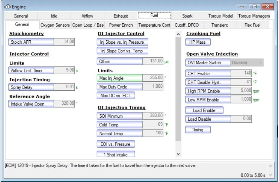

Other types of Fuel Tables that you can modify in order to squeeze more fuel delivery out of the stock fuel pump and stock fuel injectors are the following:
MAX INJ ANGLE: This is the Maximum Degrees of Crank Rotation that the Injector can spray. Increase this value at your own risk, but doing so can allow for more fuel mass delivered between start of injection and the spark event. This is essentially the INJECTOR WINDOW.
MAX DUTY CYCLE: I commonly leave this alone, but some people swear by increasing this to 1.100 or essentially 110% Duty Cycle.
MAX DC VS ECT: This table is set to 0.95 across the board, so this is holding back 5% of the injectors maximum fuel flow. When looking for extra flow, keep in mind that you can easily increase this number up to 1.00 if you need the additional flow, even without adjusting any of the other Injector Angle settings. This may be your Go-To table first before messing with changing your Injector Window as this just changes your effective Flow Rate Maximum.
SOI MINIMUM: This is the Minimum Crank Degrees that the Start of Injection can begin. If you lower this value you can increase your available injector window as well, but again you do so at your own risk.
Generally if you are on stock turbo, with just gasoline as your fuel you should not have a need to adjust these values. The need arises to modify these when you run a fuel that is high in Ethanol Content at high airflow levels, or strictly when you are running a bigger turbo that flows enough air to demand higher levels of fuel than you can deliver at your desired Fuel Rail Pressure. If you feel that you may be demanding a lot of fuel, be sure to keep an eye on Fuel Rail Pressure, as a sudden drop in that can create massive spikes in Injector Duty Cycle and create a Lean event.
