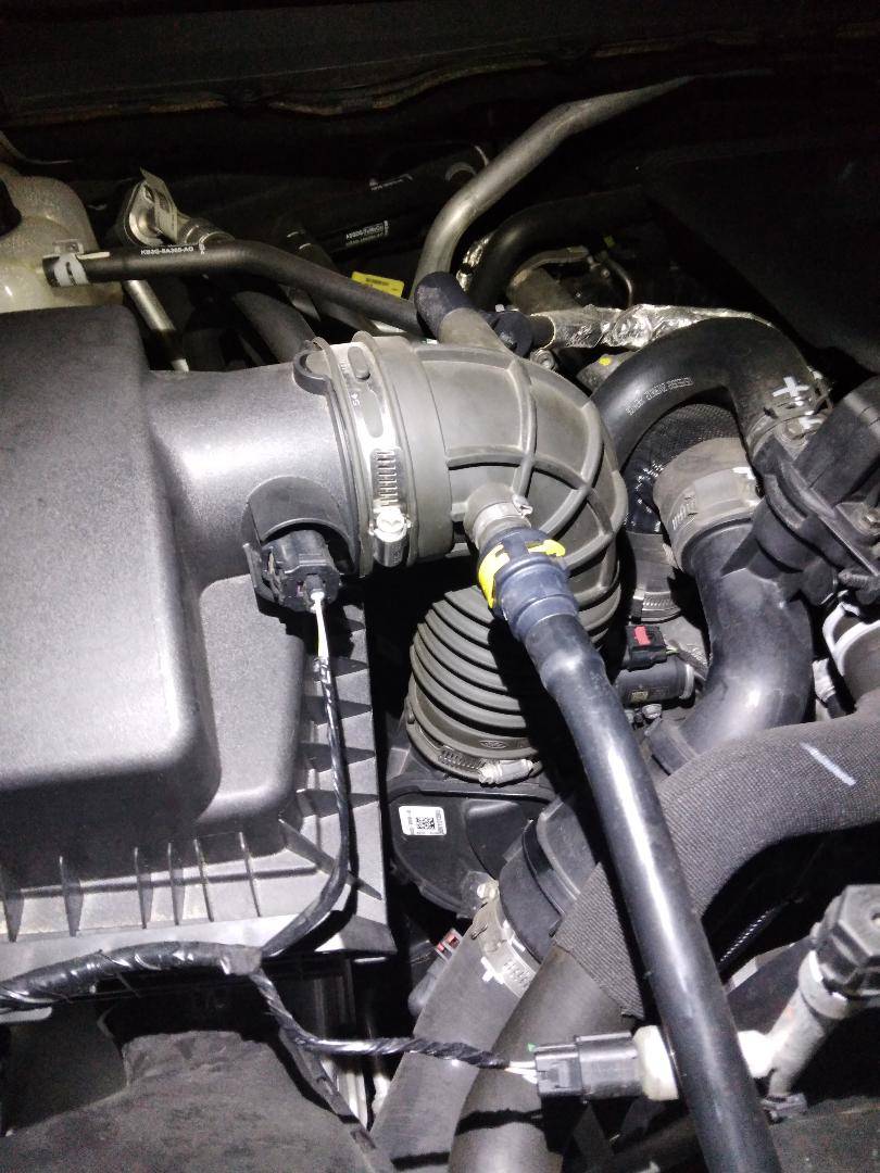

Yes I see that now,thanks I was looking at this (pic below) and thinking that small black box with the little sticker was the TB cause it’s fed right from the airbox, so that means the TB doesn’t get any air directly from airbox ?? it goes thru and fed by the turbo?? Like I said above not familiar with all the extra hardware.

That is correct. Air enters through the airbox, is compressed by the turbo, and sent through the intercooler prior to entering the throttle body on the other side of the engine.
