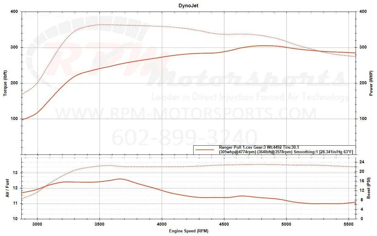

Tune is feeling pretty solid so far. Holds boost really nicely, and turbo is making good Airflow numbers. I have the transmission scheduled to shift at about 5,950 RPM currently, which feels a little early, but it seems to ride the powerband nicely. Did a pull to test out it's wheel output, but I think I started at too high of an RPM to capture the peak torque. It didn't have enough time to hit full boost before 3,000 rpm on this pull to give me a higher torque number. I hit target PSI closer to 3,600 on this pull.
Wheel output for this run is 305hp/364tq. I’d be able to hit a higher peak torque output if I had started my run about 500rpm sooner. I’ll be making some revisions over the next couple days anyhow and then jump back on for some more pulls. I should have started around 2,500rpm instead of 3,000rpm.
Interesting to see how the wheel numbers correlate to the ECU's calculated Brake Torque. The ECU calculates 415 torque @ 3,424rpm on this pull, and 331 horsepower at 5,384 rpm.
I am targeting a PSI of around 23 (it's not exact since you command psi by demanding a torque output, but I have massaged my Demand tables to float around the 23psi range. I have it set to partially close the throttle if I go over 24psi as a safety measure. As you can see, the turbo holds airflow nicely in the RPM range that I am using. I should extend the RPM range back out to the ~6750 range I previously had it set at and see how power holds at the higher range.

Ecu ? Thats not what the Dyno says...looks like about 364 torque..and the a/f is not linear...

I was providing some data from the ECU so you guys could see what the ECU is calculating relative to the wheel output. Yes it was 364 at the wheels, ECU calculates 415.
The AFR is pretty linear. The scale of the graph is 10-13, on your graph yours is scaled 10-18 so yours looks flatter, but it’s not as flat as it looks at first.
I have my fuel targets set to richen up at the higher rpm, and am hitting my targets. I don’t have my targets set to a flat/constant value.

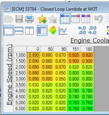

Here is the current WOT Lambda table, showing the target enrichment:
I will probably lean it out up top, and at least pull it back to 0.78 from 5,000+ if not go for 0.800 all together. The Wheel HP drops down a little bit when the enrichment fattens up, which could either just be coincidental, or indicative of the AFR. We will see.

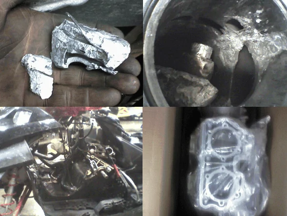

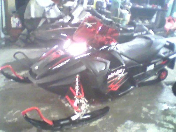

Ahh I see. I do a lot opf turbo tuning on snowmobiles and I like to stick around 11.7:1 and 12:1 max. I could take it further but that way it's safe and really it's not a big difference in power running a few points leaner. If its my own sled that I'm racing short distances I lean it out further but for customers they might be doing miles wide open down lakes so I like to keep those a bit rich. Also the software I use if it goes leaner than i like or the engine gets too hot I can just pull timing.
You never know what customers are going to do I once had a guy drill out his nitrous nozzles because he felt a 70hp shot wasn't enough. obviously he didn't change fuel and it was a catastrophe. I have pics somewhere of the result I'll see if i can find them.
Yeah, “customers” are a vehicle’s worst nightmare. You spend enough times in car groups and you’ll see people posting videos of their engine smoking and they’re just sitting there filming it and redlining it over and over as if one time they are going to floor it and all the problems are just going to go away.
I have even had old dudes with manual transmissions come back later and tell me how they loved the boost in their car and how they did some long road trip and never took it out of 6th gear......and you’re just wondering if these old dudes have ever heard of engine load before.
