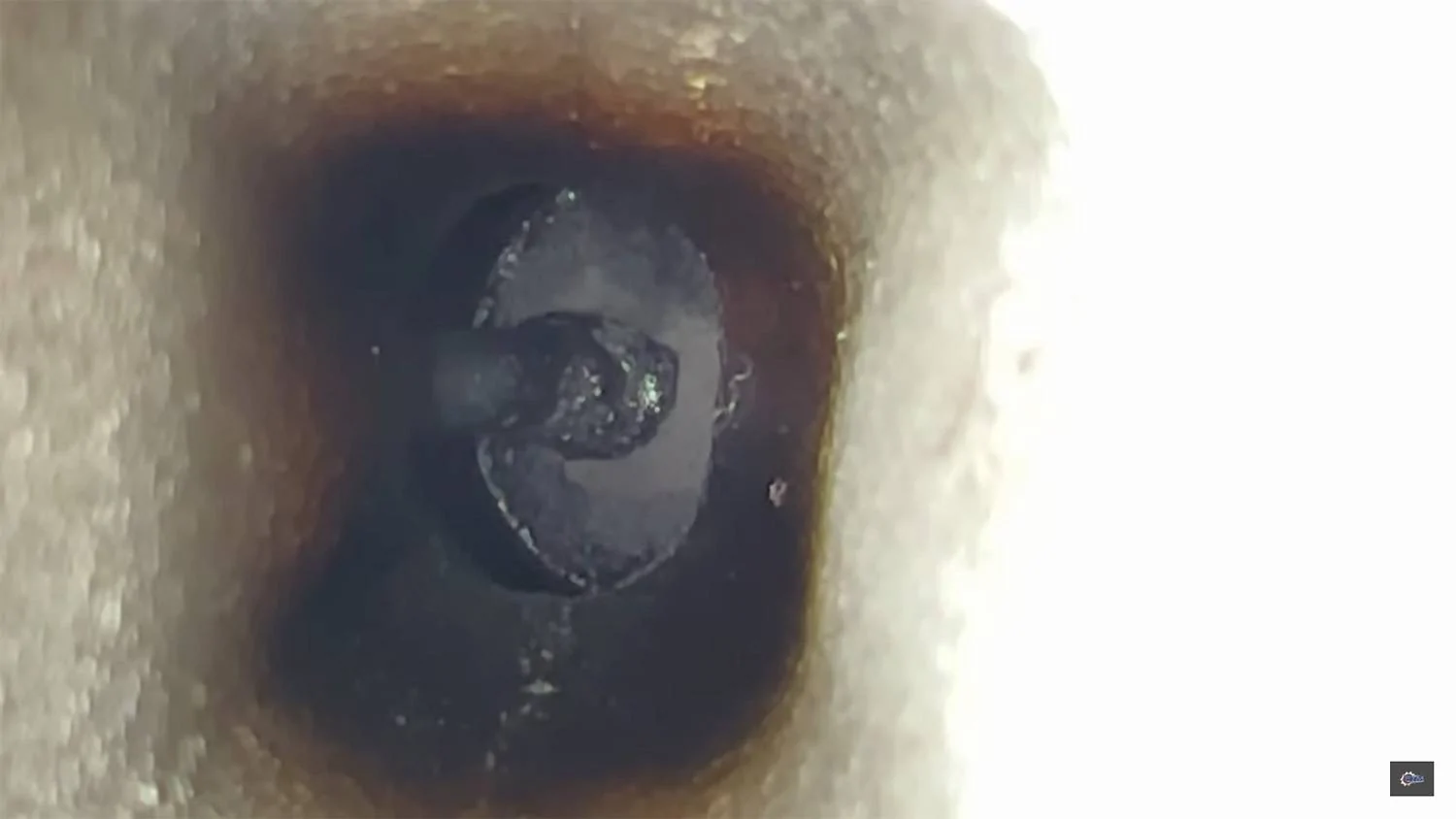

Here's a good video showing how dirty the valves in the Ecoboost get after just 44,000 miles. This is the same 2.3 we have in our Rangers. This is a reasonably priced ($500) DIY system for those who want to attempt this but also a good reminder that this should be done by a pro at some point.
Before:
Ford-EcoBoost-engine-carbon-buildup-Ford-Tech-Makuloco-video-screenshot-001-dirty-intake-valve.webp

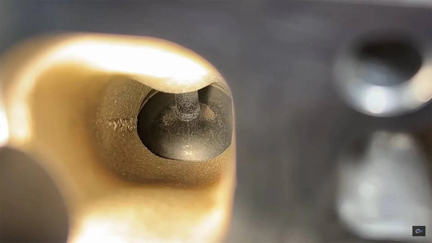

After:
Ford-EcoBoost-engine-carbon-buildup-Ford-Tech-Makuloco-video-screenshot-002-clean-intake-valve.webp

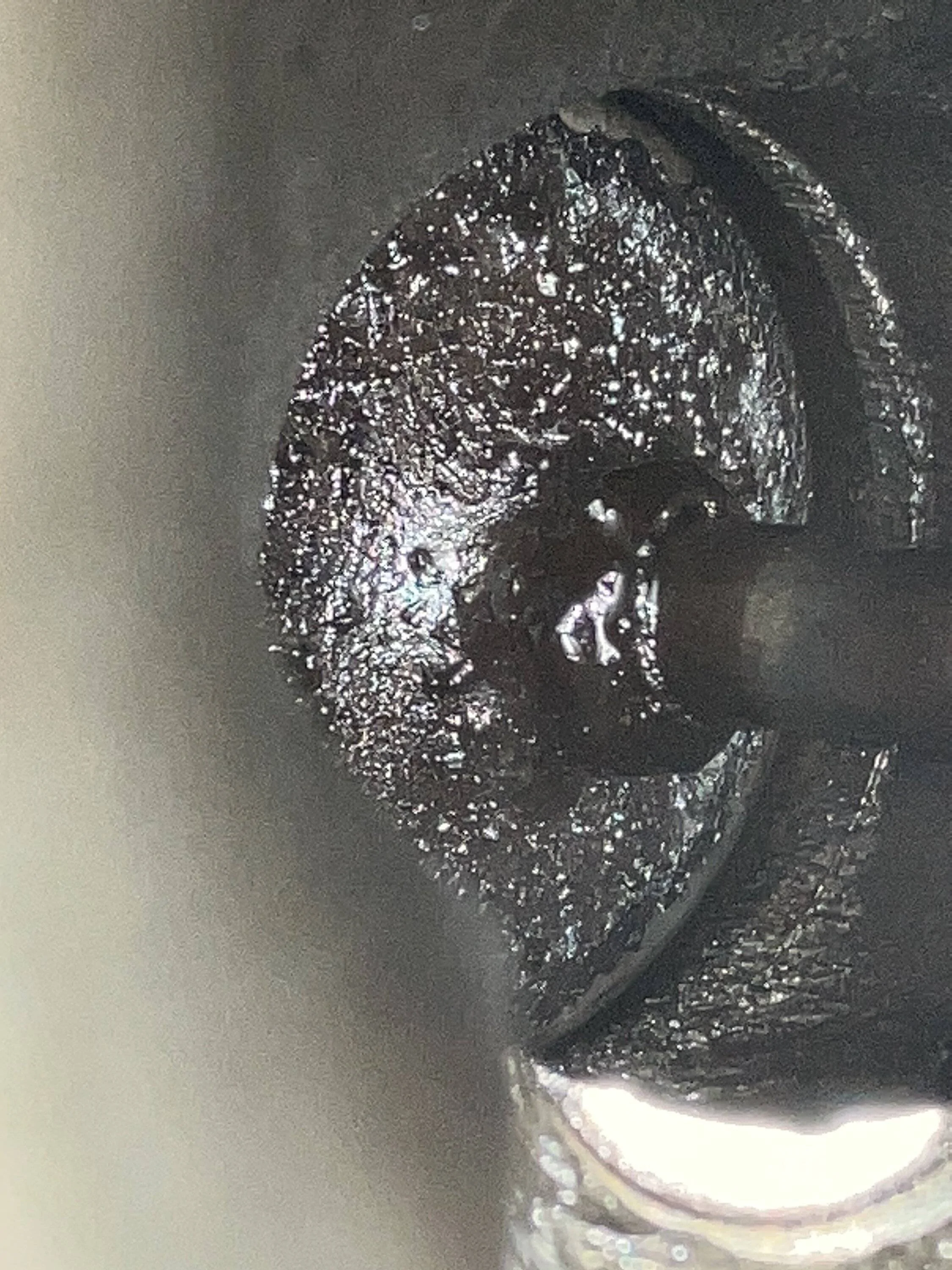

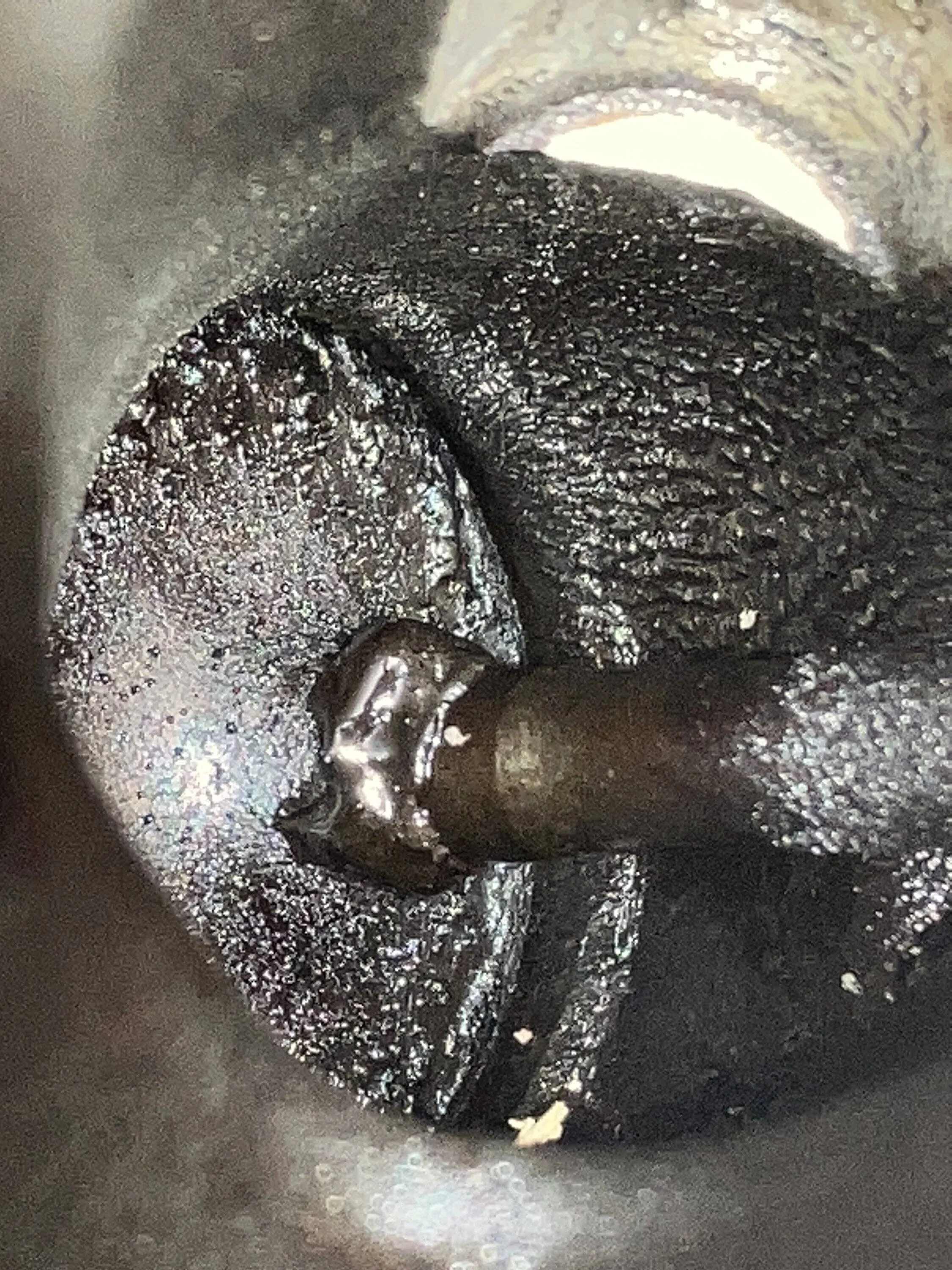

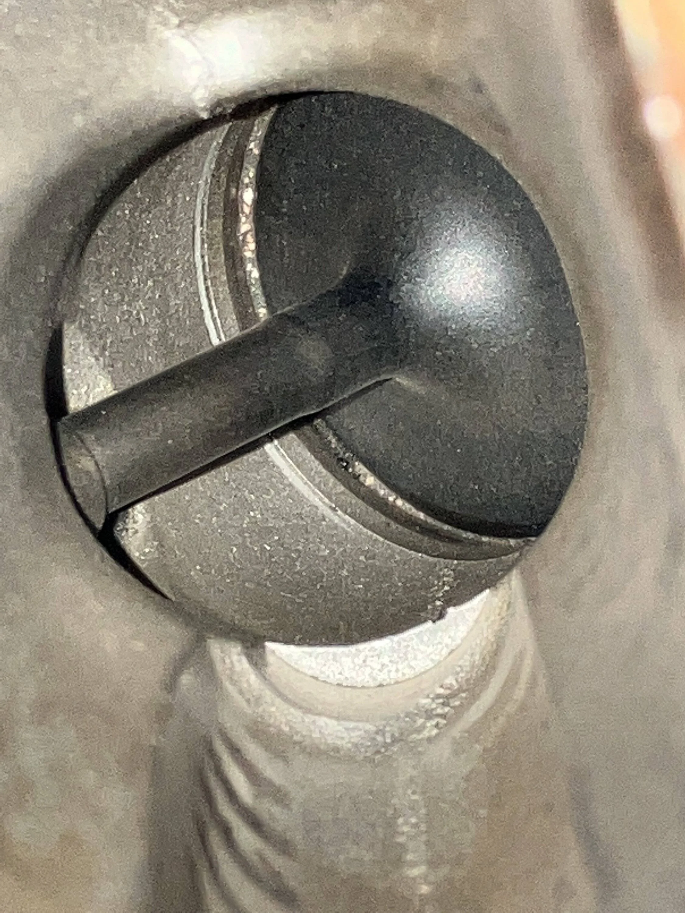

Oh boy do I have some great additional data for 36k miles. So as I read earlier, the italian tune up does nothing for our engines. I can confirm, I WOT quite often and this is what it looks like. I will be doing it every 25-30k miles now.
137,224
