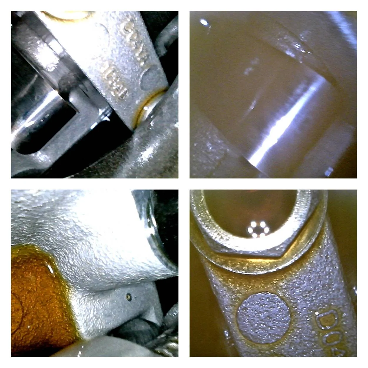

Ford began installing oil separators on the 2.3 Eco a while back and do appear to work very well. Most of what the catch cans collect is a watery fuel mix from the PCV blow-by with very little oil. I'm at 10K miles on mine and ran a bore scope up into the intake and looked at the valves and was surprised at how clean they were. There was virtually no deposits at all on the valves and running a cleaning agent like Seafoam or Techron cleaner would certainly keep them that way. Based on that installing a catch can is likely not to make much of an improvement.
I think you're 100% on point with this logic. I just bought a boroscope, but I'm having trouble figuring out where to access the intake valves without having to remove the entire manifold? So far I've only been able to check cam lobes through the oil filler. ? That's Pennzoil ultra platinum after 800 miles, BTW.
Did you ever figure where to get the borescope into the intake to see the valves?
To see the top of the intake valves, you go... through the intake.
