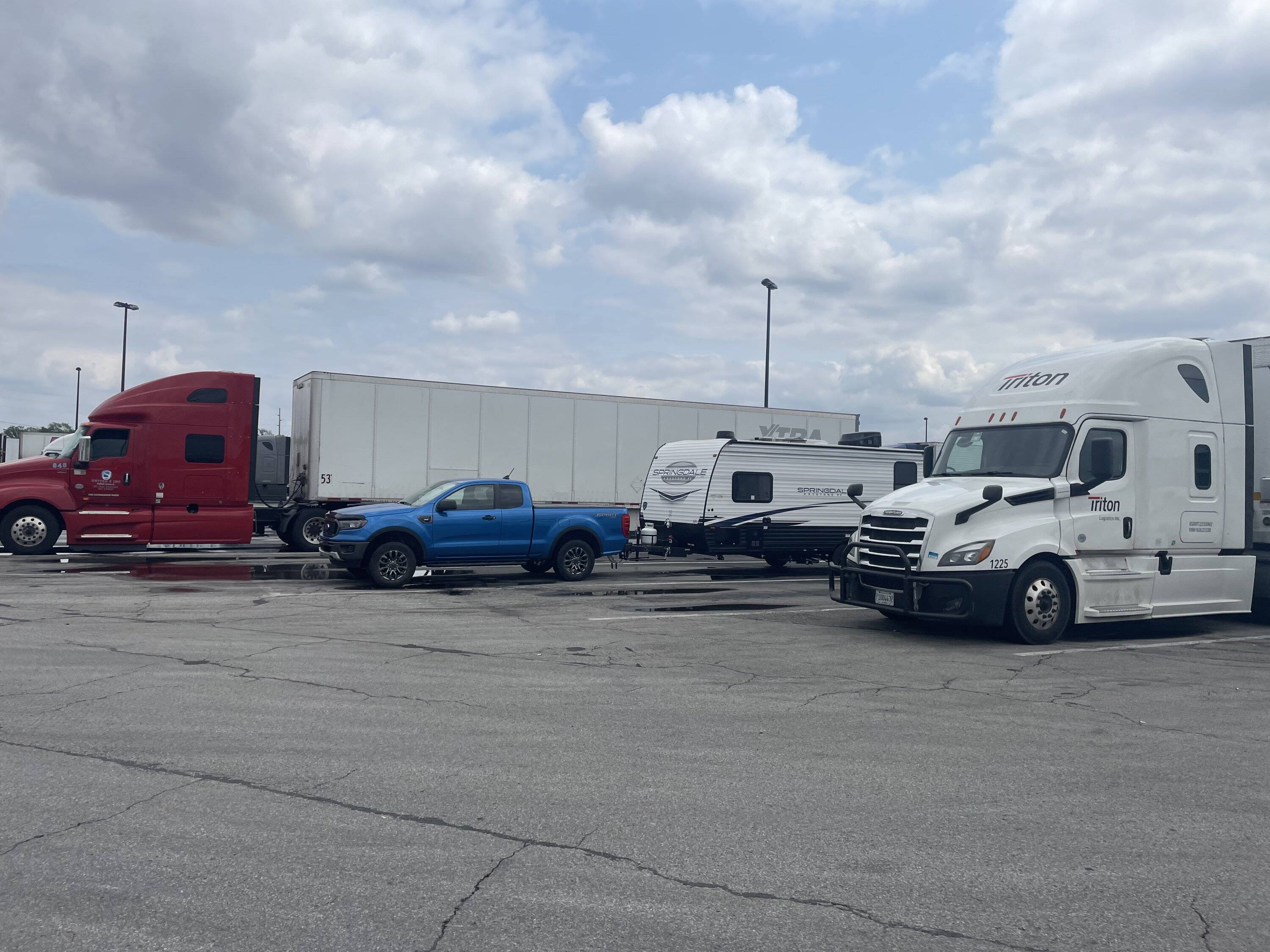

So I did mine yesterday over lunch. Under an hour (but I have torn apart the interior previously so familiar with the panels). I also have a scab so popped two tabs on the back of the headliner but otherwise was fairly non invasive. I’ve yet to test it (will this weekend). I thought about just pulling the brake light from the bcm, but just did it the ford way to be safe.
if a dealer on a scab is taking more than an hour something has gone wrong.
One confirmation for the masters - the ford module ignores the smaller 2 bundled wires, correct? The instructions make no mention (nor do the components have missing connections). Appreciate the confirmation here. If those do need to be soldered, I’ll give half an hour back to the dealer estimate.
edit: towing pic as an offering to solicit a response.
