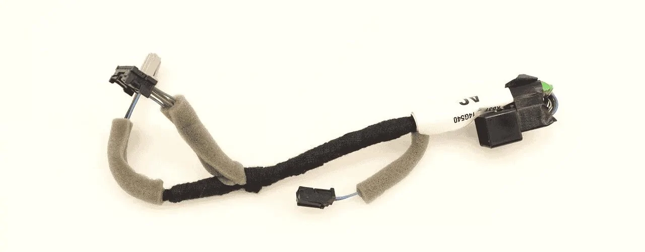

The above IS for the (Rear View Mirror) it taps off of the wire harness that is factory installed, under the cover.
Now if you do not have the (Auto-Dim) mirror then you will need a factory harness to get the (Auto-Dim-Connector) to give a connector for the Dongar to tap off from.
So you replace the current harness (if you do NOT have - Auto-Dim mirror with one of the ones below - then add the Dongar (T-Harness to power the dash cam.
The Factory Harness Part Numbers are as follows:
But this Part Number - If NO RAIN SENSE is Installed. KB3Z-14A411-C

This Part Number (If Rain Sense is Installed) KB3Z-14A411-D

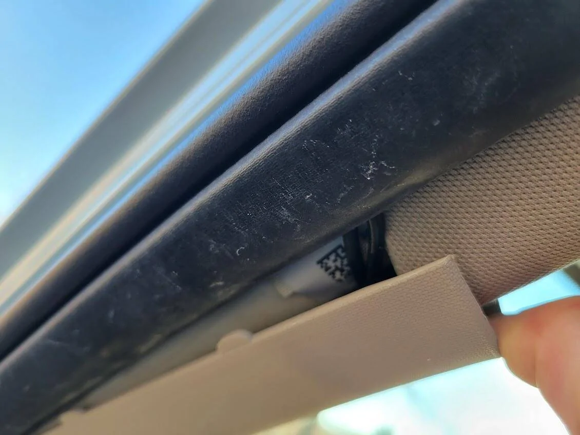

I just watched a compelling video illustrating the potential danger of routing a dash cam cable across the a-pillar. If the ranger airbag runs down the length of the a-pillar, and you simply stuff the wire into the seam between the pillar cover and ceiling panel, you are placing the cable right across the airbag.
Is this a concern on the Ranger? You might be able to reroute the cable behind the airbag, but you will need to pull away the pillar cover and you are risking exposure to the actual airbag.
Thoughts?

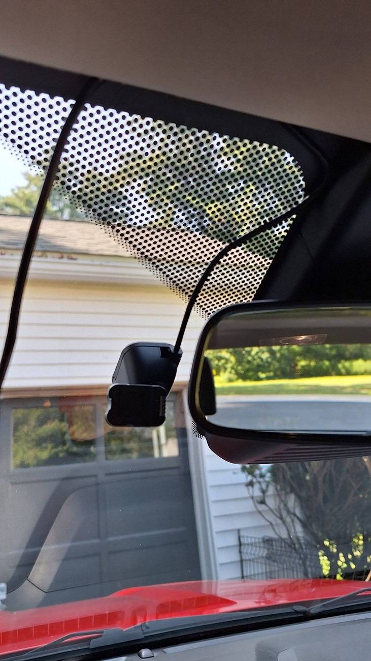

I ran mine there with some slack and I believe it's okay. I did not pull off the trim, just pushed the wire gently in with a small trim tool.
The wire just sits inside the location you mention and the across at the very top, I doubt the air bag goes into the headliner.
However, I imagine that the wire would blow out if the air bag went off and, if tangled, the dashcam wire runs loosely in the headliner to the cam. That wire would easily pull out if it was pulled taut by the bag (it sometimes droops out and is lightly tucked in).
Additionally, the rear cam wire also runs up the A-pillar.

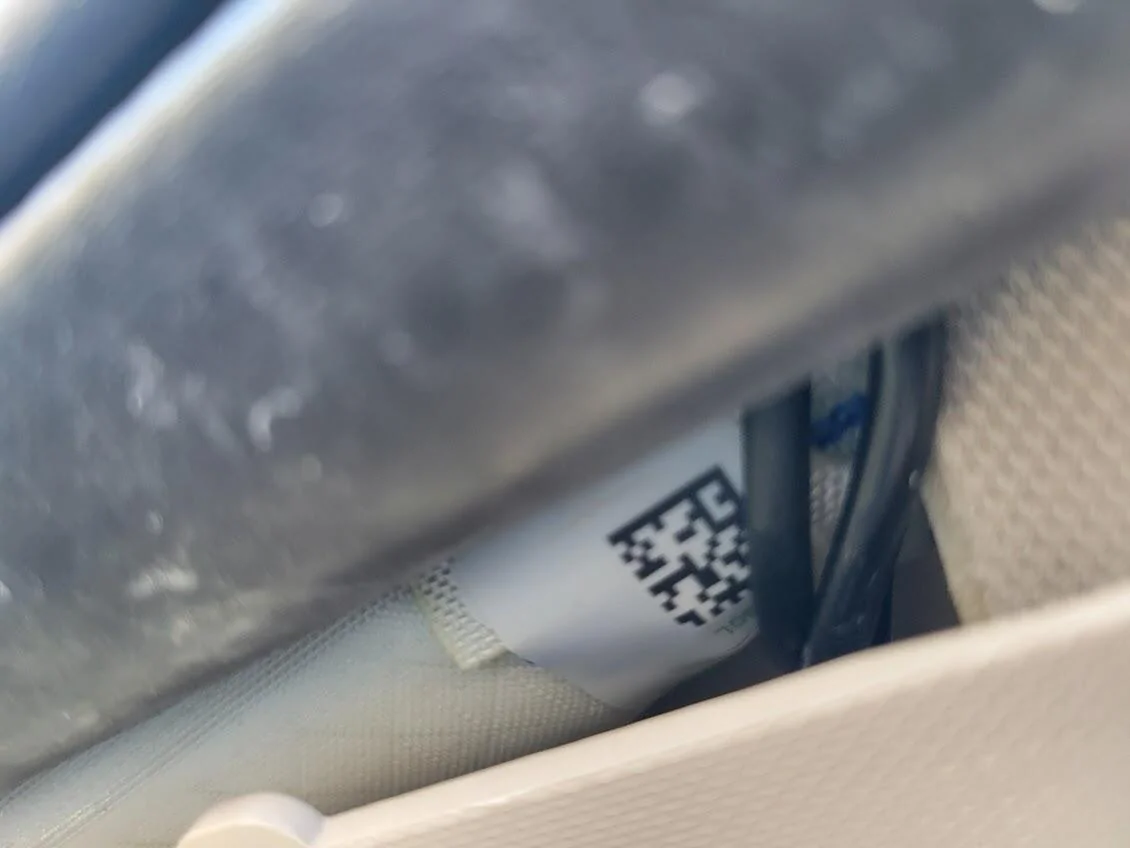

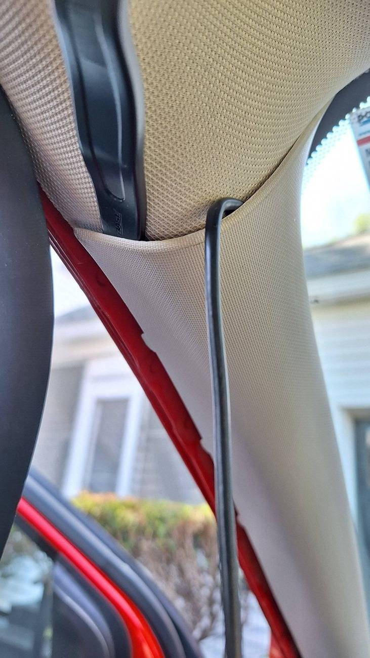

Ok, I ran the additional cable for the OBDII power adapter across the A-pillar in addition to the rear cam cable. Looks like I am catching the very upper portion of the air bag. So hopefully, like others have said, the deploying bag will just blow past the cam cables and not limit bag deployment to any degree.
That looks great and I doubt it'll ever be an issue.

The best practice when routing wires and cables around the Curtain Airbags is to route it to the side or behind. If that requires temporarily removing the curtain airbag, then do so. Just make sure the Battery has been disconnected and the key turned to the on position so you can drain all the power from the SRS

I'll be finding out if the Ranger is any different than my last cars in this regard, but I've rolled a car with wiring around the A-pillar bags... nbd. Best to run them behind the bags and tying knots is right out.

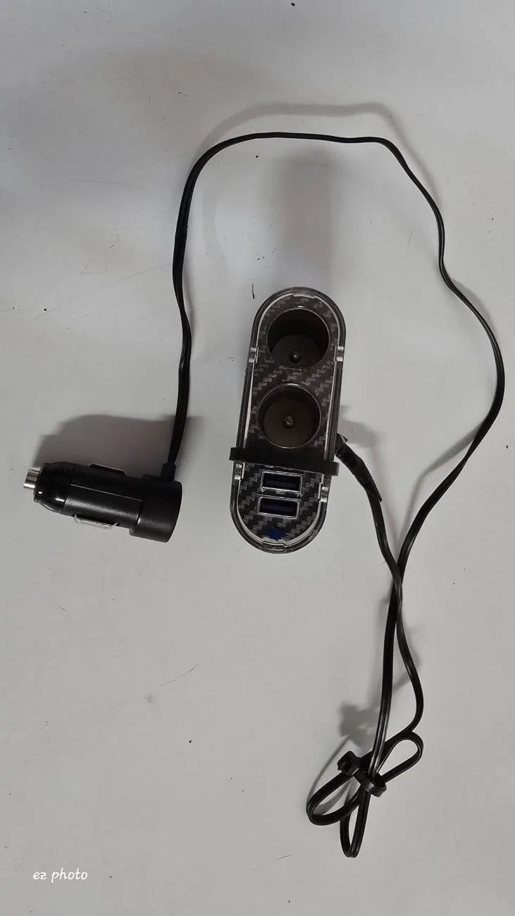

I routed my wire behind the airbag. I took off the trim, be careful it has a plastic holding it to the frame, and never had an issue. As long as the wire is behind the airbag not in front. The option to wire with the aftermarket product is good too. Having an issue with where to plug things on my 6g. Wireless android helps.
I had this plug in, plugged into the driver side cigarette lighter, and had a dash cam and flashlight plugged into it. Zip tied it under the steering wheel panel next to a brake controller module

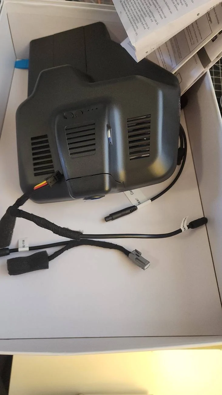

I am about to install my fitcamx today. Looks like a super easy install as it comes with connectors to power it from either the auto dim mirror or rain sensors. I like how it's molded into the factory style plastic cover and no running wires.

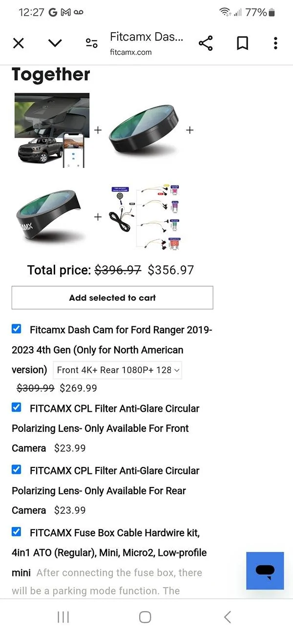

Thinking of pulling the trigger on this Dashcam.
How do you like it, Review? If you don't mind.
This is one of those gadgets that I do not really need or want BUT would be nice to have and with this unit being (Factory Fit-Look) is pushing me to want it.
