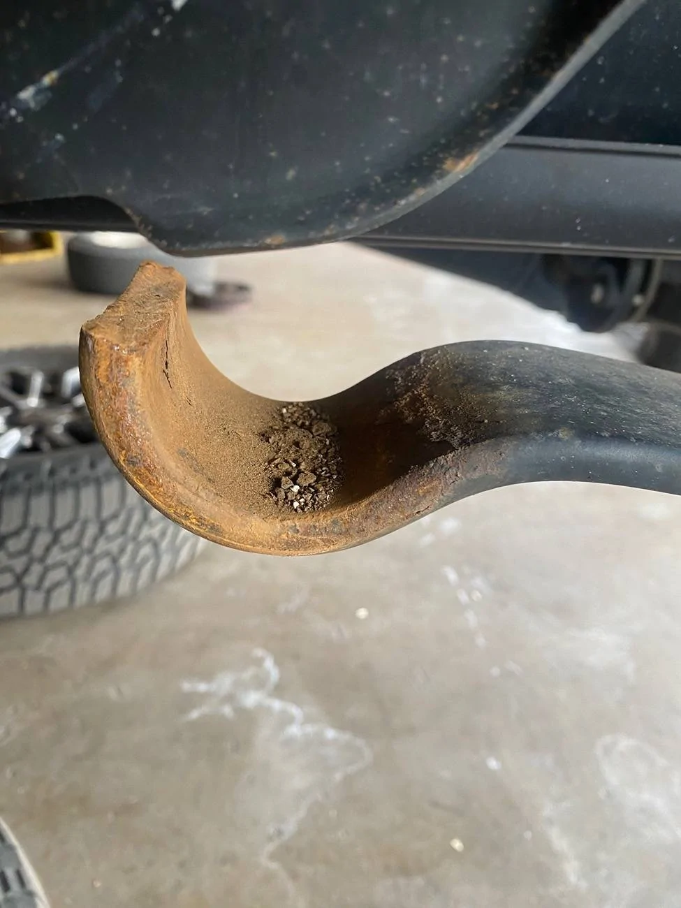

Ford is not going to replace them so I am going to do it myself. I’m going with the icon. This is sad because it’s for sure a defect but because it’s outside of warranty they won’t replace it.

Today I was getting oil change/transmission fluid exchange and got a call letting me know the eye socket broke clean through like the others have posted in this thread. I have a 19 XLT that is at 60000 miles. Dealer quoted 1700 to replace both.

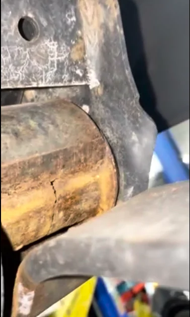

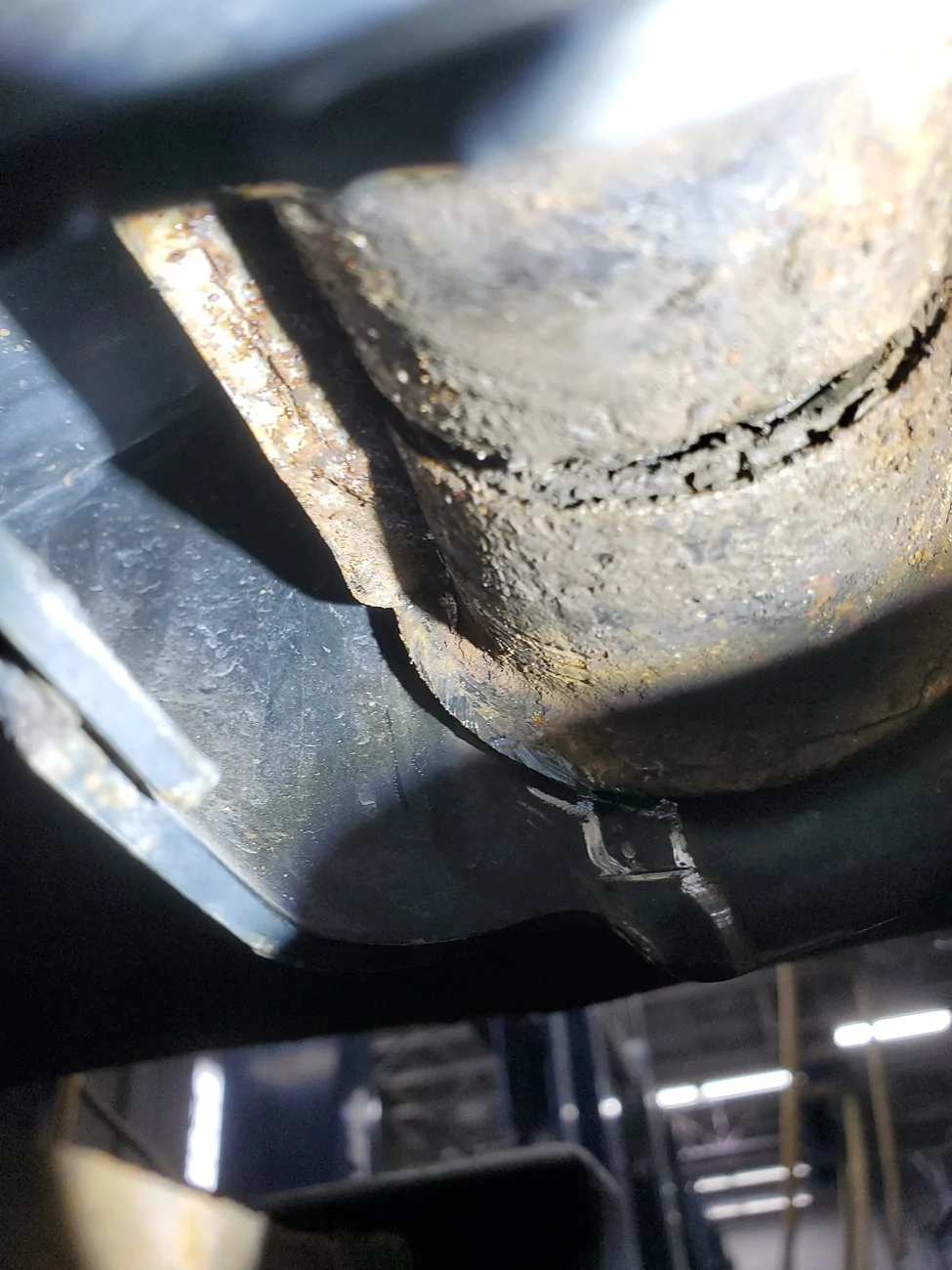

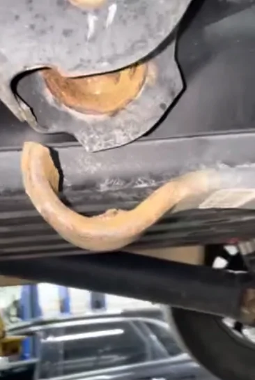

Took my 2020 in for 40k service, and to check on a transmission bucking problem they can't replicate, and they sent me a video. Both leaf springs broken. This shouldn't be possible on any 5 year old vehicle, but there's 5 or 6 of them just in this thread?
Driver
Passenger.

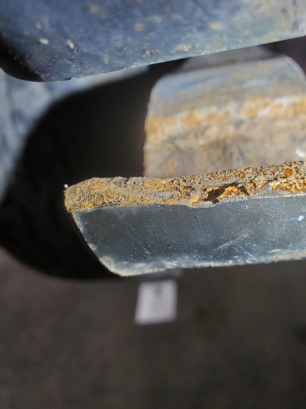

I have the parts and I'll hang on to them for a while. I'm not looking to cause problems for Ford, but the "how could this happen" part of me wants to do more research.
Mine did same thing, 2019 lariat fx4 ranger. 3700 to replace ford wont cover because milage. Same spot. Delamination of the steel. Ford knows about this and wont do any thing.
