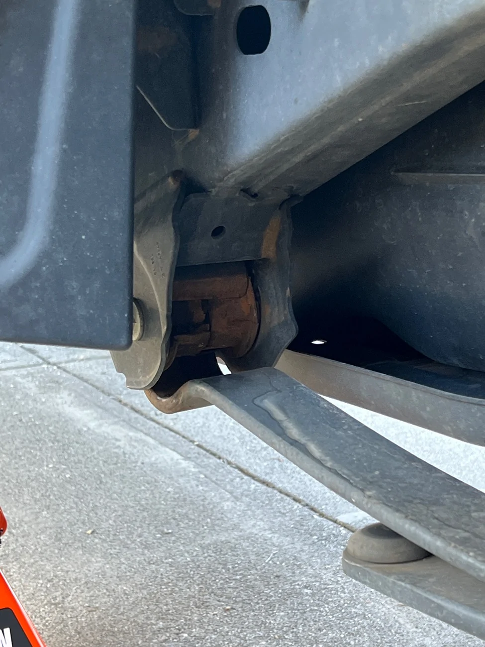

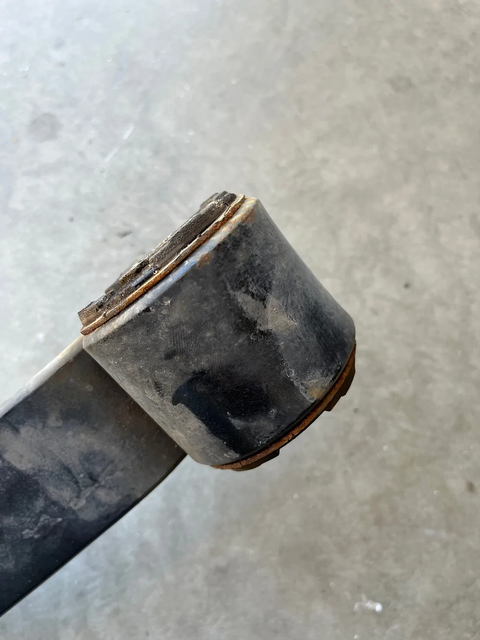

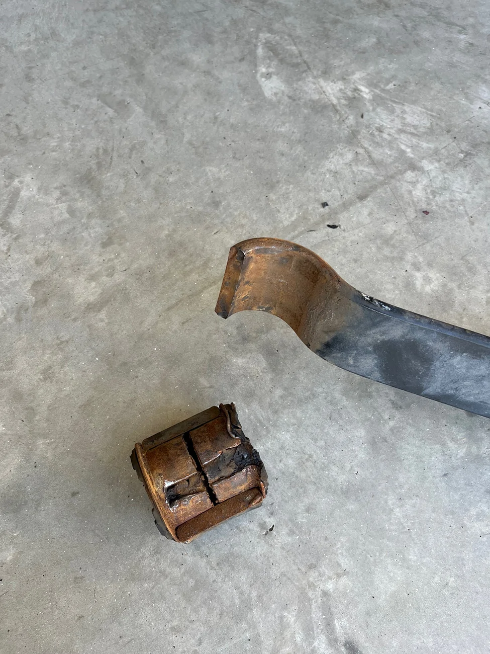

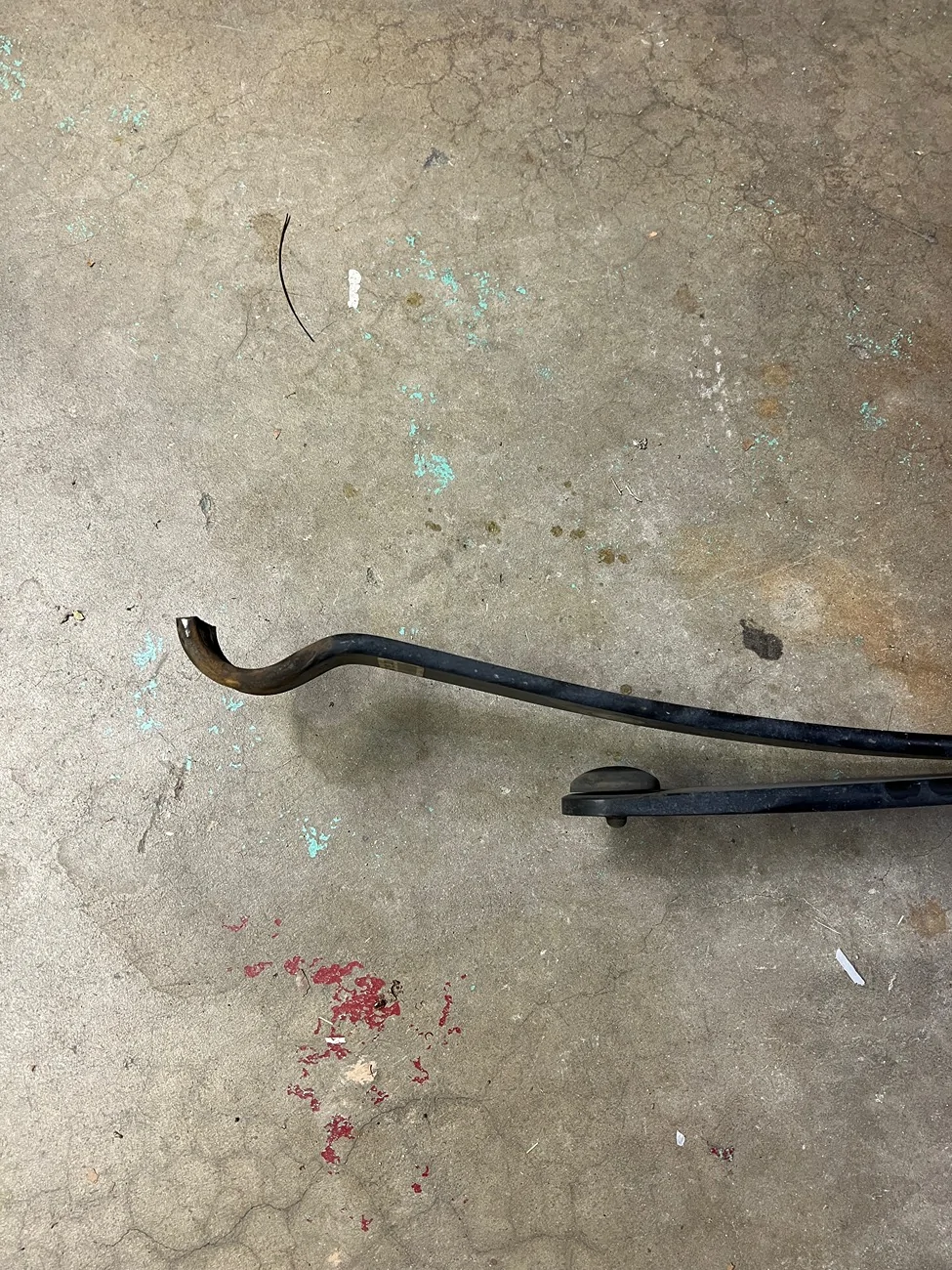

I took these pictures
here are some pictures of mine still on the truck. They look identical to these. I am still waiting to hear from the dealership tomorrow see if they will replace them.

Just found the forward attach point on the right rear leaf spring fractured on my 2019 Lariat with 62,000 miles. By the appearance, it appears to have been broken for some time. Noted an unusual noise and investigated. I don't live in the rust belt and the undercarriage and components are rust free.

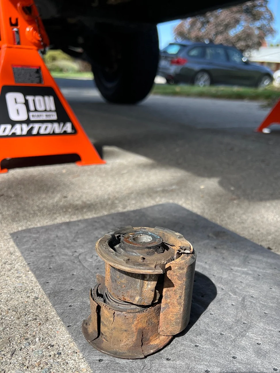

Grandson and i installed the Icon leaf springs yesterday afternoon.
Attached is a photo of the right side leaf spring that fractured at the forward attachment. The other photo is of the left side spring that shows rust at the periphery of the forward attach point bushing. Time on truck is 62,000 miles. Ford Quality.....NONE

Love to see a successful upgrade! My front bushing looked same as yours when I removed it--completely junked. I wonder if in our situations the bushing failed first then the forged eyelet? Or vice versa. Either way, agreed that is not acceptable.
I replaced the bolt and nut on the forward eye on the side that failed just in case it was compromised somehow, but like you observed all of the hardware looked to be in really good shape.
