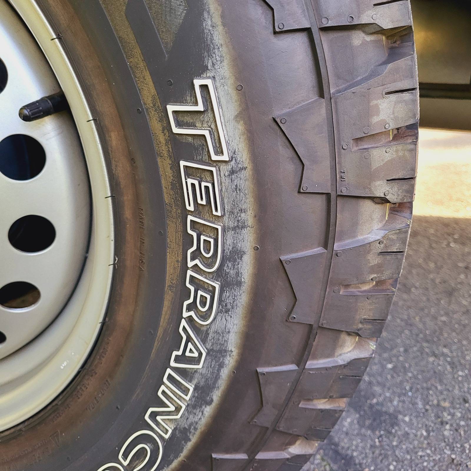

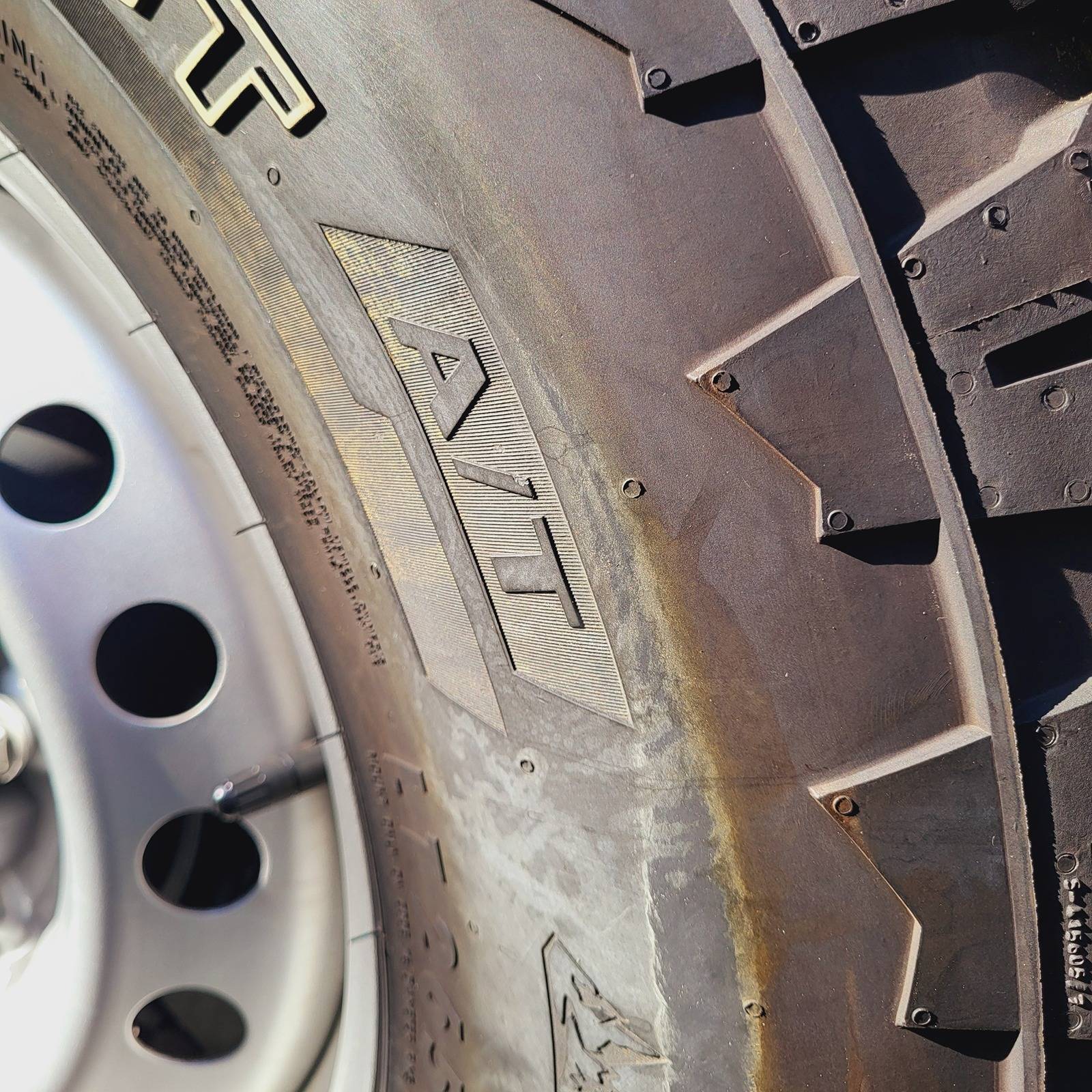

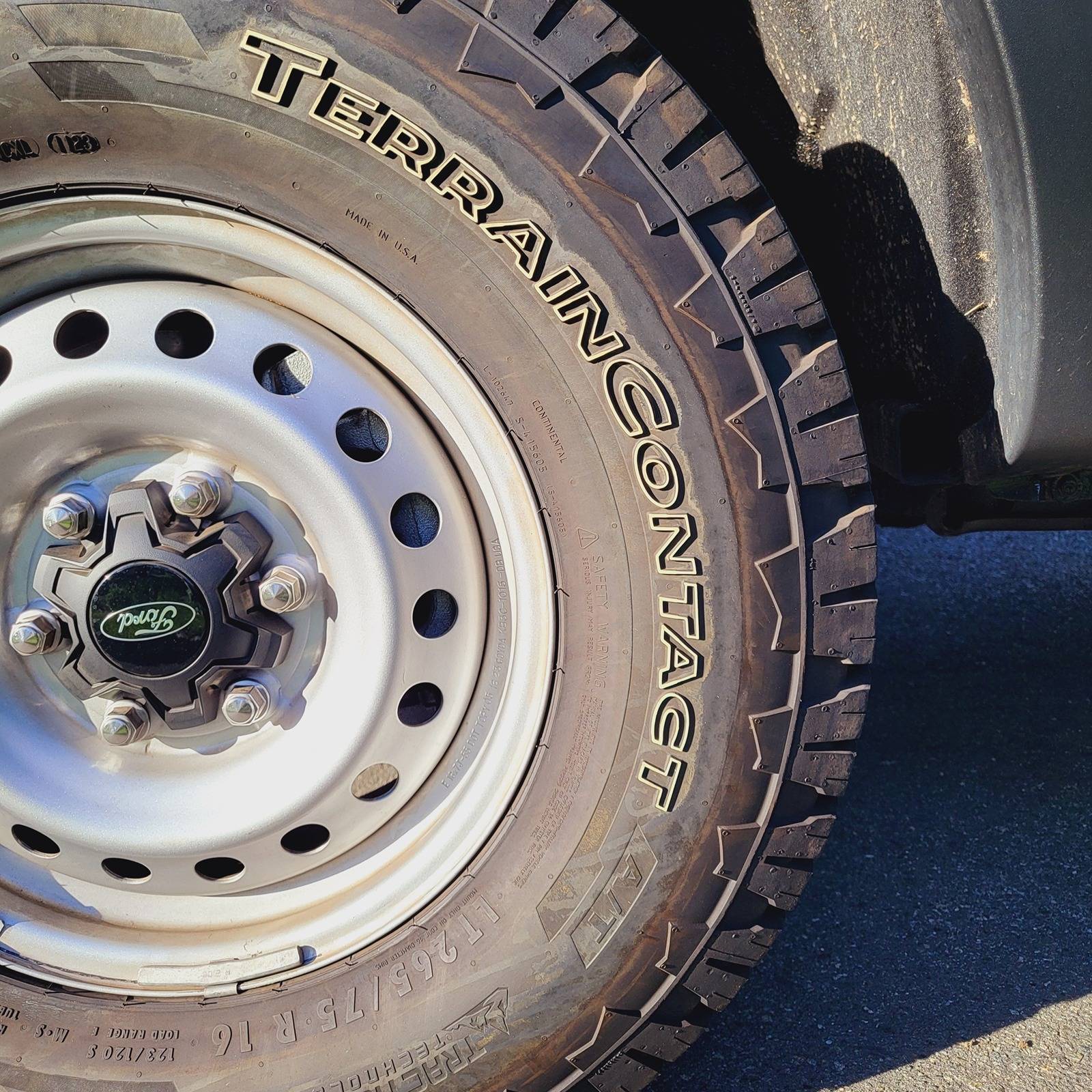

Long-time no post. So here is an update on the Continental TerrainContact A/Ts I had fitted back in November '23. With only a mere 3K miles on the vehicle (it is lightly used for local transfers and weekend work), the Continental's are starting to show a very ugly white/green caulk effect on all 4 sidewalls. One tire looks especially out of the ordinary. The vehicle goes through a local car wash (same as my daily drive, which also has Continental's and does not show the effect..) I'll be contacting my tire installer to discuss with Continental - but I'm curious to hear what the crowd thinks is the cause. ??

That looks like crap, sorry. My OEM Hankooks turn brown sometimes, which I hate, but not nearly as bad as those Continentals. How often do you wash your truck? When you wash, do you use a brush on the tire sidewall?

I wash it 2-3x per month. The truck sits in our paved parking area most of the time. It would seem odd that lack of use would be a cause for whatever compound is leeching from the rubber blend. We have other vehicles that sit for equally long periods of time and those tires look fine.

The OEM Hankooks will turn brown sometimes also, but not as bad. I dislike them for that (among other things, including the OWL that never looks clean).
Maybe you can try some of the arosol tire cleaners (if you haven't already).

Jeff, here’s an important excerpt from the article I linked above…
Tires bloom because antiozonant pushes its way to the outer edge of the rubber casing with time. As the element comes into contact with oxygen, it leaves a brown residue on the surface of the tire. Antiozonant is organic and helps tires last longer as it slows deterioration due to oxidation. This is what makes it possible to manufacture long-lasting high-mileage tires.
I used to have some browning on my General Grabbers. Now, I make sure to scrub the sidewalls every time I wash the truck and I apply tire dressing. It takes a couple of washes and applications to get rid of that build-up but once it’s gone, it’s easy to keep it under control. @Msfitoy told me about a great tire dressing that leaves a matte finish - it’s not shiny - basically, it makes your tires look brand new. If you prefer the shiny look, those dressings work too.

Tire care isn’t that much extra work and it’s a small price to pay for having longer-lasting tires. Besides, your truck will look great after you wash it! Especially if it’s a Shadow Black SuperCab with a fibreglass topper. ?

Thanks, Duke. I spoke with our tire dealer and they are getting the Continental Warranty Dept involved. Will keep this post open to advise on how it gets resolved.
