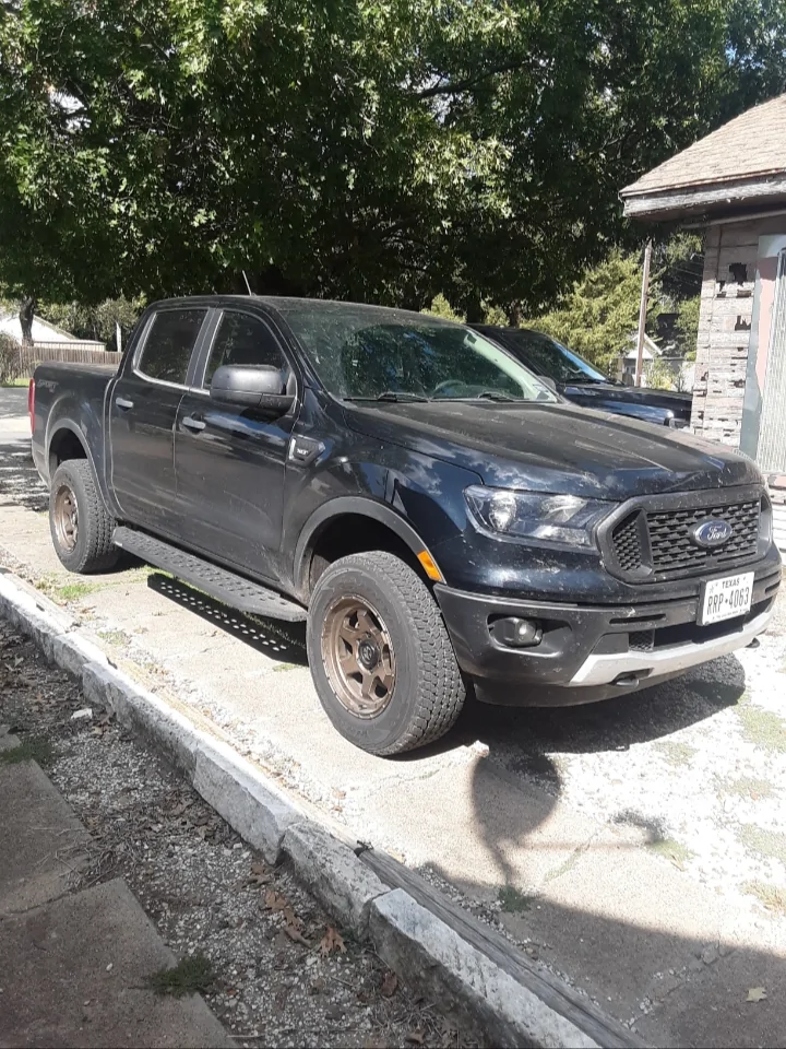

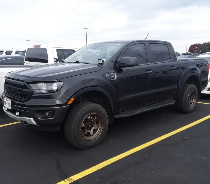

22 Sport 4x4, no lift, no level. Factory Ford OEM suspension.
17x9 Fuel Shok bronze wheels with +20 offset and 255/65R17 Goodyear Wrangler ATs

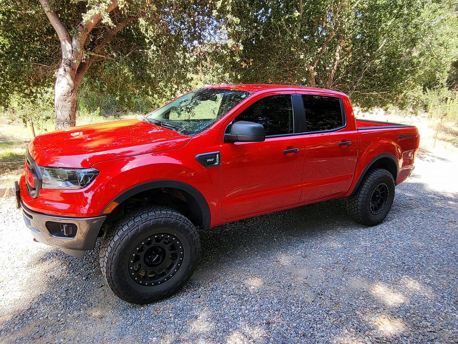

I went an inch bigger in diameter 31.5” with 265/65/18 Duratracs
The stock one was 30.5” 265/60/18 Hankook Dynapro
No issues so far at 140 plus miles.
I think the issue would be the width, so I checked this first
https://tiresize.com/comparison/
According to the size calculator, the width is the same with the tires I chose.
Any issues now with rubbing???? I am looking at the exact same set up

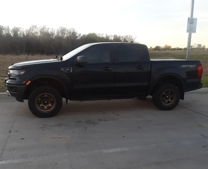

Yes, they raised it up in the rear quite a bit. This was taken the afternoon of the day I had them installed, and before I ran out of daylight lol.

Looks good! I saw that after coming across another of your posts. Notice much difference while driving? You went with 1.8"?
Might have to poke around and see what I can do to keep it level at most. Spend a lot of time hopping in and out of the bed in the spring-summer and its already hard enough with a step.
TxOTRRanger
Clay
Jul 14, 2025
1,670
7,924
Elwood, Texas
Thank you! Yes, 1.8 inch on the front height setting. Compared to the old stock worn out shocks and struts that were on it for 100,000+ miles. The Bilstein 5100s firmed up the ride and the front end doesn't dip, dive and wallow like it used to and the rear end doesn't bounce anywhere near as much as it did before the upgrade. With the firmer shocks and struts to me it reminds me of what my late Grandpas old farm truck rode like. Firm, but smooth and controllable.
