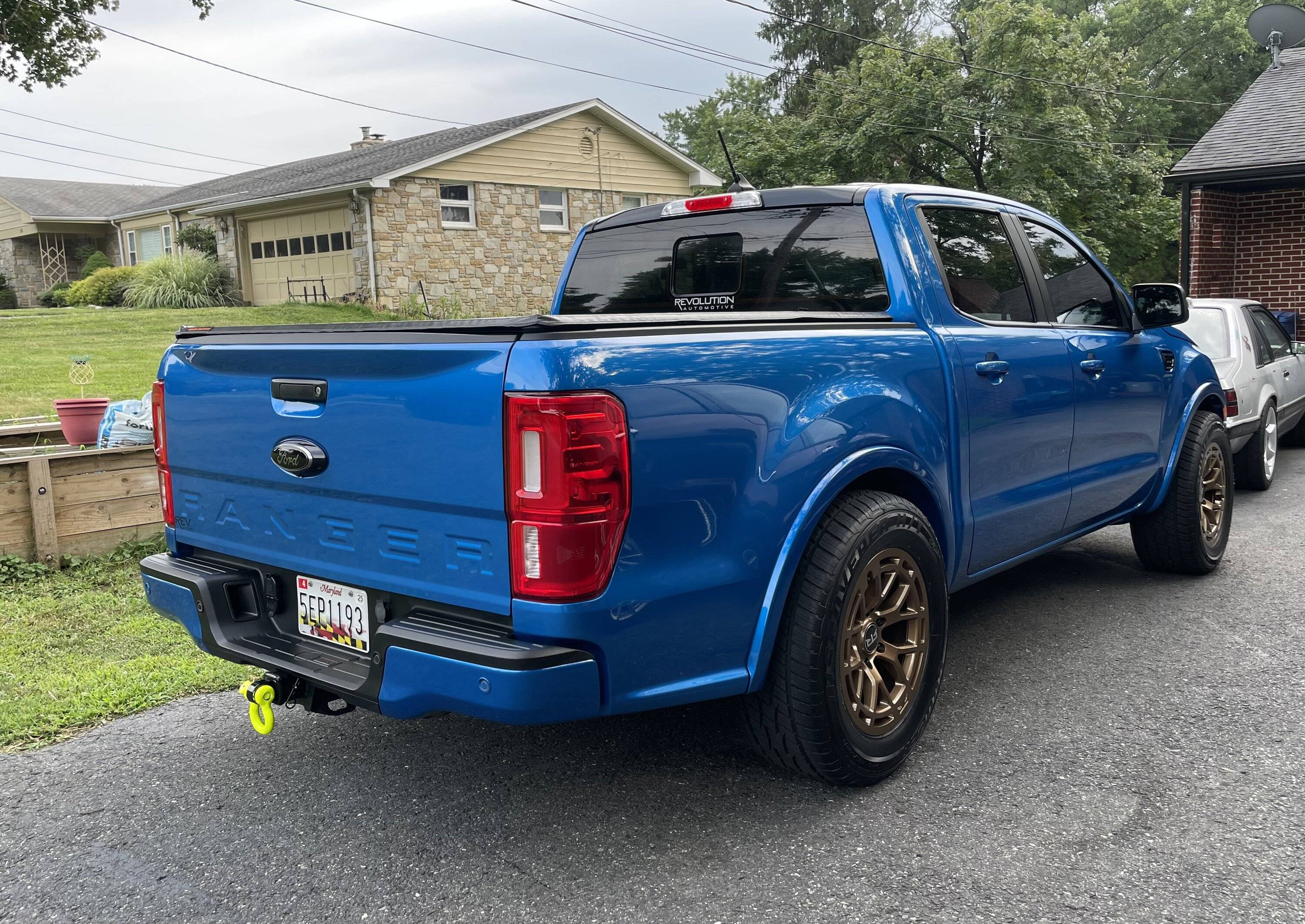

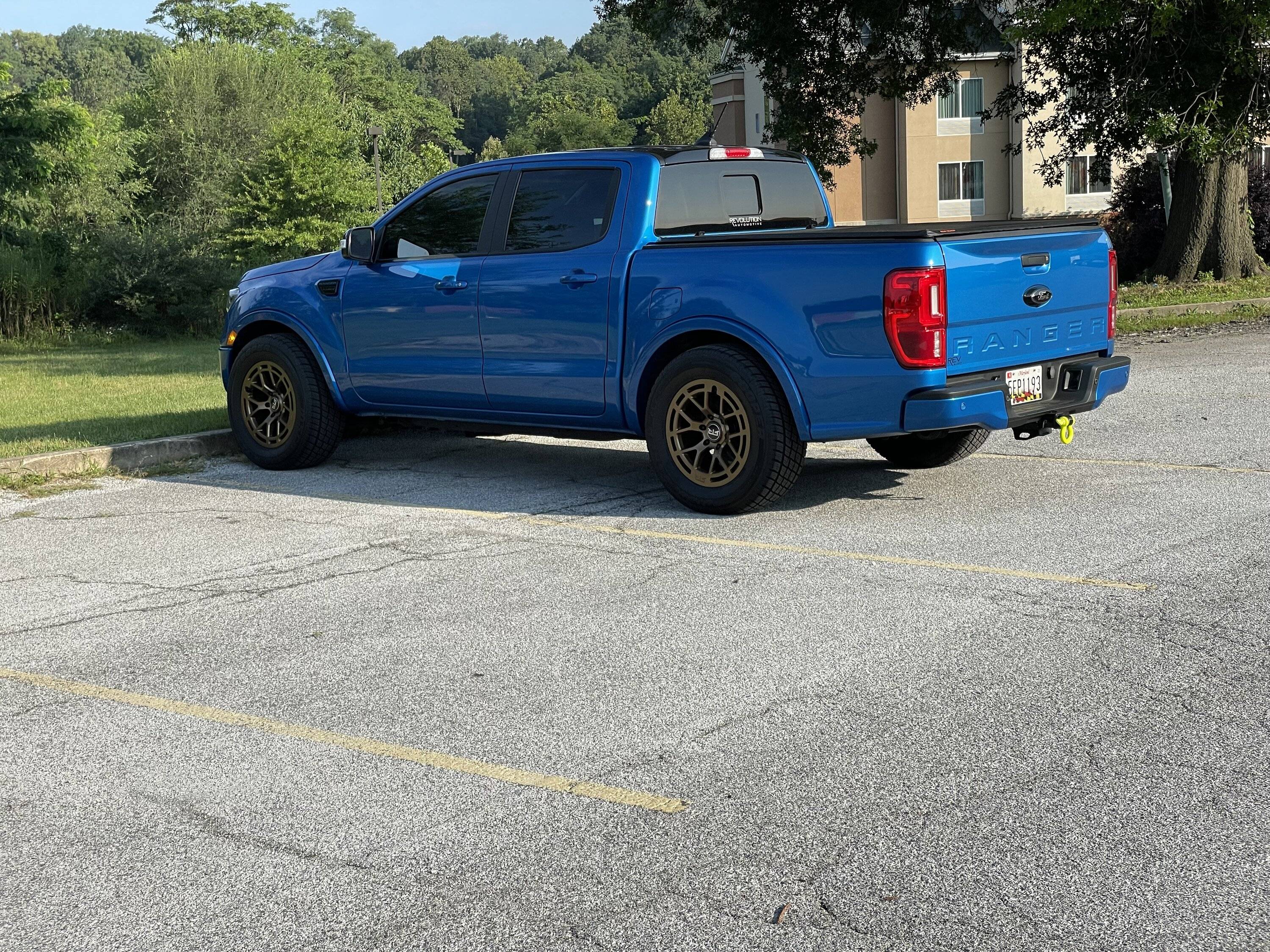

I removed the crash bars, cut the brackets, stretched and trimmed the fender liners and bent the core support.
I no longer have those tires though. I now have 285/60/18 and they don’t hit anything at all and are so much lighter.
Love the bronze wheels with the blue! Looks amazing! Thanks for sharing!

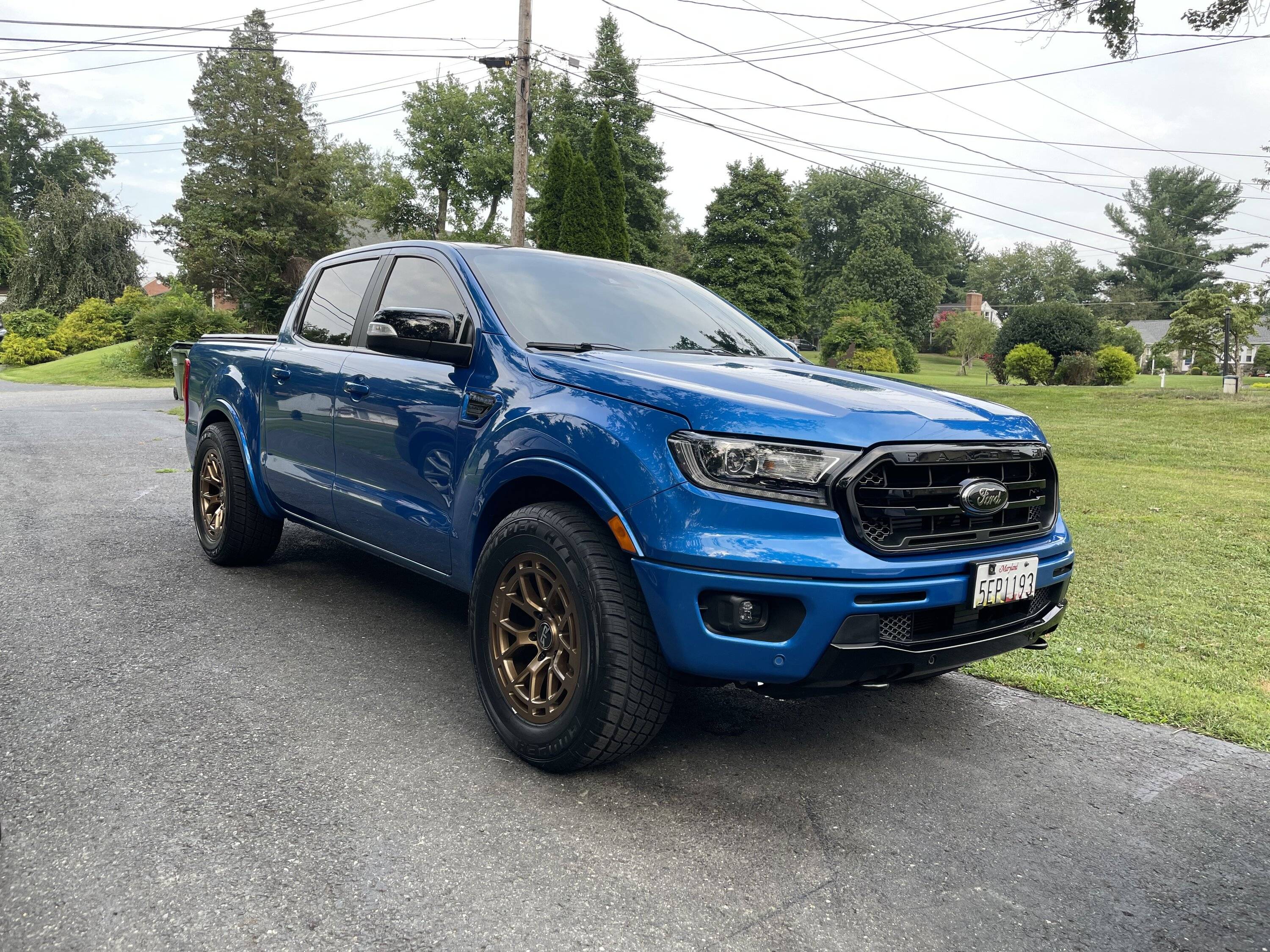

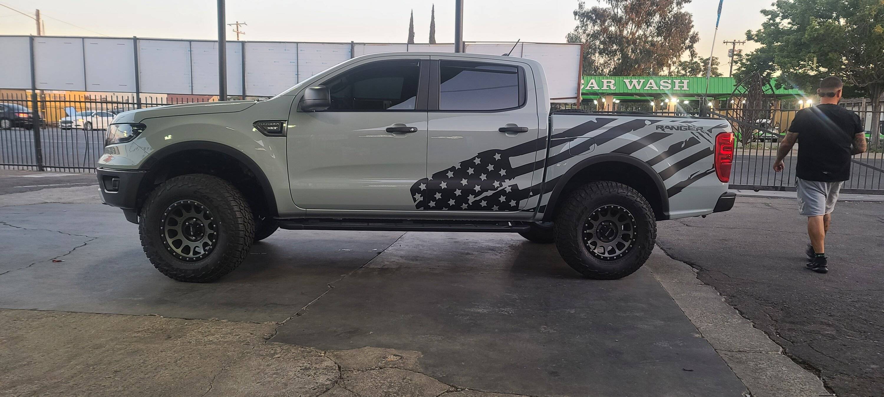

What offset are your wheels? I'm about to order some 0mm offsets I know that theyll push the face of the wheel outwards about 2", just trying to get an idea of want to know what they'll look like actually on the truck.
Loweredon33s
Dec 13, 2022
748
1,810
Baltimore
2021 Ranger
Performance person
They are technically +30 but I also have a 30mm spacer which makes them effectively 0 Offset.

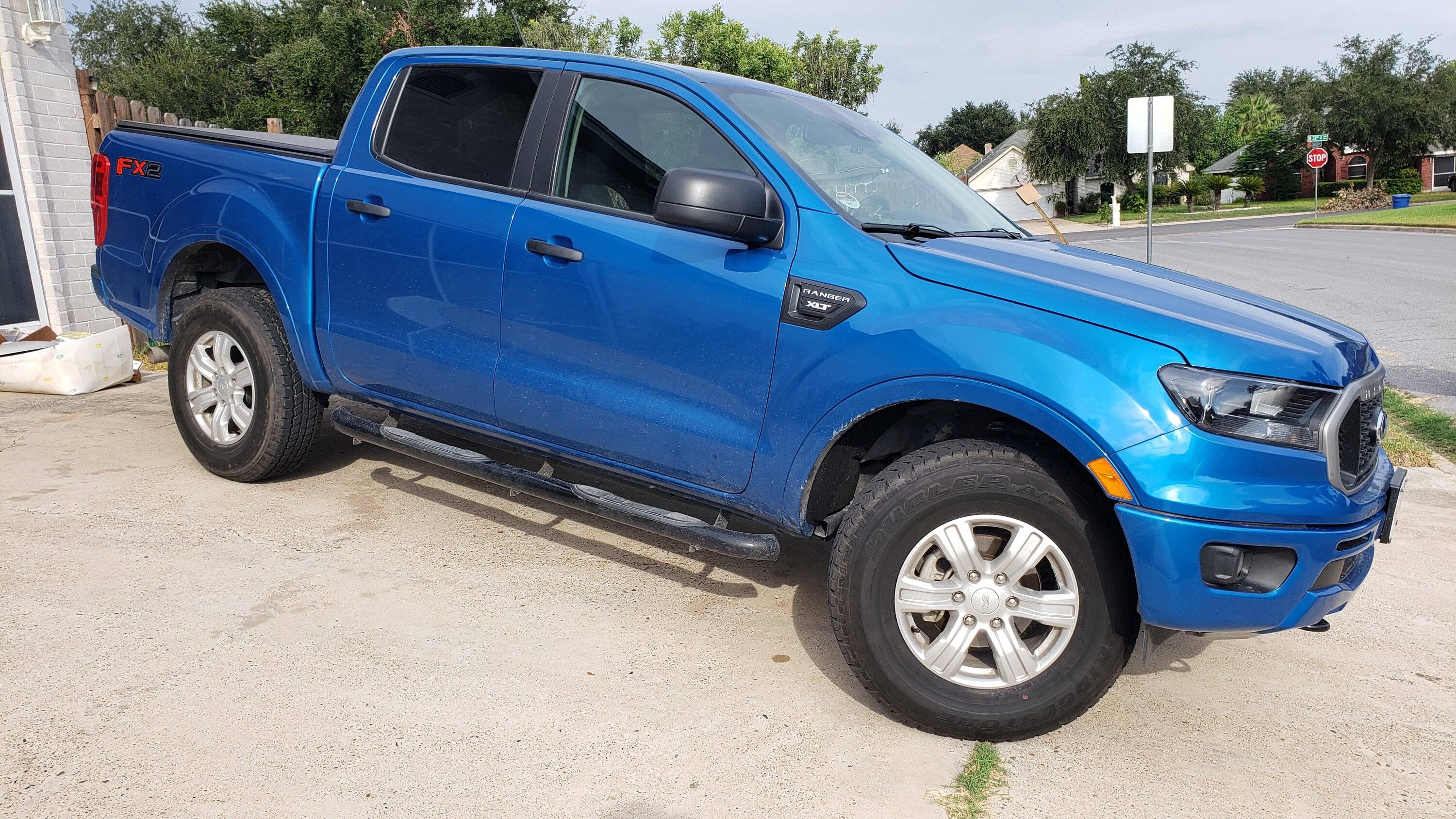

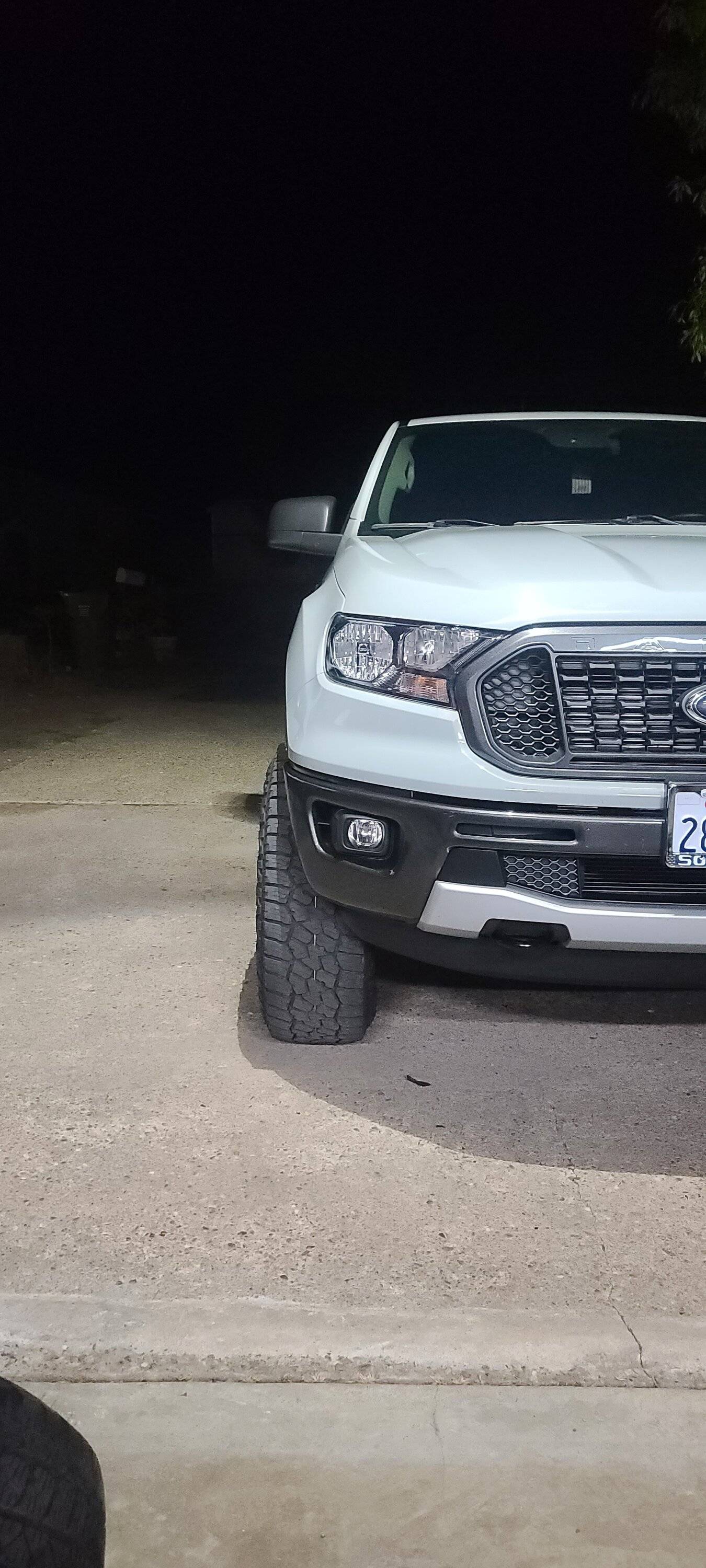

I saidbi would post here when i did this.

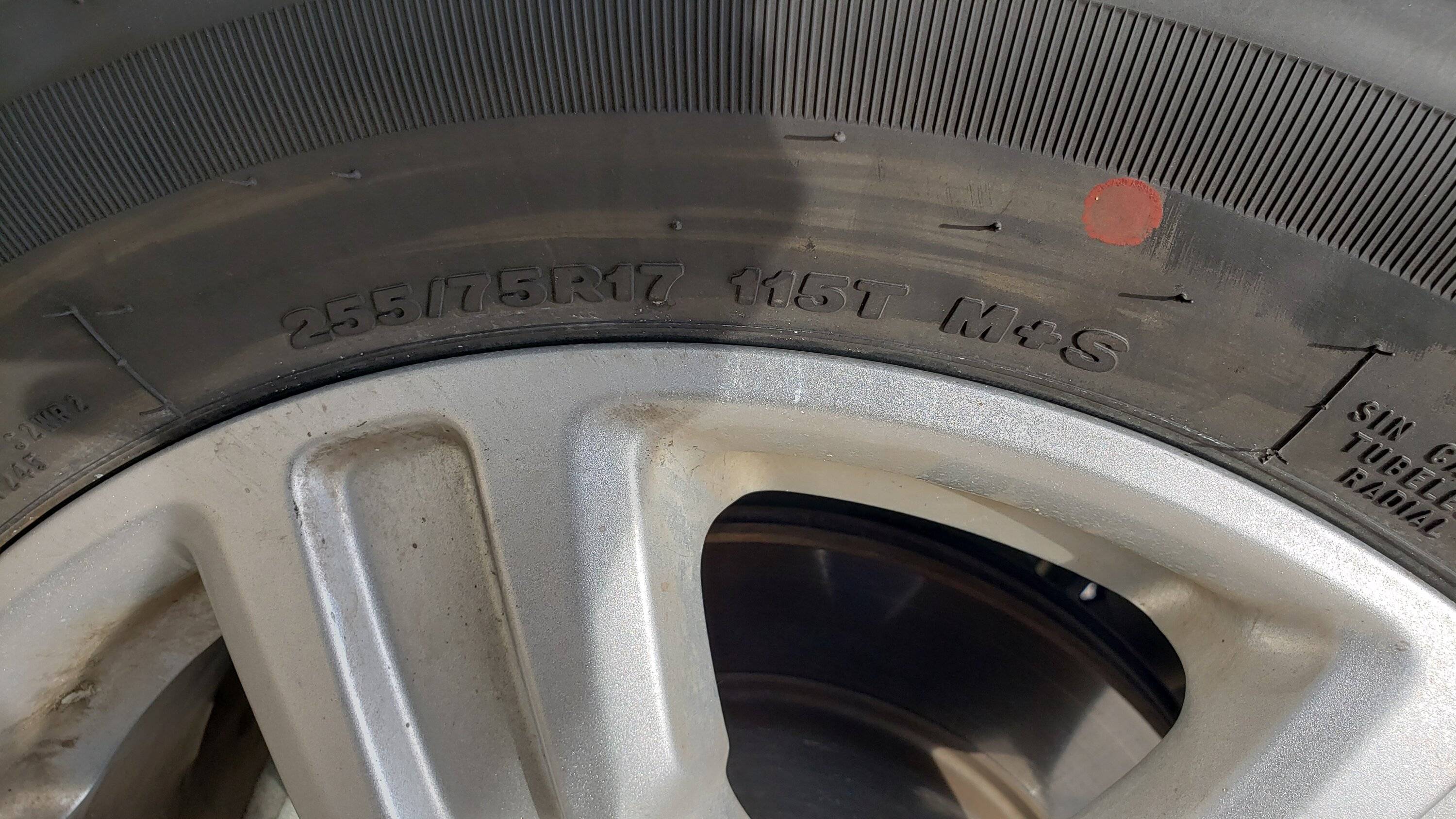

255/75/17
No rub! Ride is so much smoother too. Like a whole new set of shocks. Acceleration feels like a big truck. Fixed speedometer with forscan. All stock vehicle. Only mod is tailgate strut assist.
2022 xlt fx2

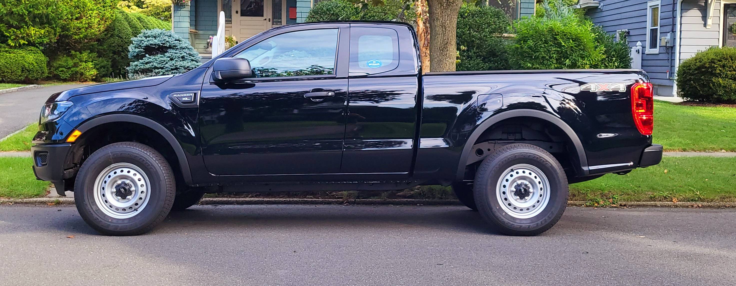

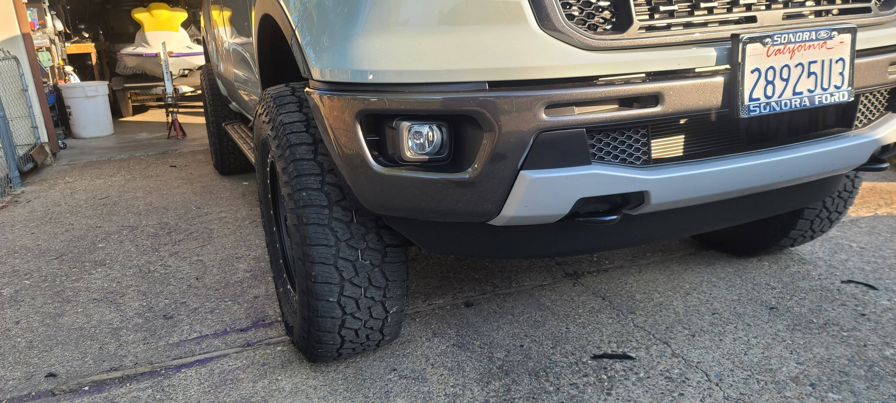

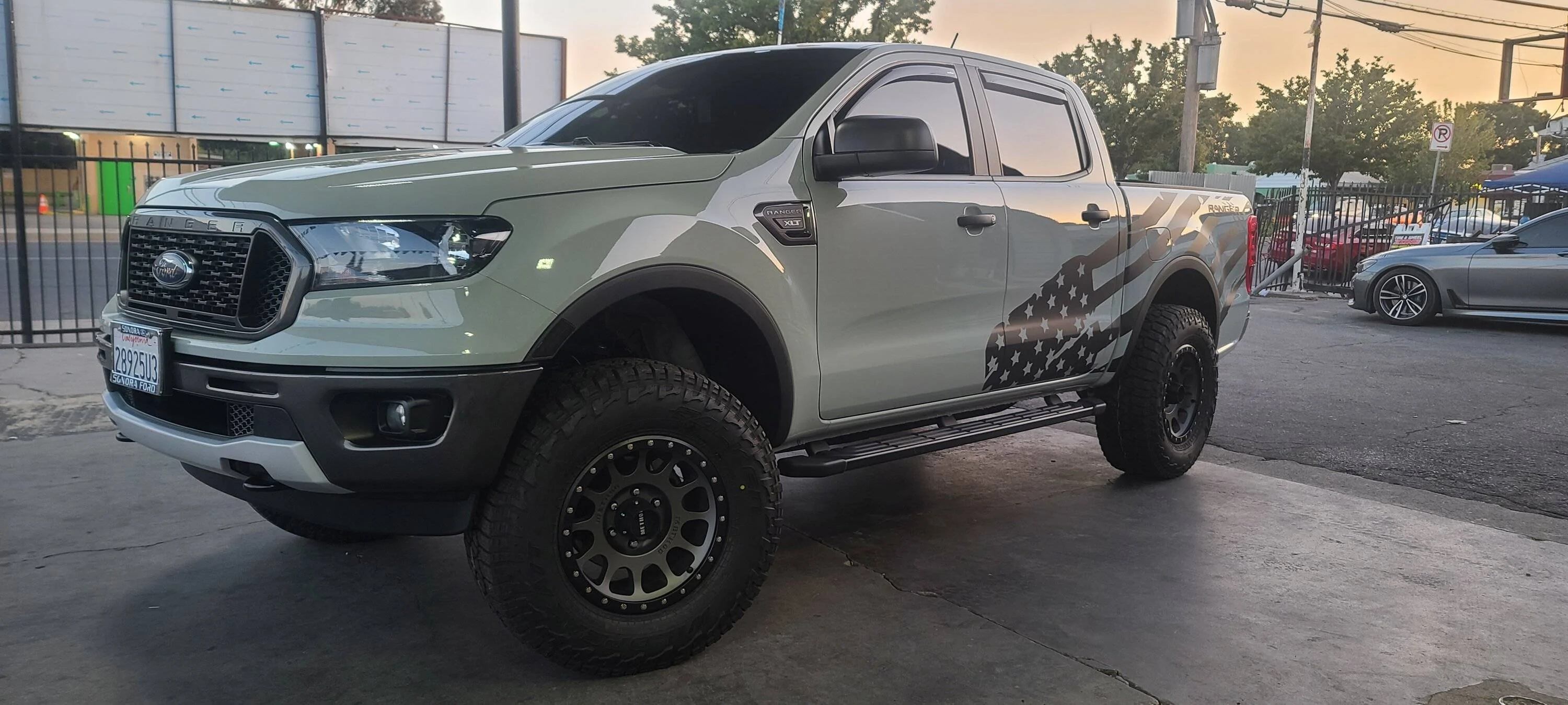

285/70/17, 2.5 level, removed crash bars and trimmed front lip, no rubbing

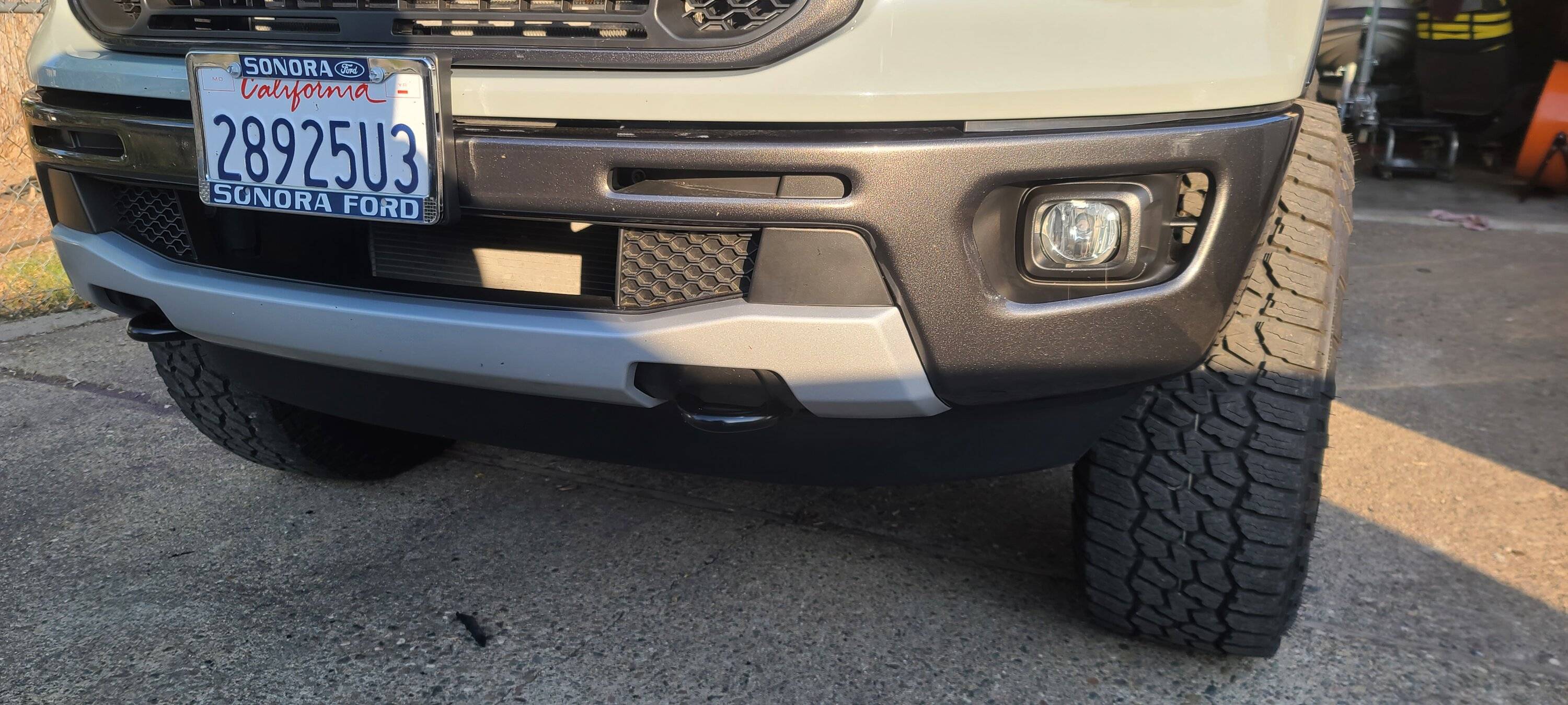

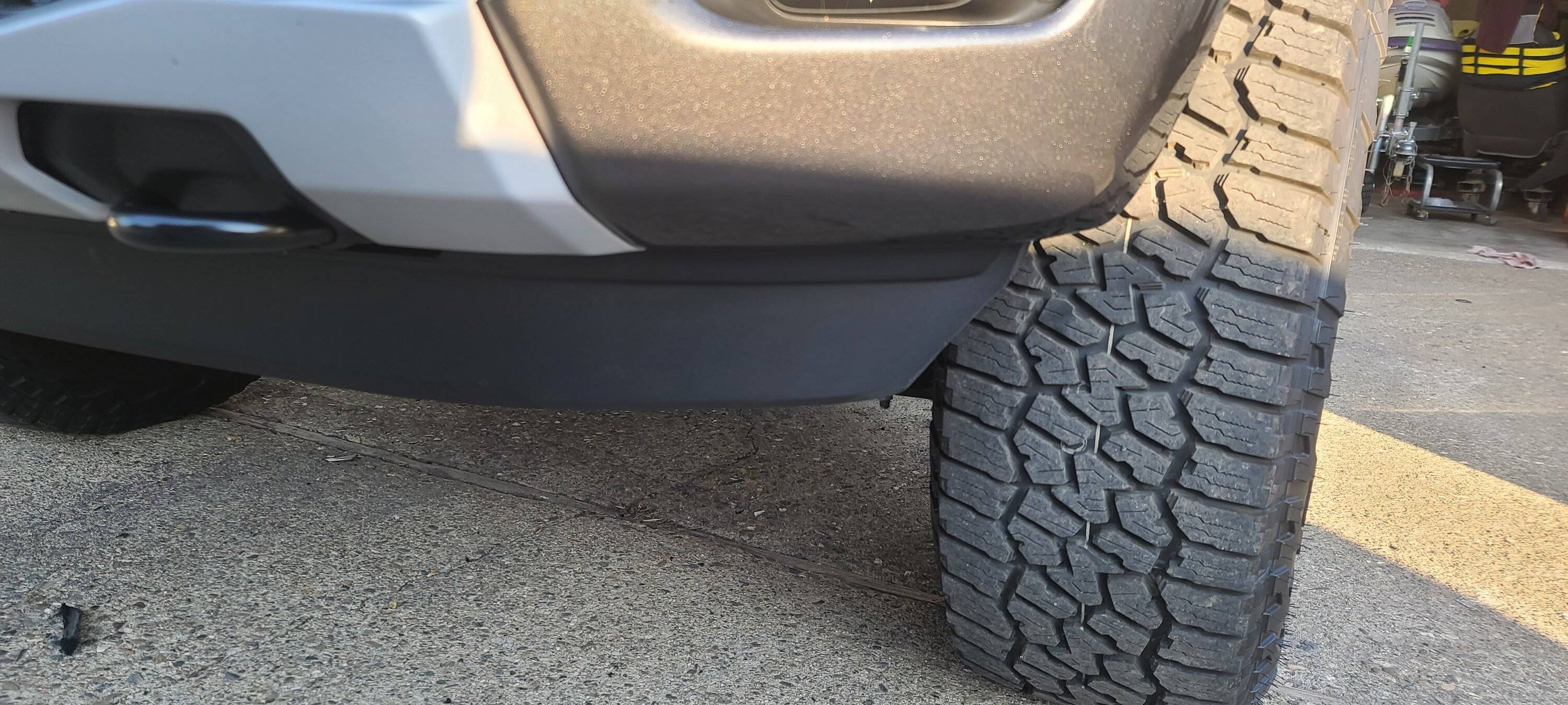

Could you post a photo of the trimmed front lip. Curious to see What you did.
David530
Aug 15, 2023
57
Calaveras county, California
2023 Ranger XLT, 2002 Ranger Edge
Mechanic/ decal and logo designer
absolutely, I used my angle grinder and just followed the same shape the lip already had but just a little bit inward, I took off a little and went and drove around to see if it still rubbed and it did so I took a little more off now we should be good, just a little at a time, you can always take some off but can't put it back on, I don't think anyone is even gonna notice. After I was done I smoothed it out with a piece of sandpaper and it looks good I think!
