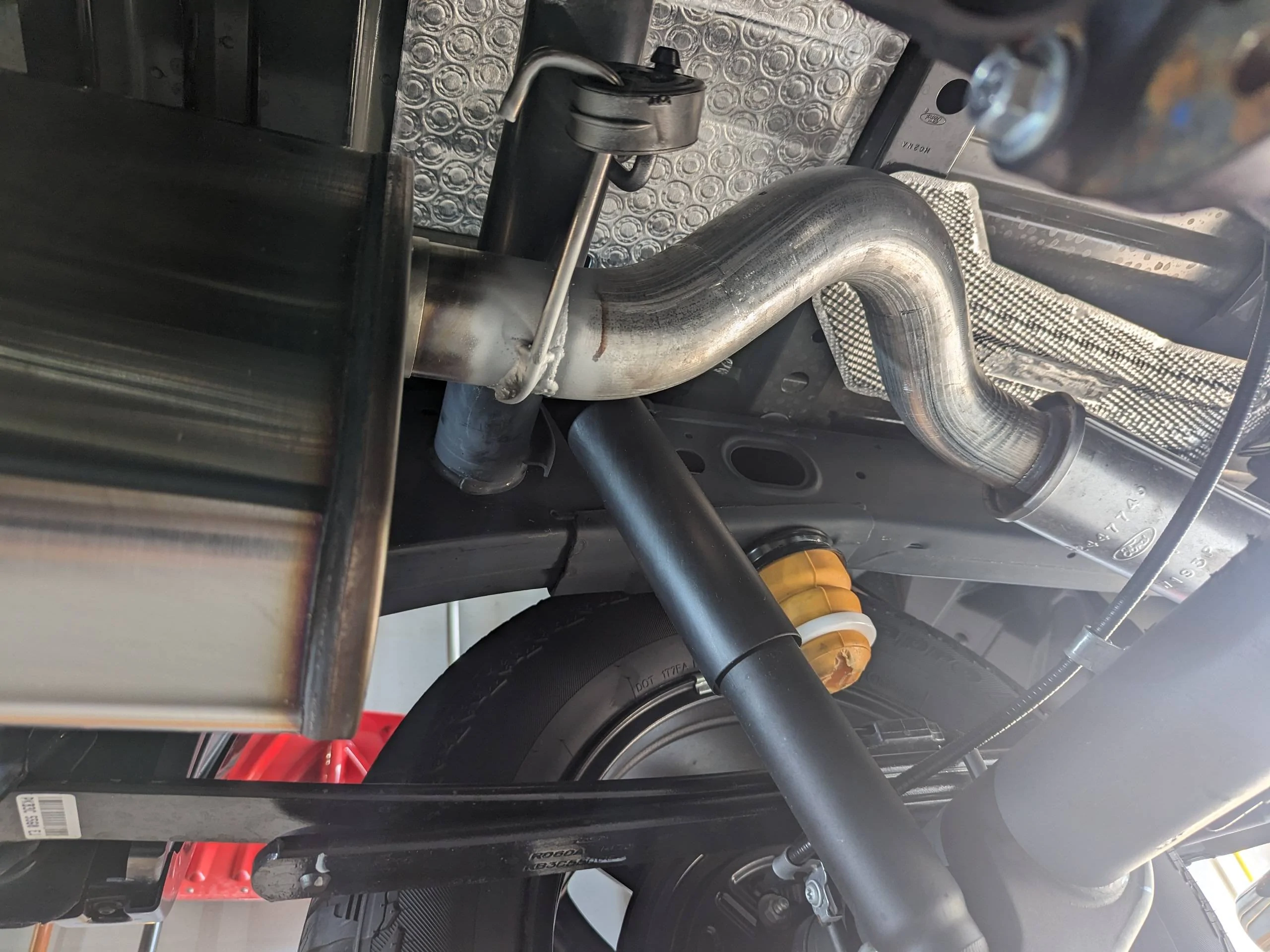

Instead of purchasing an off-the-shelf system for my 2023 Ranger, I decided to modify the OEM exhaust. Many of the systems out on the market are simply too loud for my taste - I'm around loud, heavy equipment all day long and the last thing I want is the interior of my Lariat vibrating/buzzing from exhaust drone. I had a Gibson system on my last Ranger and I had to add a resonator to quiet it down.
Normally, I would have performed this modification myself, as I have a MIG welder set up for stainless in my garage. However, doing exhaust work without a lift is a pain in the balls.

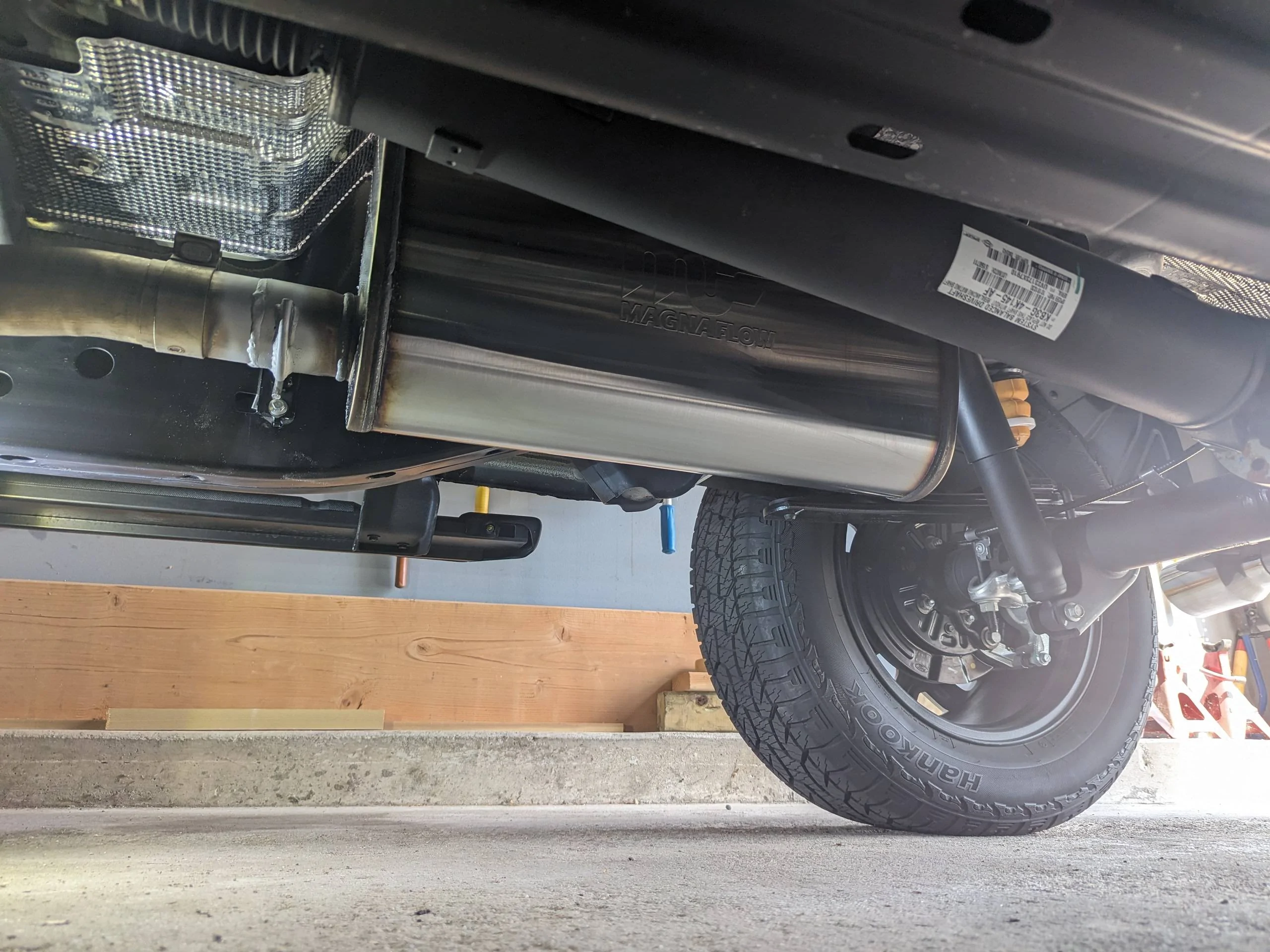

The muffler: Magnaflow 12577, $168.87 from Summit Racing
https://www.magnaflow.com/products/...ght-through-performance-exhaust-muffler-12577
This muffler fits the OEM location almost perfectly - the length, inlet/outlet diameters, and inlet/outlet offset distance are spot on.

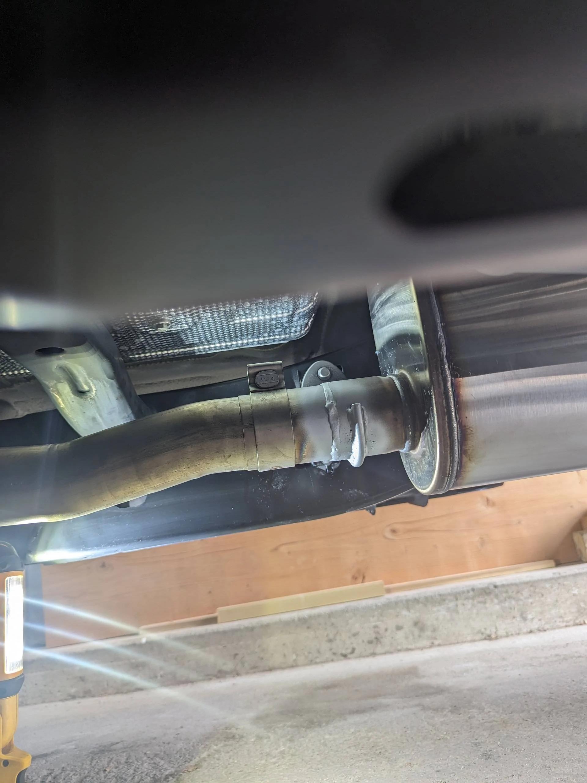

Muffler install: $150
I had a local shop that does quality work (Exhaust Works in Montgomery, IL) remove the OEM muffler and retain the inlet piece and existing tailpipe w/resonator. If I ever need to return to stock, I have a complete, unmodified OEM exhaust system in my attic that I can bolt on. This is why I *did not* modify the long pipe leading to the inlet pipe of the OEM muffler. The shop originally wanted to charge me $100, and I gave them $150 - I appreciate them taking me in promptly at 8am on a Thursday and completing the job within 30min. I'm a mechanic, and somebody buying lunch now and then goes a long way... Everything was welded and I sprayed some hi-temp paint on the welds when I got home.

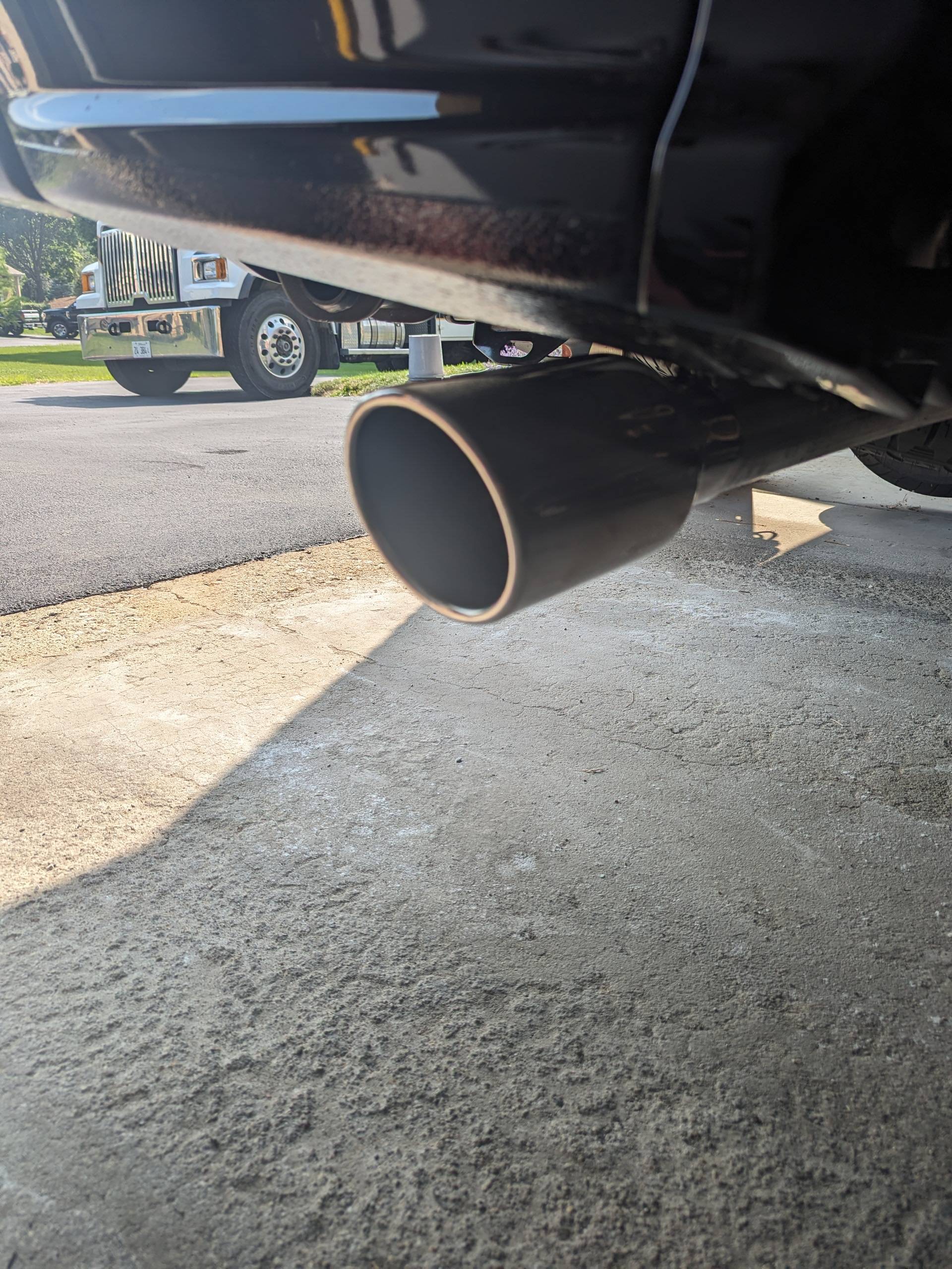

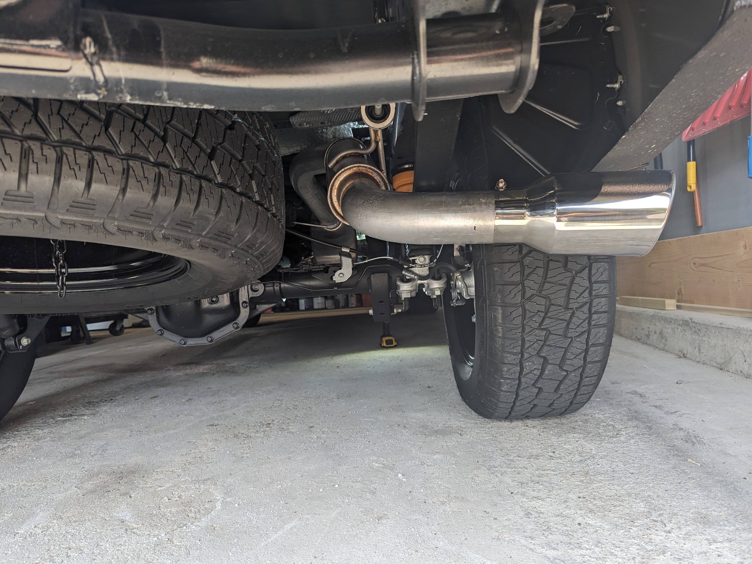

304 Stainless tip: $20.56 from Amazon
https://www.amazon.com/dp/B09KBGFK82?psc=1&ref=ppx_yo2ov_dt_b_product_details
I shortened the tailpipe by approximately 4" and installed this tip. It has a 3" inlet and a rolled/slash cut 4.5" outlet. Supposedly, it's made of 304 stainless, so, we will see how long it lasts.
GRAND TOTAL: $339.43
RESULTS:
I'm thrilled - a low, mellow rumble outside with ZERO added interior drone/resonance. I have sensitive ears and I'm past the point in my life where I want to listen to gratuitous noise. If muffler deletes and straight pipes are your thing, this mod isn't for you.
WHY:
I'll be installing the Ford Performance tune in a couple weeks (after I pass my ASE test so I can do the install myself) - my experience is that a quality exhaust upgrade wakes up the turbo on these trucks and decreases spool time.
