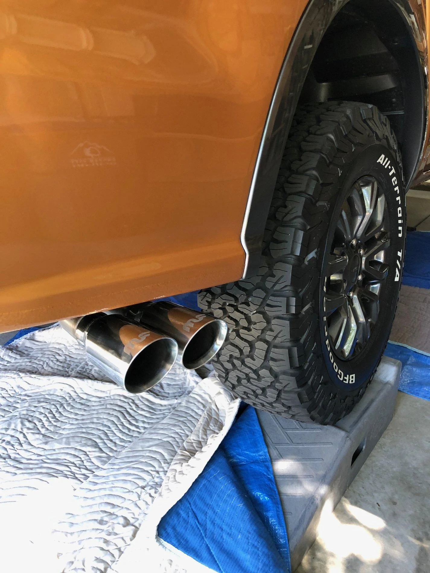

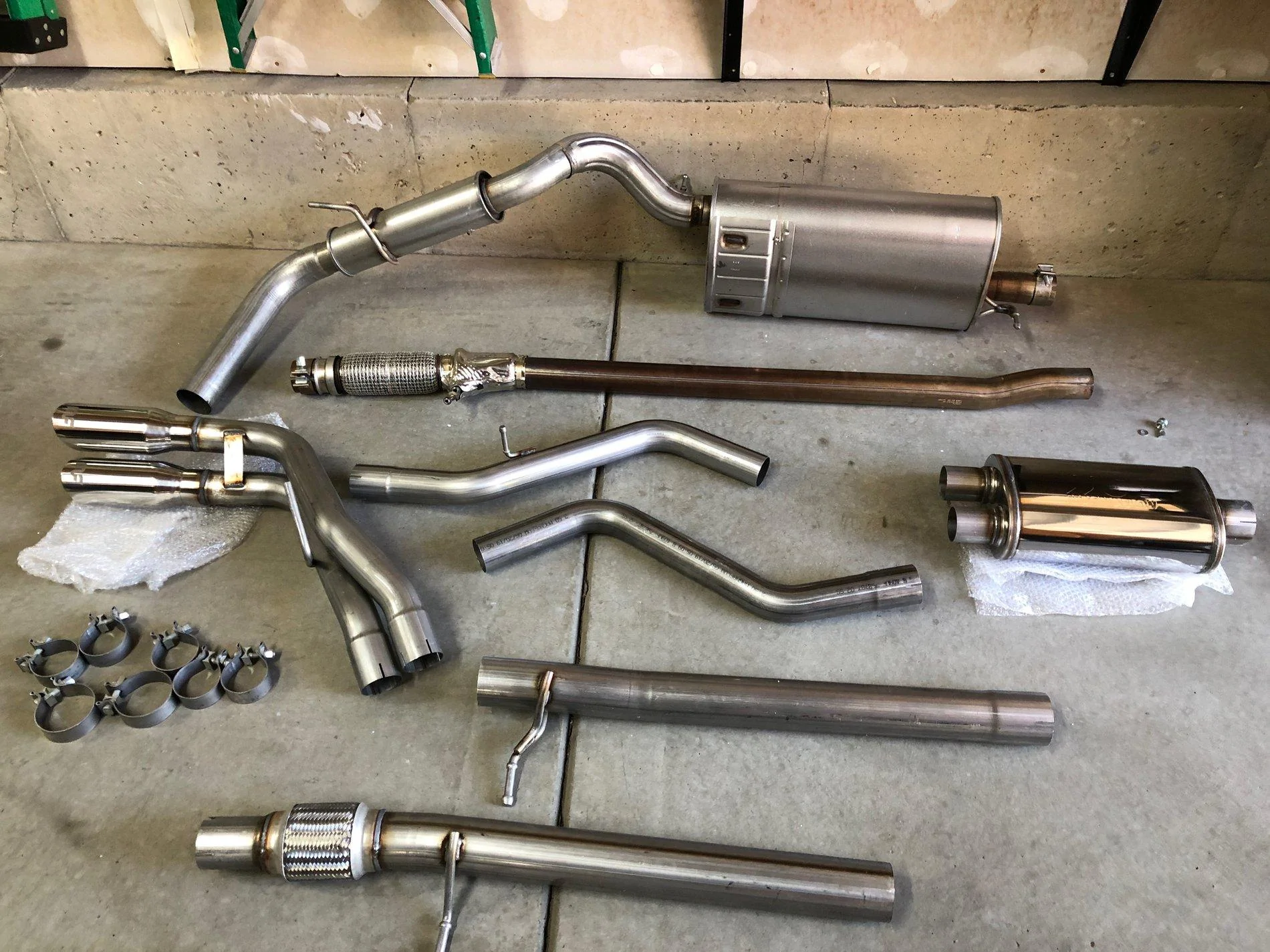

The MagnaFlow quality was apparent right out of the box. Welds were clean/consistent and the hardware/clamps were top-shelf. The finish on the polished tips and muffler was excellent.
Above is the OEM system removed (on top, 2 pieces) and the MagnaFlow system (below)

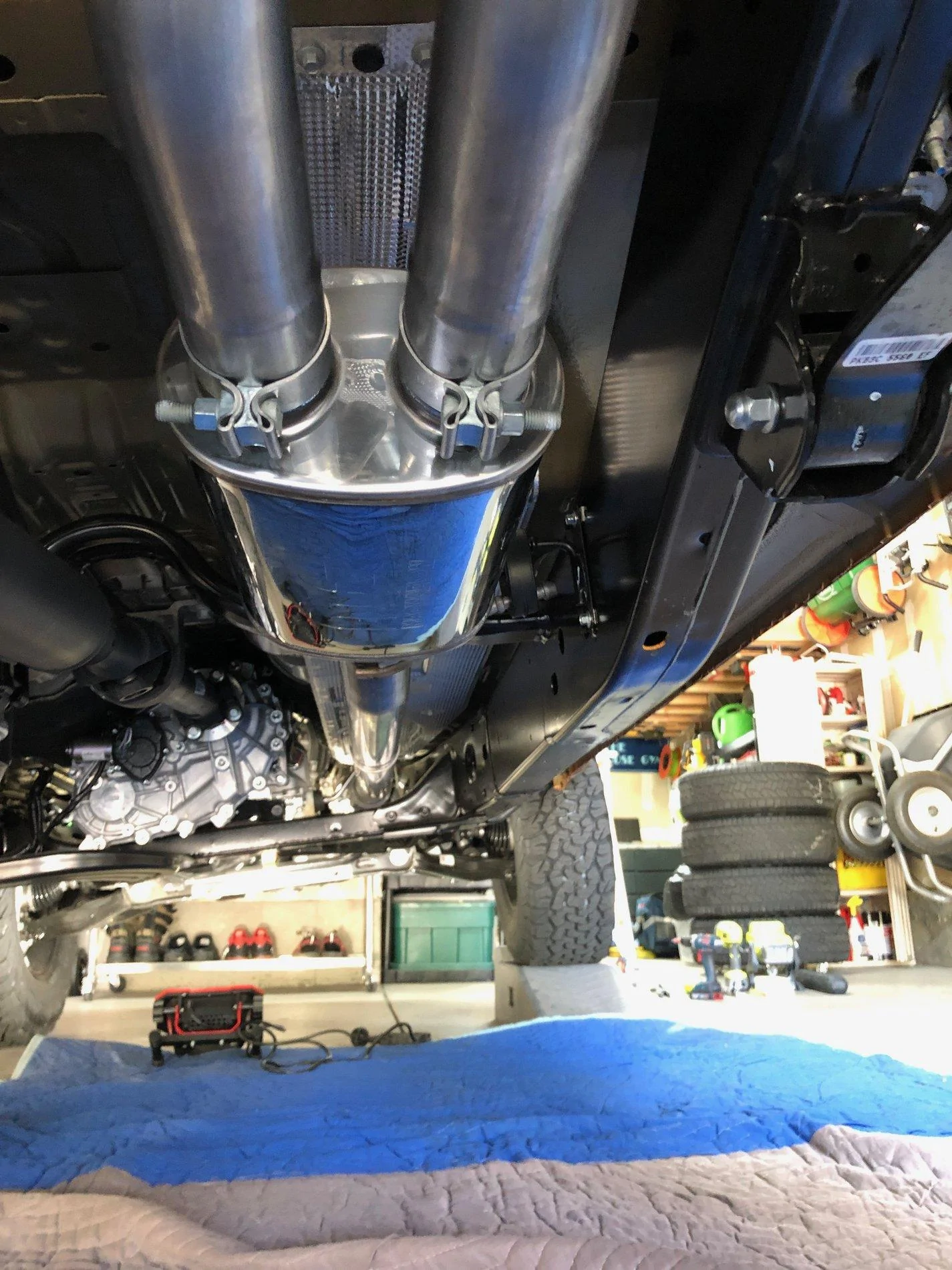

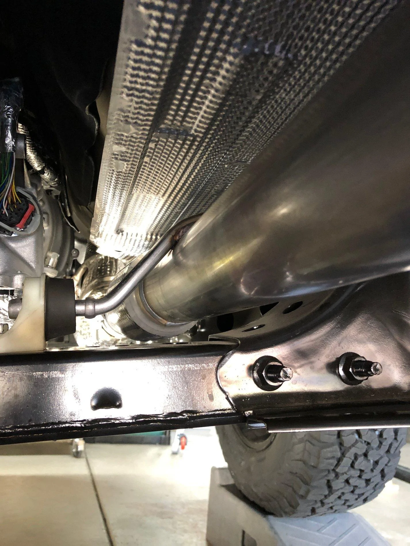

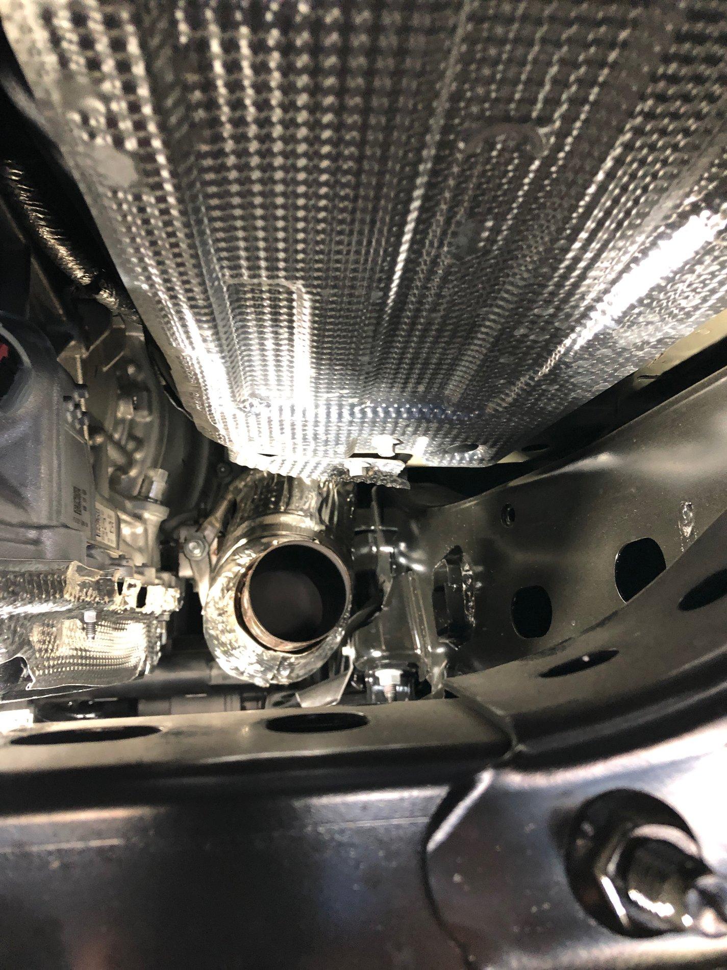

The install was pretty straightforward. I did it by myself with the assistance of 2 RV leveling jacks to properly position the system in place and to get the tips exactly where I wanted them before tightening all the clamps.
Also, I did purchase a Lisle Exhaust Hanger Tool which made easy work of removal/install of the hangers. Some say this can be done with a screwdriver and/or small pry tool, maybe so…. but even on a brand new truck that was virtually spotless underneath and the hangers were clean, this tool and a shot of WD40 made the task effortless.

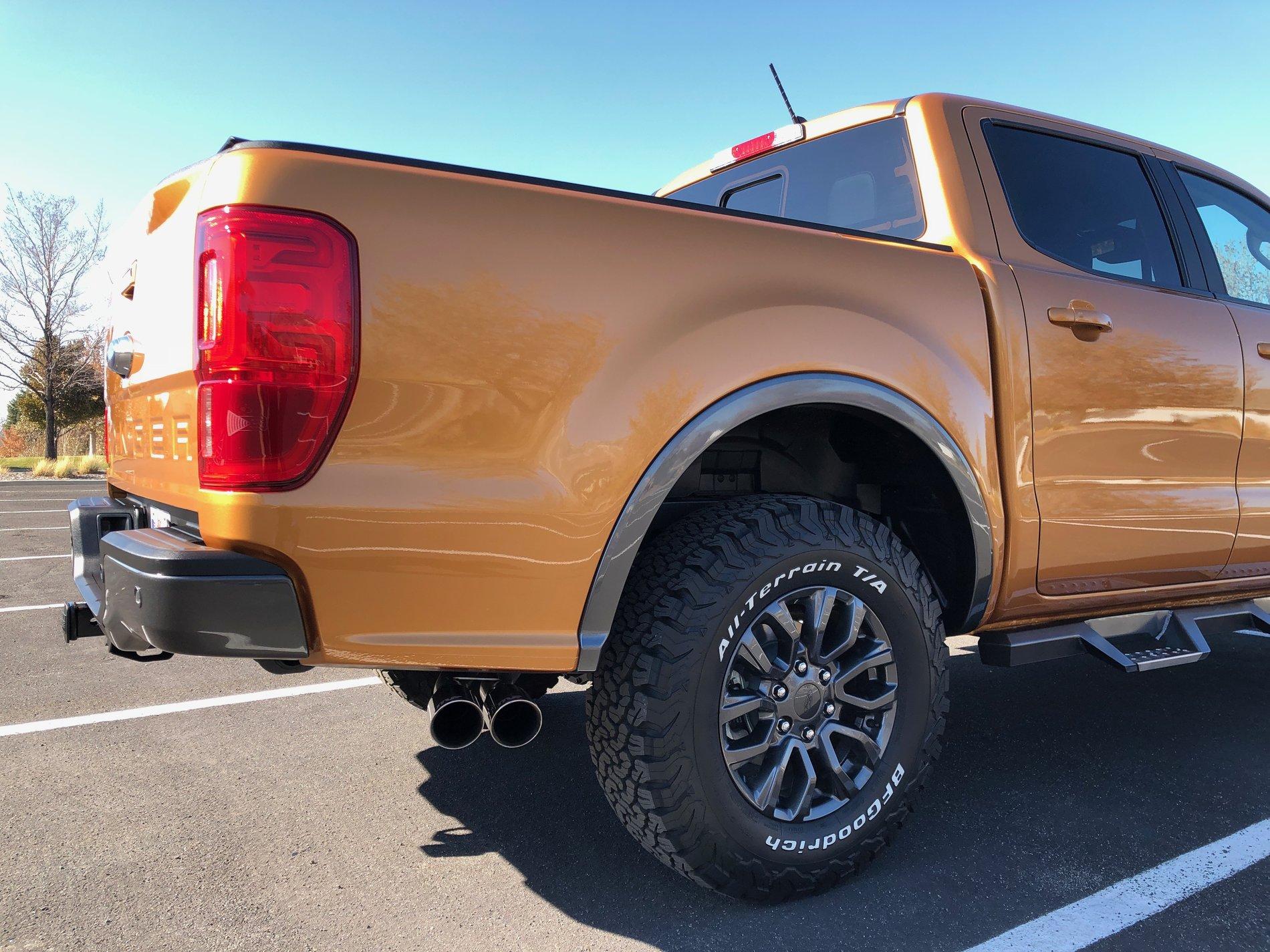

I couldn’t be happier with the MagnaFlow System. The sound really is A LOT better in-person. I knew it would sound different than the sound-clips, it’s a nice low/deep note that you can hear when you get on it, but there is no noticeable “drone” in the cabin. At start up and idle, it’s great because you immediately know it’s not stock. And back to my neighbors comment… it does not sound like an import or “ricey”…. It sounds “domestic” like a Ford!
