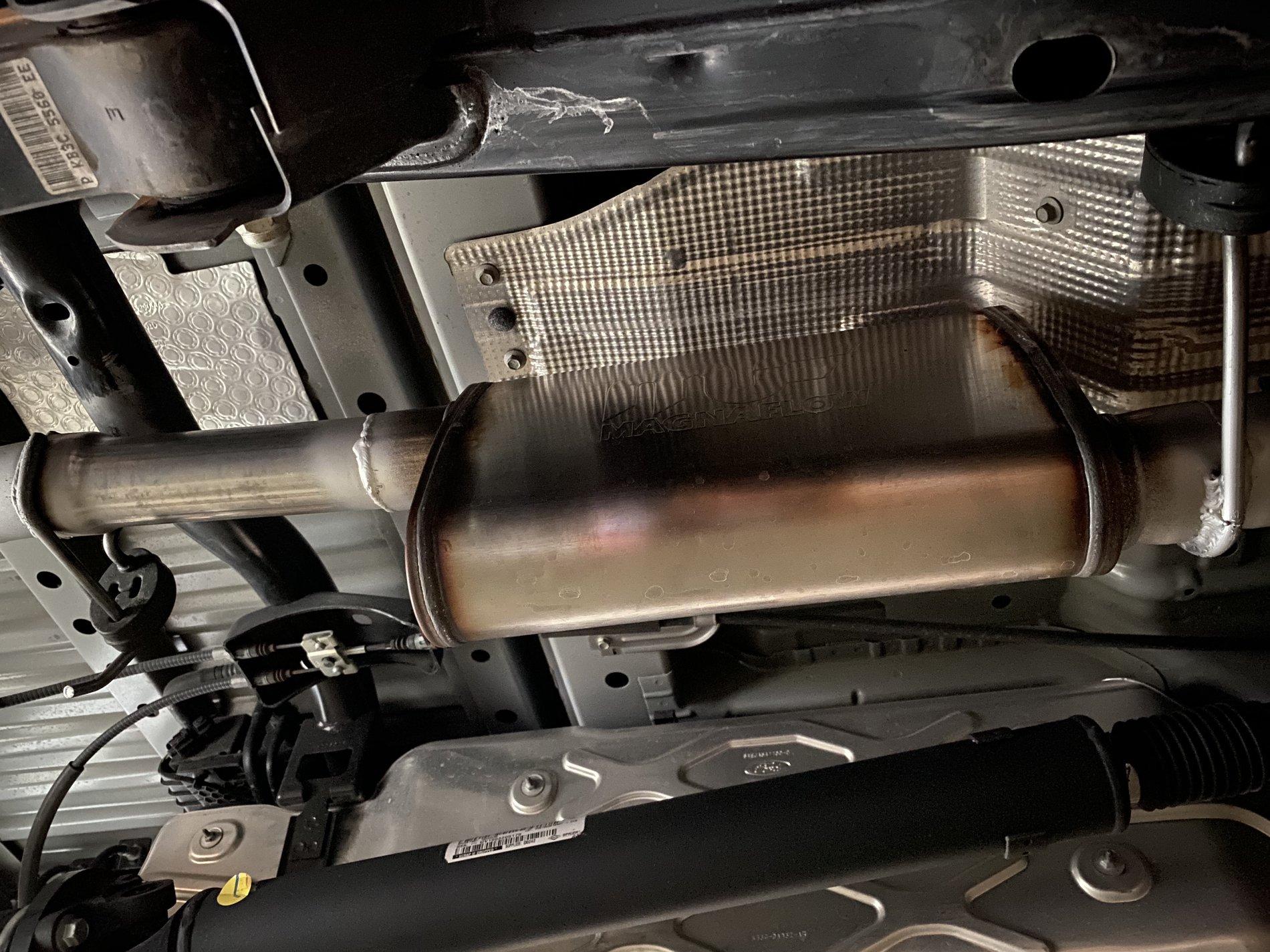

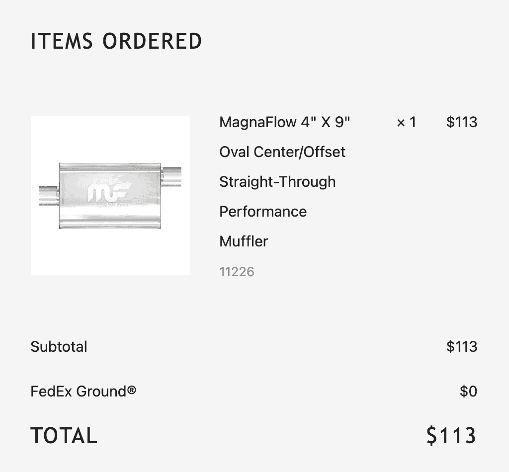

Question for those who have done this mod. I purchased the Magnaflow 11226 14" muffler with the center/offset configuration. Today I stopped at my local muffler shop and the guy told me he thinks it will work much better with the offset/offset version of the same muffler. He showed me under the truck holding the one I bought up to the stock setup and it did look like it would have to be installed at a slight angle to line up with the inlet and outlet pipes. Curious if others have done this with the 11226 or does everyone use the offset/offset? Attaching photos for reference.

I can confirm that offset / offset is the configuration that works best if reusing your stock piping.

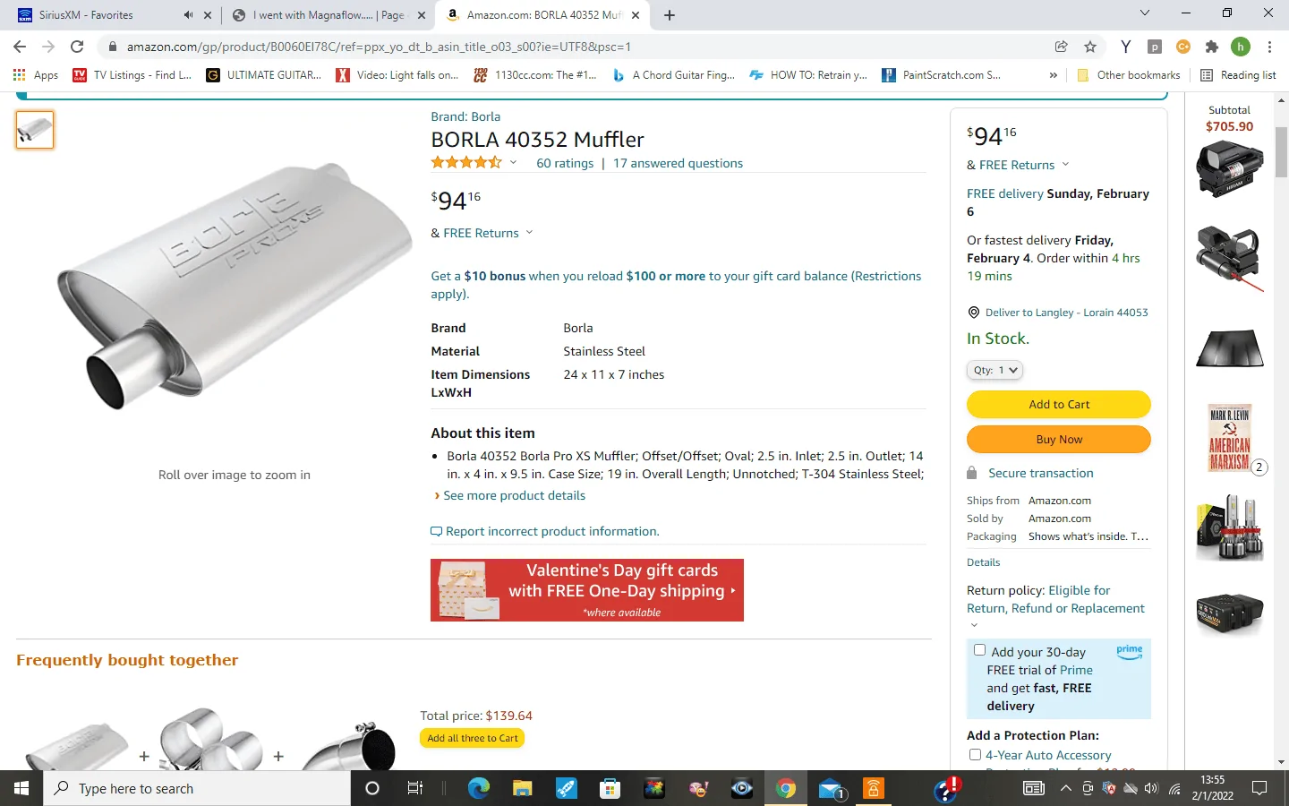

I'm actually looking at a Borla universal due to the 304 stainless steel material... since my Ranger is used in the winter...
I'm going with the "notched" version and will be installing in my driveway when it finally warms up here....
Can some one give me the OE muffler dimensions... Want to verify how much of the OE piping/tubing will clamp to this 19-inch Borla muffler so I can determine which clamps to use.
19-inch length offset Borla muffler > BORLA ProXS Muffler 400484 Notch 19-inch

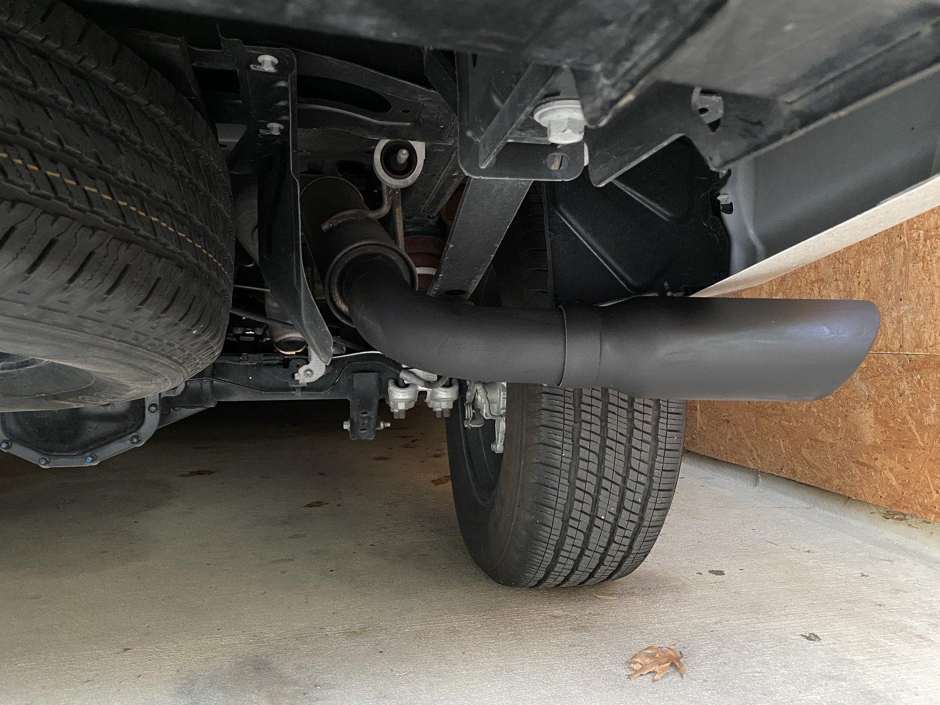

Alright, after reading all the threads/replies and asking my own questions and getting great answers I finally made an exhaust decision. I had my local muffler shop replace the OEM FoMoCo muffler with a Magnaflow Staight Through Performance Muffler. Part # if interested: https://www.magnaflow.com/products/...eroffset-straight-through-performance-muffler Left the resonator, cats, etc. in stock form.
My takes:
1. Sounds nice - very similar to the Flowmaster mentioned in thread: https://www.ranger5g.com/forum/threads/flowmaster-flowfx-cat-back-exhaust-system.4733/
2. I noticed a faster spool Immediately
3. Cost effective - Part is ~100.00 + Labor
4. No drone and minimal change to interior noise while cruising
5. Nice purr at idle
6. Nice growl at WOT
7. I can hear my turbo!
I also painted from the resonator back to match the bolt-on black tip.
