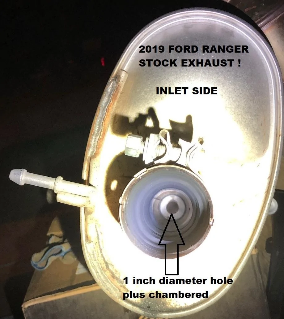

That's what I was saying in my first post. For a good four to six inches before the 1 inch opening, the pipe is perforated. Whoever took that picture claiming the one inch opening didn't see that the pipe was perforated. It definitely isn't just a one inch opening in other words, it has more flow than that.

Okay, I just got a picture of the inside of the pipe where the 1 inch opening is. The perforations run for more like 2 inches of the pipe, not the 4 to 6 inches like I thought I saw yesterday.

Wow...crazy how small that is. Now you have to post some audio of the exhaust! ?

Unfortunately you cannot accurately calculate the the amount of flow those additional perforations just before the reducer plate provide. That's if they even allow flow to pass through and rejoin passing. But looking at this design it is likely more to provide sound attenuation than limit performance.

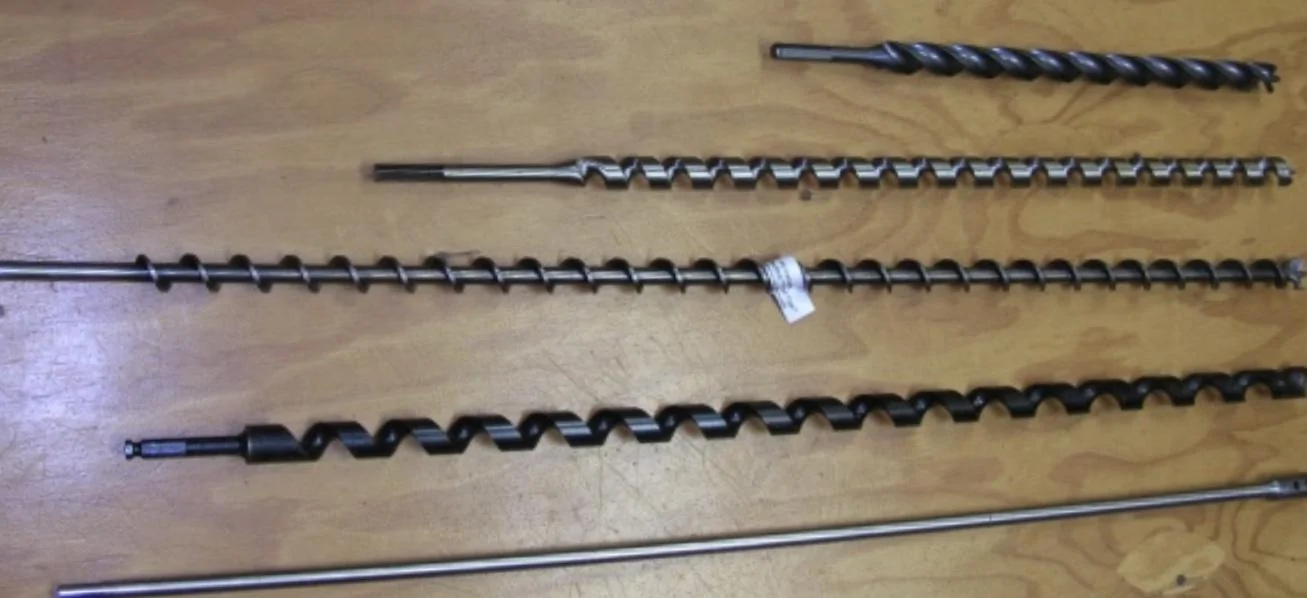

How far in to drill out?

I wonder if it can be punched out? Be hard to fish out, but it might just be pressed in or barely tacked. Lol. Just brainstorming...

What you are trying to do is circumvent the the muffler tuning by altering the blocking plates around the louver tubes etc. Expanding the volume of exhaust into a larger area and reducing the energy of the exhaust for various reason besides customer satisfaction. All vehicles certified for sale to the public must pass drive noise, a Federal requirement... So you get your truck and want to dink with it. Not part of the OEM sales requirement. There are also evaluation drives of the vehicle prior to sale of the public and the vehicle must also comply with these evaluation subjective requirements. The aftermarket exhaust systems are not required to meet drive by noise federally, but by state and local requirements. So you pay your $ and take your chances with local law enforcement. This is in the realm of subjective noise attenuation vs the regulations. It is up to the vehicle purchaser in their respective state vs their requirement. Most home mods with which I have experience sound like the annoying rice burner "tuned" exhausts with a bellmouth exhaust outlet the size of Nebraska. Much like a replication of my momentary fart on a continental basis.

The stock muffler is somewhere close to 24" long and that plate is only accessible from the inlet, however it's all the way at the other end of inlet pipe. Drilling it out might be possible if you use a bit like the ones @Tim H. posted.

I think you'd be surprised at just how good the stock muffler flows. The aftermarket mufflers gain very little performance based on dyno data ... that's a good indicator of how well the stock muffler flows.
Folks are all up in arms about the 1" dia. restrictor. That allows some of the exhaust to free flow through the muffler and it creates enough back pressure for the remainder to be pushed through the perforations. That's pretty much typical for these types of mufflers.
