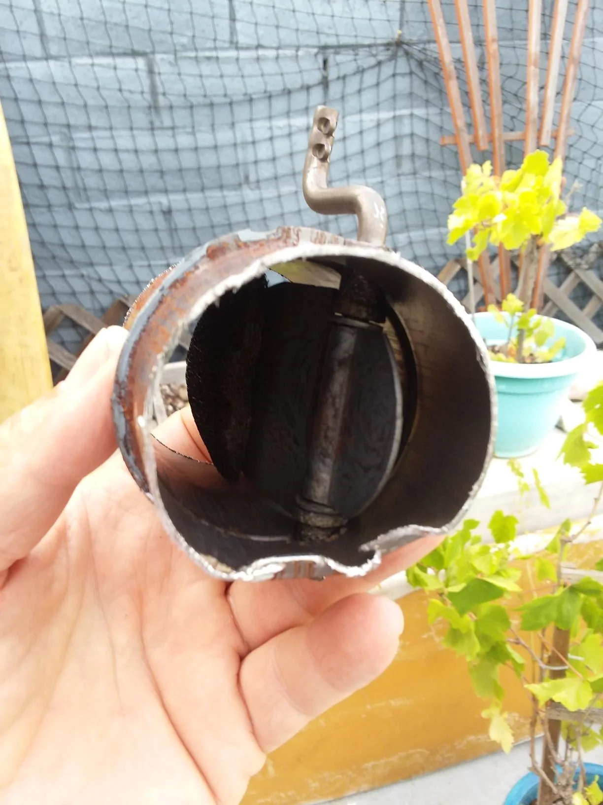

I can never leave anything alone. This is what was in my 2020 Ranger. It had a light spring that allowed the flapper to open. Probably not a bad system.

Where was it located? Near the motor, ahead of the converter?

where was that at? I have looked all up and down my exhaust and not seen anything like that.

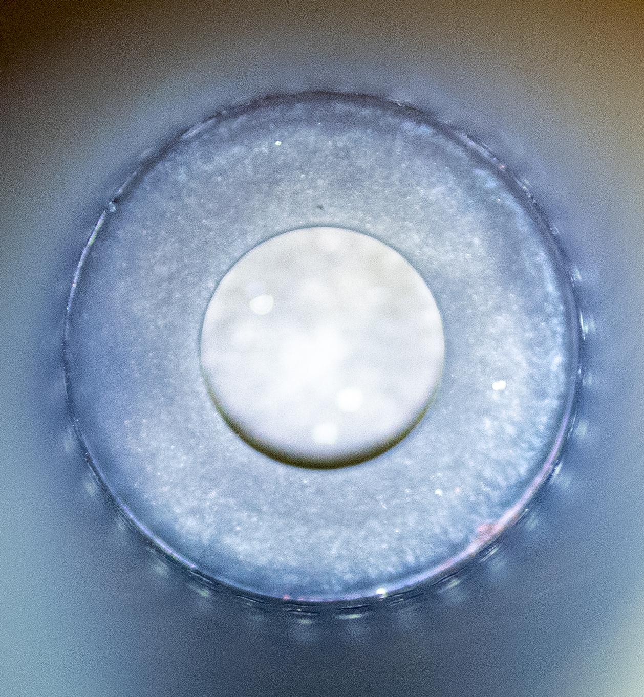

Okay, I just got a picture of the inside of the pipe where the 1 inch opening is. The perforations run for more like 2 inches of the pipe, not the 4 to 6 inches like I thought I saw yesterday.
To hold me over until I do a proper exhaust, I poked mine out with a long piece of pipe. If I listen really closely, I think I hear an ever-so-slightly deeper tone, but it could be my imagination. I guess it's worth a try if you have 20 minutes and a 15mm deep socket.
Sidebar: I was surprised how quiet the open exhaust was. That little turbo and cat are pretty good mufflers all by themselves.

It was inside the muffler. I cut it open after i deleted it

Is there any concern that with age and miles the perforations may start to close up or the spring flapper stop flapping?
