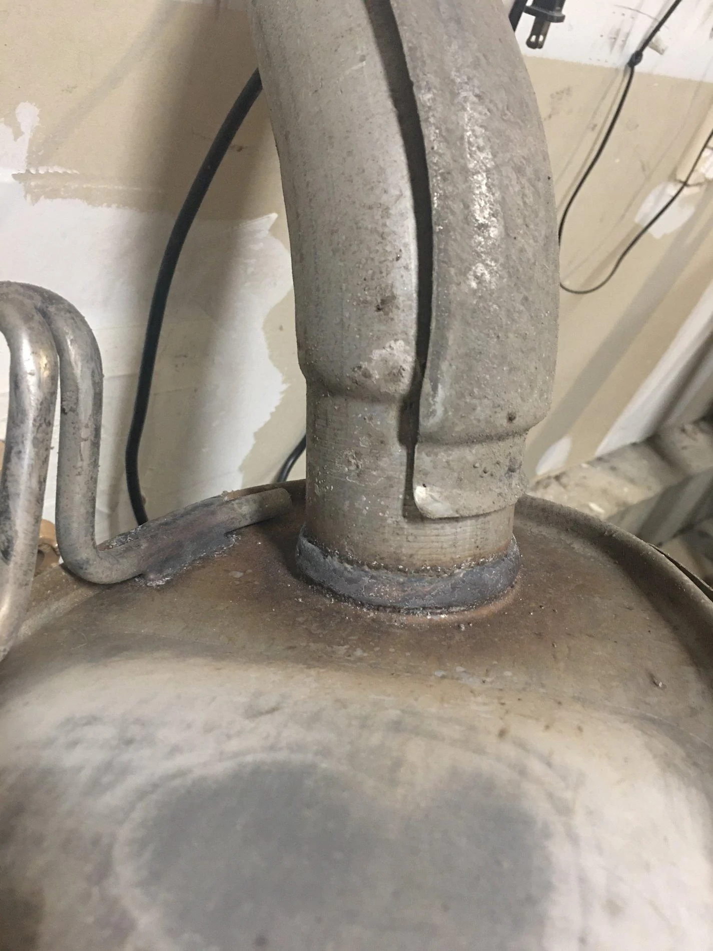

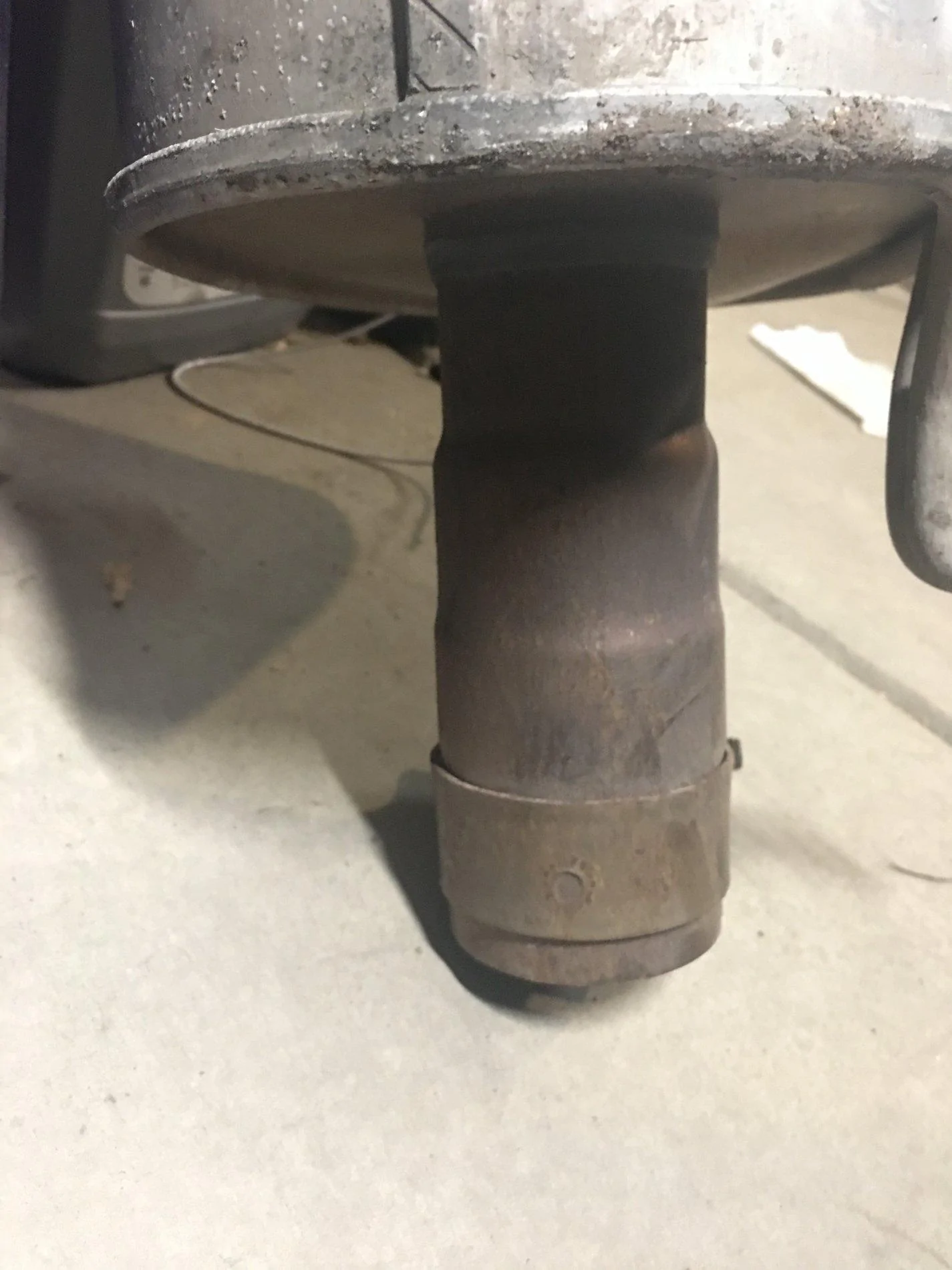

Actual tailpipe exit is 3”. Muffler Inlet and outlet are 2.76” and 3”. They are kind of tricky the way they come out. That’s why I opted for the Apollo. Makes it solid 3” for endless possibilities with a straight through or center in center our muffler.
Adding pictures to show what I mean-
inlet with factory clamp showing how it steps down
outlet showing it’s step out.
you can get away with 3” piping or muffler for replacement, it just takes some messing with it. My 17 5.0 was the same way
Thank you for the correction, I just did a quick tape measure check, my old eyes are not that
great..
Regards
Thanks for the pics.
I just remeasured my tailpipe exit , it is 2.76” ID by micrometer.
My muffler measurements were off as they were cut flush.
Regards

I just knew because I put an old MBRP 3” tip on it before I changed to the AFE setup. I measure it out when I was looking at options! When I did the varex variable muffler on my 17 5.0 F150 I ran into the same thing.
