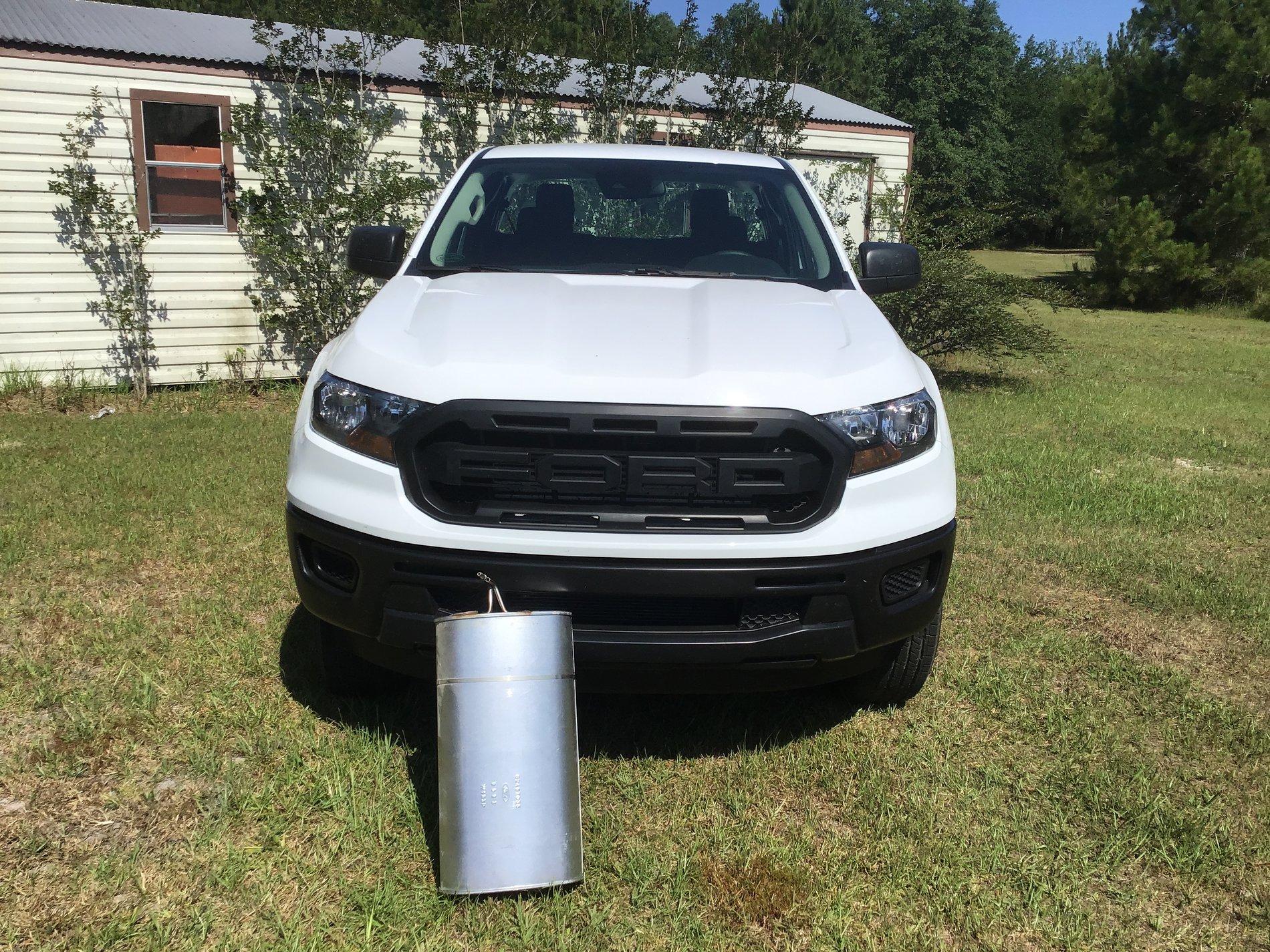

I have yet to hear any aftermarket exhaust that sounds better than the stock set-up.
They all sound, in varying degrees, like a little 4 banger tuner cars exhaust.
And a muffler delete, on a 4 banger, will sound horrible.... guaranteed. Looks like a quality piece though: https://www.stage3motorsports.com/4...-Rebel-Series-Muffler-Delete-Exhaust-Kit.html
But I'd still like to hear a sound clip...
Go to my posts and look for “muffler delete “ it’s around page 10 and (it’s a sound clip) it was the first thing I did..just removed and re welded. ( Mike re posted it ) Pardon the extra stuff it was my first attempt at video....

Doc's 2019 Ford Ranger With Muffler Delete
Me, being a bit "long in the tooth,..... it reminds me of an early 70's Ford Pinto.
Thank you for posting this and Merry Christmas !
Regards
The top one is cold start..
The bottom is warmer.
