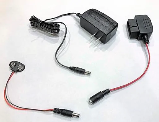

ASS = Auto Start Stop. When active, the BMS eats batteries. Thankfully ASS is on the way out now.
I bought this kit from Amazon. It a bit more expensive, but I wanted the wall wart power supply. You only get about 15 minutes with the 9v battery.
Thanks very much, Tony. I ordered the kit. I should have known what the ASS was. I had that in my 2019 Jeep Wrangler, too. I got rid of "the brick-shaped Lexus" before I had to do the batteries on that crate. Yes, there were TWO.
