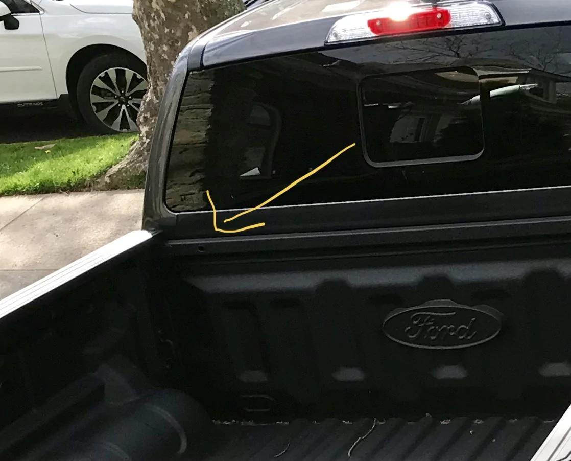

Do they include any additional solvents that may be needed to adhere the bulkhead seal(weatherstrip in front) ?
I have a spray in bed liner

Thanks but I don’t see a rail that’s over the bulkhead. The area in question is in my attached picture. I did call the manufacturer and they told me to turn the weatherstrip upside down and install it on the cover instead of the truck

I have the BakFlip MX4 cover. There is a rail piece in the parts shipped that attaches along the top of the front edge of the box by well nuts utilizing the access holes (one right below your arrow in the picture) to secure the additional rail piece. That brings the top edge up to where the weather striping can be applied to the tail piece to make a secure seal with the rubber on the front of the tonneau cover. Simple and easy. I have the factory sprayed in bed liner as well.

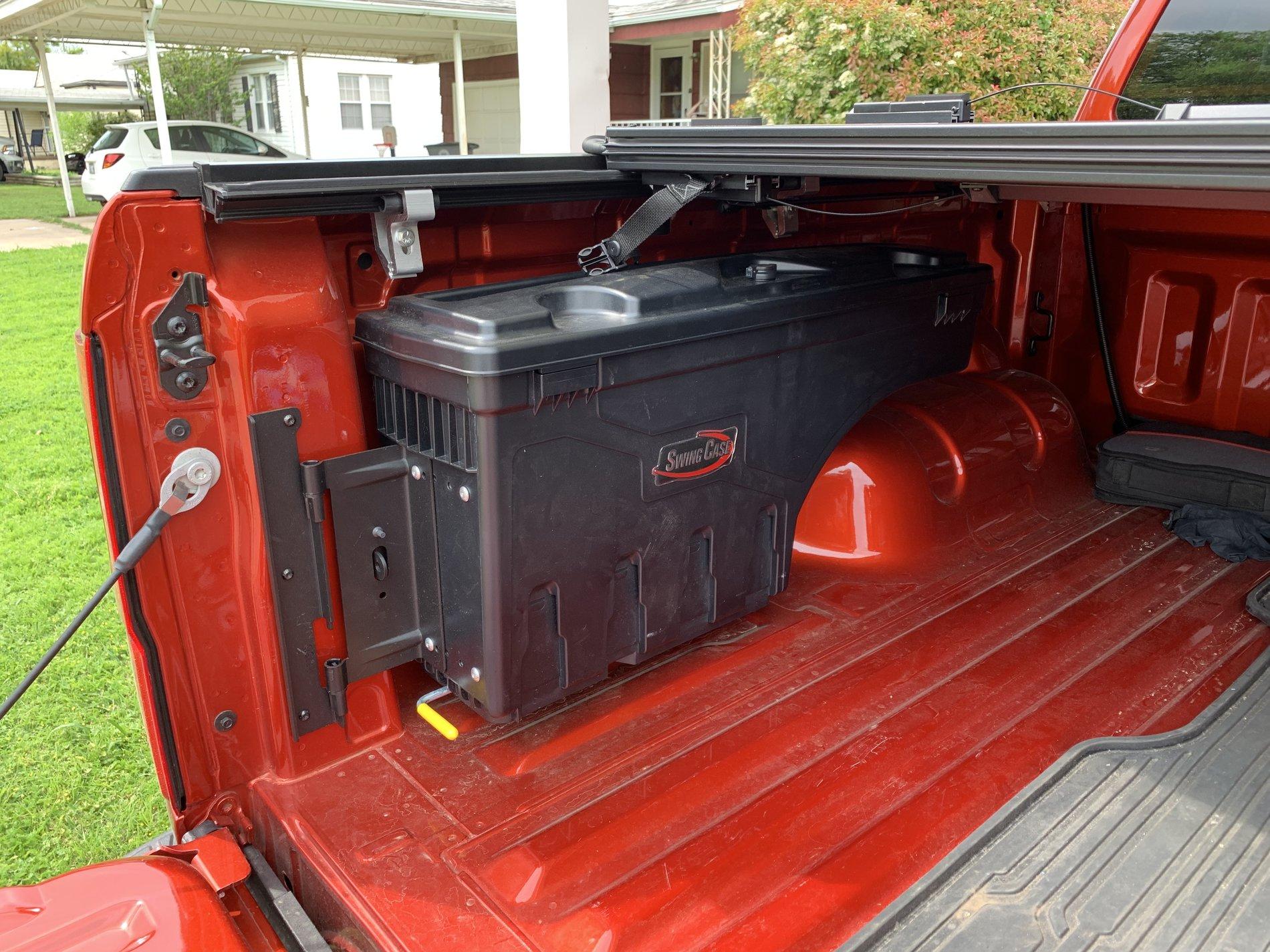

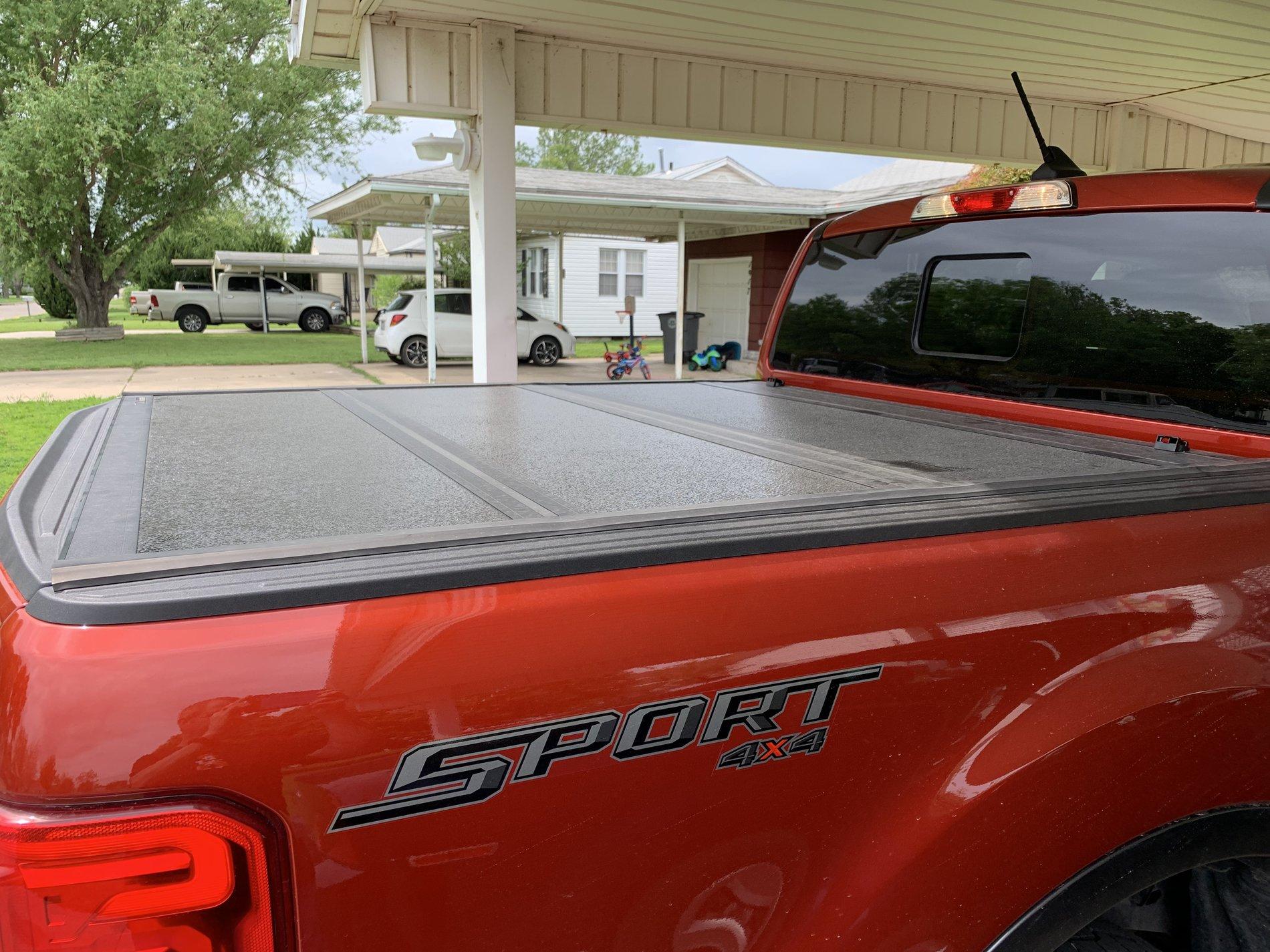

Here is a picture from the inside and the outside with the rubber sealed held up so you can see the top of the bulkhead, rail, and weather strip. This is on the Undercover Flex. The rail mounts just like @MRAces said his Bakflip MX4 mounted. Undercover and Bakflip are both made by Truck Hero so they probably use a lot of the same parts like Chevy and GMC do on there trucks.
