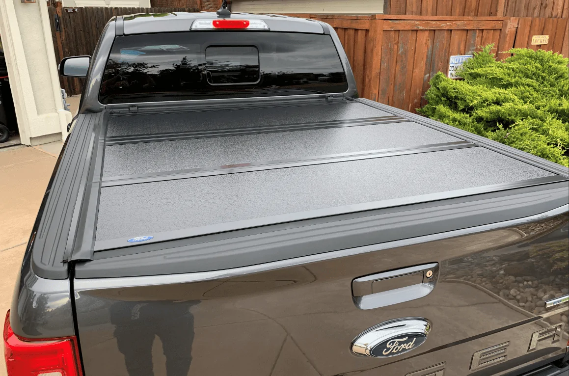

I ended up letting the dealer install the cover. It took them 3 hours and I had to adjust it when I got home to align everything. Not a great experience, but it's done and installed. I do like how flat it sits over the bed.
I'm not sure which model I have, as mine has a Ford part number on it.
SRAces
Oct 17, 2018
329
627
Lake Park, GA
2019 Ford Ranger, 2015 Mercedes-Benz GLA, 2004 Mercedes-Benz SLK 230 Special Edition
USAF (retired)
Looks great! Just remember with that cover to close the tailgate first before closing the back panel to keep that trailing rubber seal from getting banged up. ;)

Thanks, Yes, I did read that As others have already reported, when its in the folded position with the straps connected, it can bounce up against the back window / third brake light, which isn't good. They provided some small bumpers so those hit the brake light, but kind of lame design.
