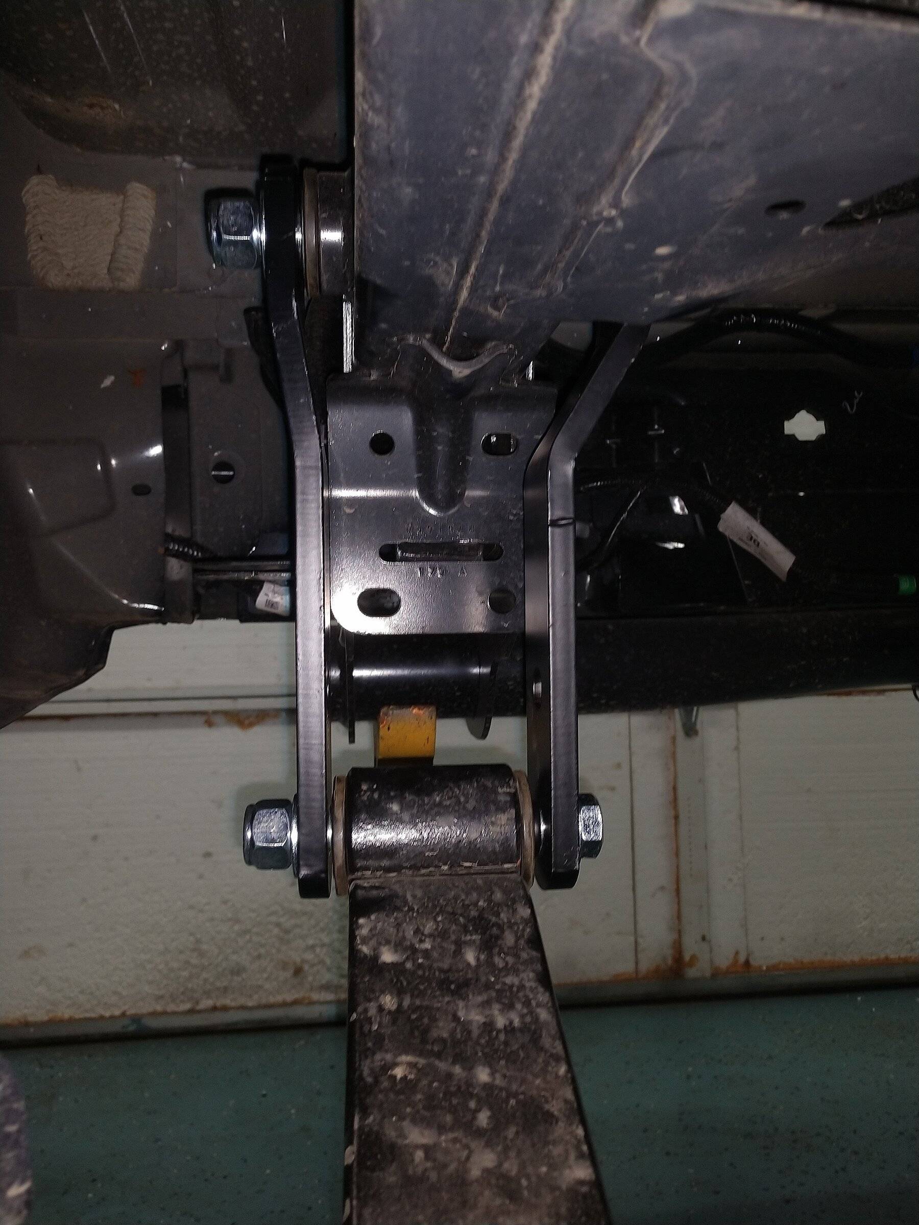

I only know of the 4" flip rear drop...
Actually with stock shackles an axle flip gets you a 6" drop. The 4" drop uses extended shackles to get back to ONLY a 4" drop.
Indeed, that's what I have on my truck. I thought about the 6" drop, but I think that'll be too low in the rear, compared to my 3" drop in the front.

He's correct. With the Belltech Rear Flip Kit, using the stock rear shackles in conjunction with the axle flip, will net you the 6" rear drop.
If you use the extended shackles that Belltech sends with the kit, you have the option between either a 4" or 5" drop. I'm using the lower hole, which should be the 4" drop, but measuring the gap in between my fender lip and top of the tire, measures 4.125"

well if that is the case, could one not have even longer shackles made to get less drop?

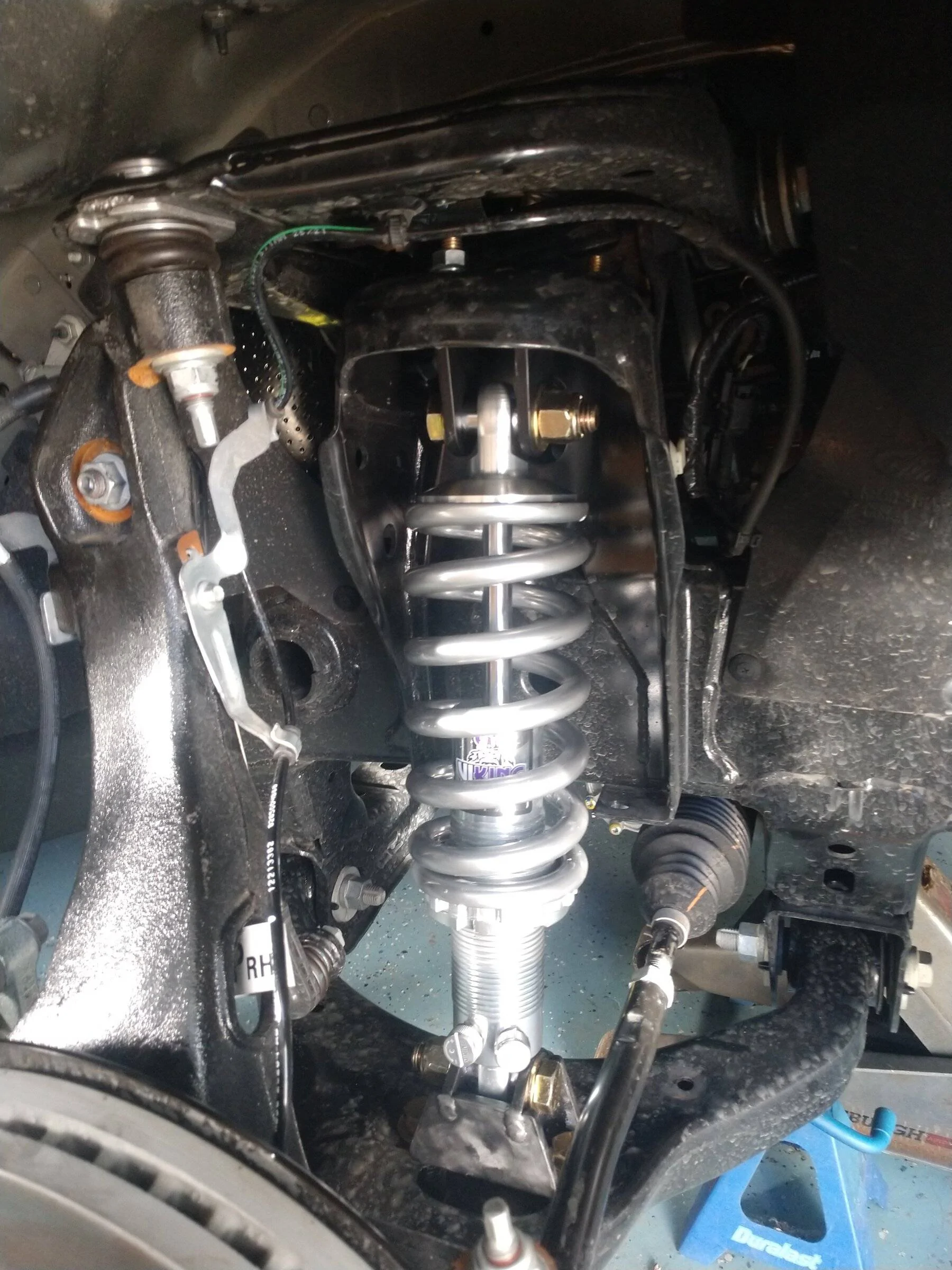

I guess so, but you'd have to get something custom made I would assume...? But, by that time, you might've spent $1000+ on them... If that were the case for me, I'd just get the $2500 rear coilover kit from Control Freaks and adjust it to whatever height I wanted it?
Definitely not advisable. Shackles have their place, and more importantly, their limit. I'd let the engineers do that kind of stuff.

HOW BAD IS THE INSTSALL ON TH FREAKFIDE COIL OVER?
I don't think the rear's that difficult, you just have to weld a few new mounts in.
The front is all bolt in and I thought it was simple.
