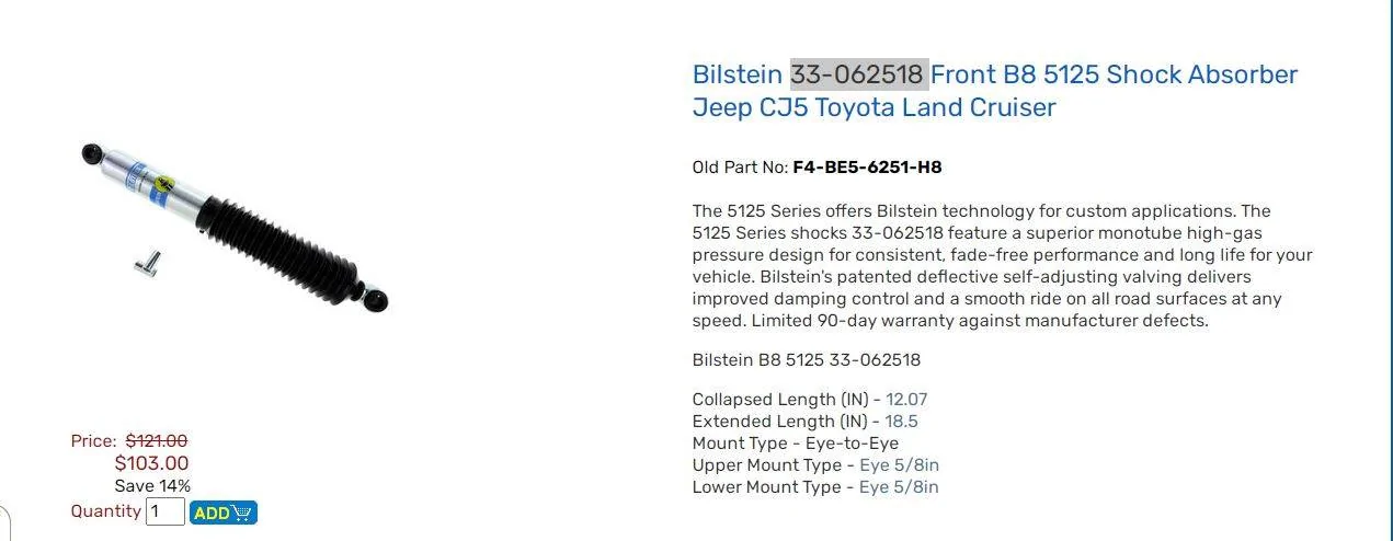

I've been toying around with the idea of a replacement rear shock. No real problems with the Belltech shocks, but I'm an unashamed Bilstein fanboy.
I took the measurements with the 4" rear drop, and it came out to appx. 16" ride length, 12.5" compressed, 18.5" extended, 6" stroke.
Searched Bilstein's catalog and came across the B8 5125 in part#33-062518 which is a nearly perfect match. Only thing that would need to be addressed is the eyelet sleeve size. Our's is 12.7mm and B8s are 5/8". Pretty easy workaround.
Also this part is for the 1975 Jeep CJ5 which has several more options including an air shock from Gabriel part#49310
I've took the measurements with the 4" rear drop, and it came out to appx. 16" ride length, 12.5" compressed, 18.5" extended, 6" stroke.
Let us know how it turns out.
On that note, how do you like the ride of the Belltech kit now that you have owned it a while?
