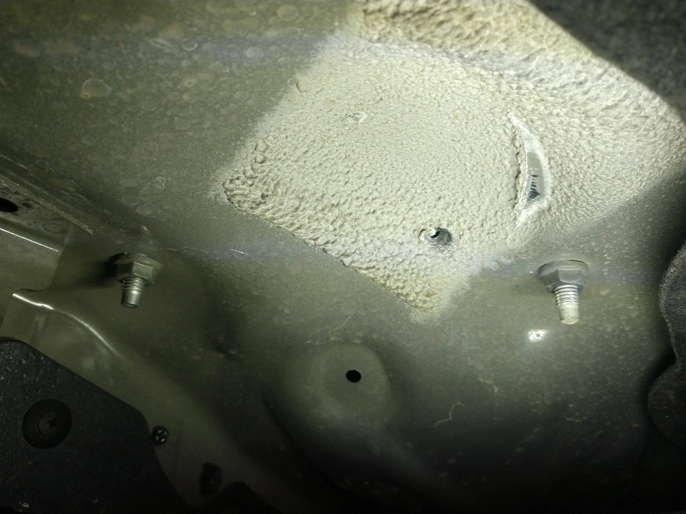

I've been "bottoming out" on certain hard dips/bumps around town at speeds of 40+ mph. At first, I thought it was because of the bolts being too long, that hold the ball joints to the new adjustable control arms, but that didn't "fix" all of it.
I then adjusted my coilovers to the "performance" setting on the compression and rebound knobs. Thought that fixed it, but it happened again a few days later.
Then, tonight, when I had the truck on jack stands, I got a good look inside the wheel well area and noticed this:
The new control arms are making contact with the top of the wheel wells, on both sides, but the pass side seems to be worse...
I'm thinking about installing a 3/4" H x 2" W Universal Bumpstop in the area of the pic above, to see if that would "fix" things? What do yall think?

Well, that’s one problem you don’t have when lifting.

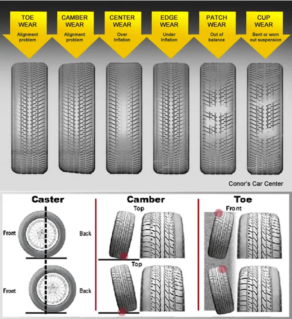

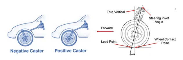

Toe is what eats up your edges of your tires. I was able to get toe and camber back in spec with the 2" drop on stock control arms, but my tie rods and control arms were about maxed in. I have almost 8000 miles on my drop with 1 tire rotation and noticed no abnormal tire wear. You should probably get your alignment checked out.
Toe and camber wear are different.
Camber is typically say 1/2 the tire is worn, normally the inside from negative camber.
Toe is typically the outside edge of the tire, say 1-2", from a lot of toe in. Toe out wears in inside edge, but again only 1-2".
I prefer toe in and negative camber.
^ General statements
