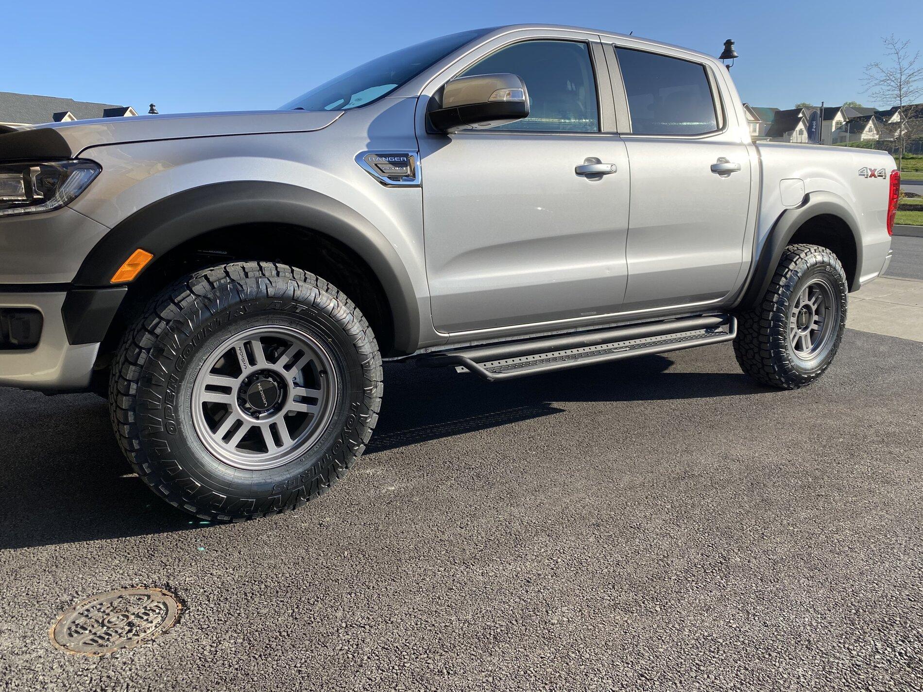

I've had my 34 (33.9 285/75/17) Toyo OpenCountry AT3s (C rating ones not E) for a little less than a week and I'm impressed. I haven't noticed a dramatic loss of power (if at all) but I do mostly highway driving during the week. Weekends I try to go off the beaten path and they've performed great. The stock tires were terrible.
What I was really surprised by was the MPG hit, I'm getting less than a 4 mpg difference and most of the time its like 2 less or so. I do think if I went with the E rating which are a bit heavier it would have been worse. I think the C ratings are a good compromise, albeit hard to find. I'll post some pictures when I get home. Been meaning to do a show case...
