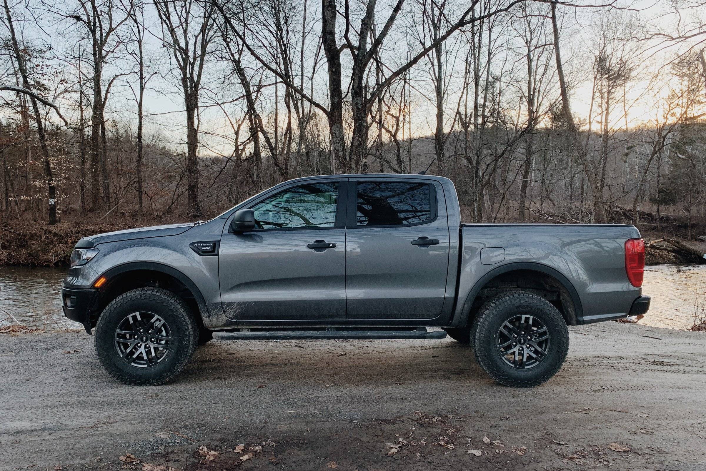

Keeping this thread alive, even if it's just for fun at this point. Team 33 for about a month and loving it so far, no plans to go smaller any time soon. Initially had a tiny bit of rubbing on the little plastic covers full lock in reverse. Removed the covers and all is good.
Anyone running 255/80/17 with a 2" front level AND wheel spacers? Don't really want to tempt fate but even a 1" spacer would look pretty good I think.

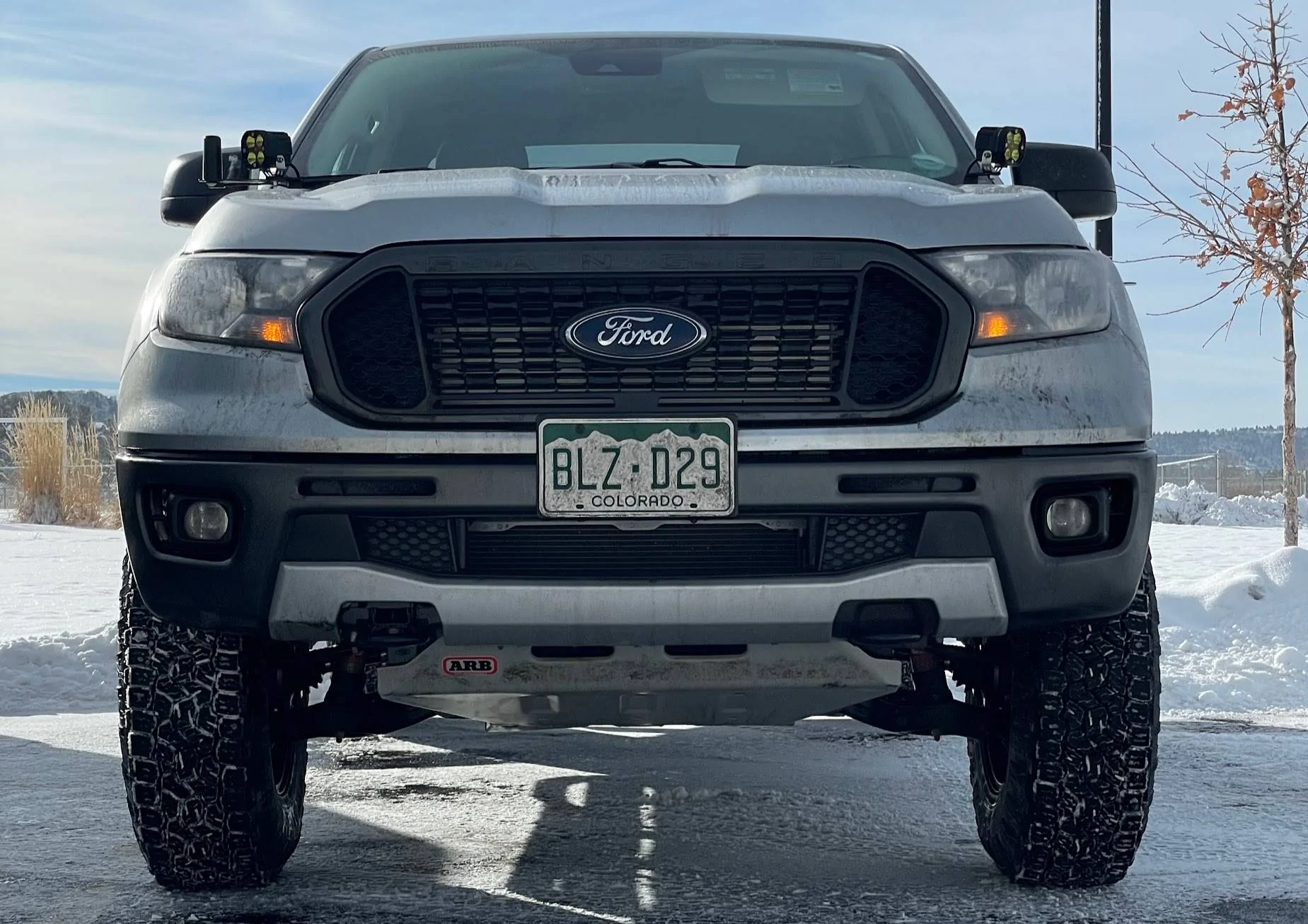

I have the 255/80r17 Toyo ATIII and 1" wheel spacers. Tiny bit of rub once. Though my front crash bars are gone now because I have a winch and bumper.
Killer! Any more photos?

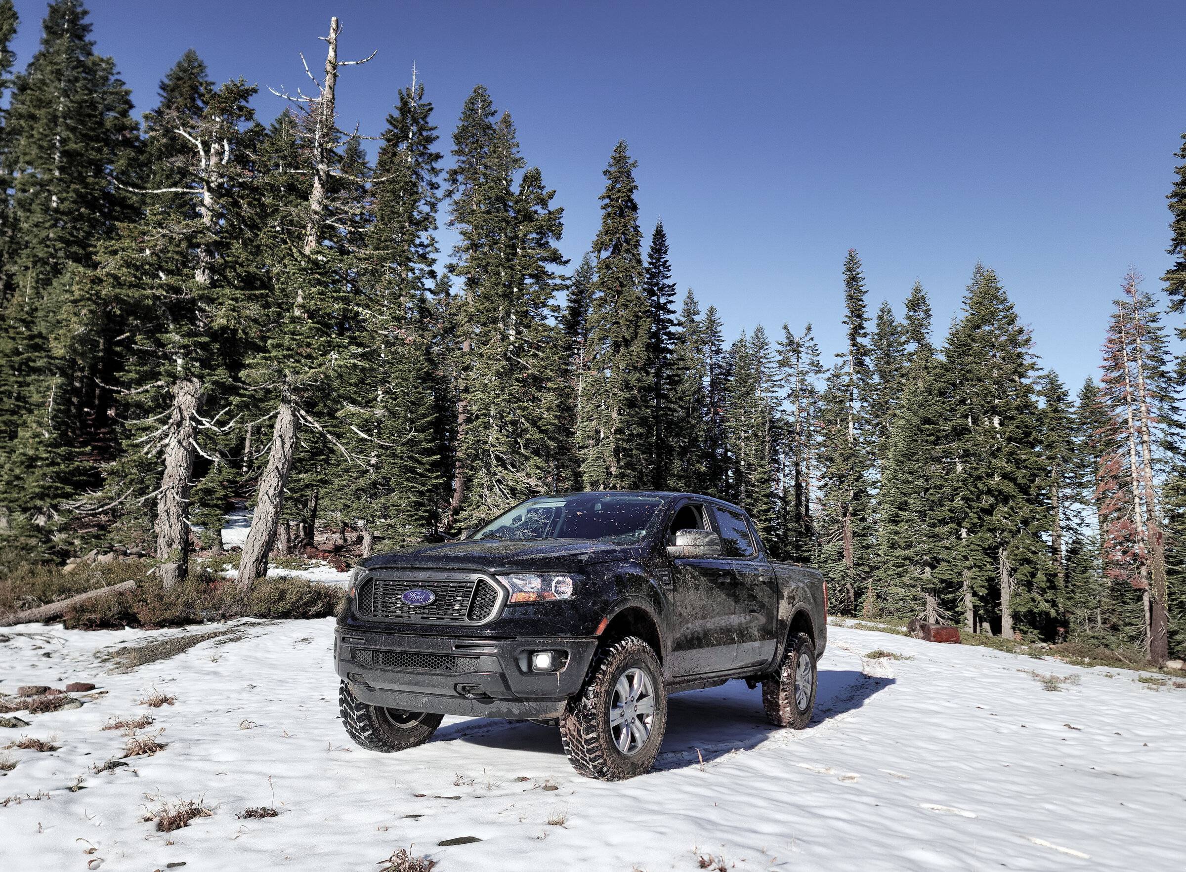

Hey @hogsrear I ran 255/80R17s, a 2" level and 2" spacers for about 20K miles. Had some vibration at around 75mph but I LOVED the stance.
Since then I put aftermarket 17 inch wheels on with +18 offset, which brought the stance in slightly narrower, but I plan on buying wider tires when or if I finally wear out the Cooper MAXXes.
Here's how it looked with the spacers.

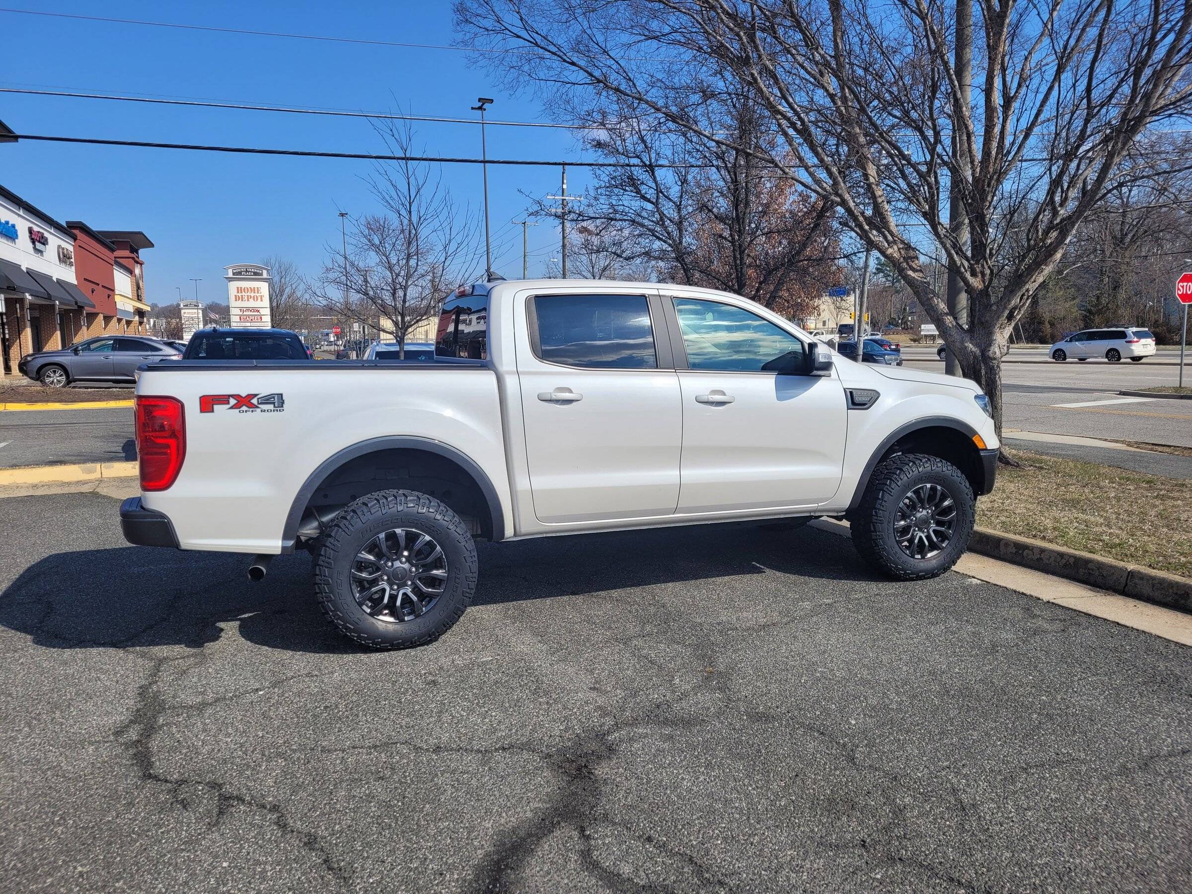

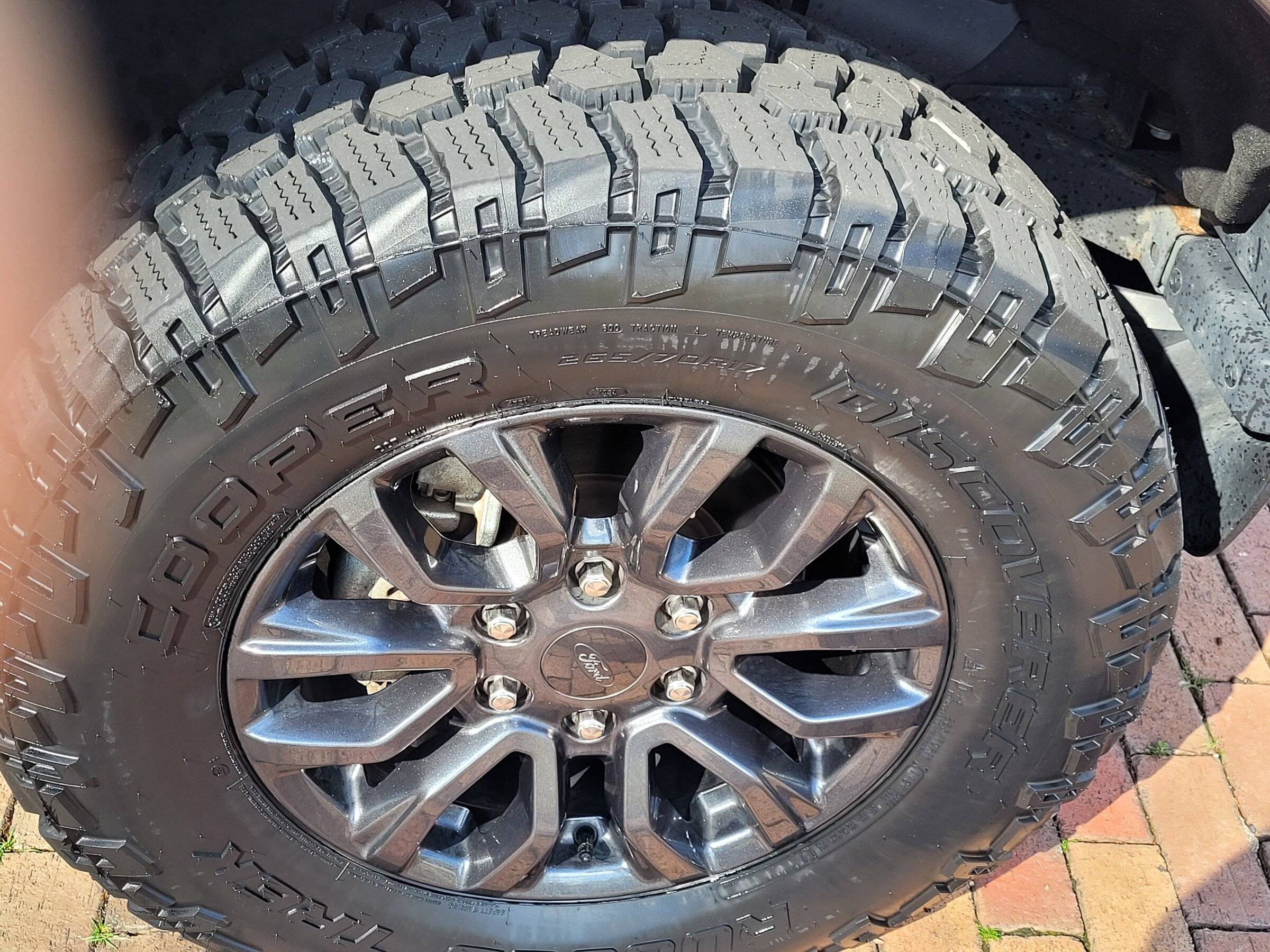

I really wanted to do 33" but thanks to all the forum members posts I went with a 31.9" tire Cooper Wild Trek 265/70/17 with Eibachs at 2.5" and Icon UCA. Dropped about 2 mpg but very happy the results. Thanks to all here helping me figure out how far the lifted truck rabbit hole I was willing to jump down.

Looks awesome, that's what I wanted to see! No mods to the crash bars?
