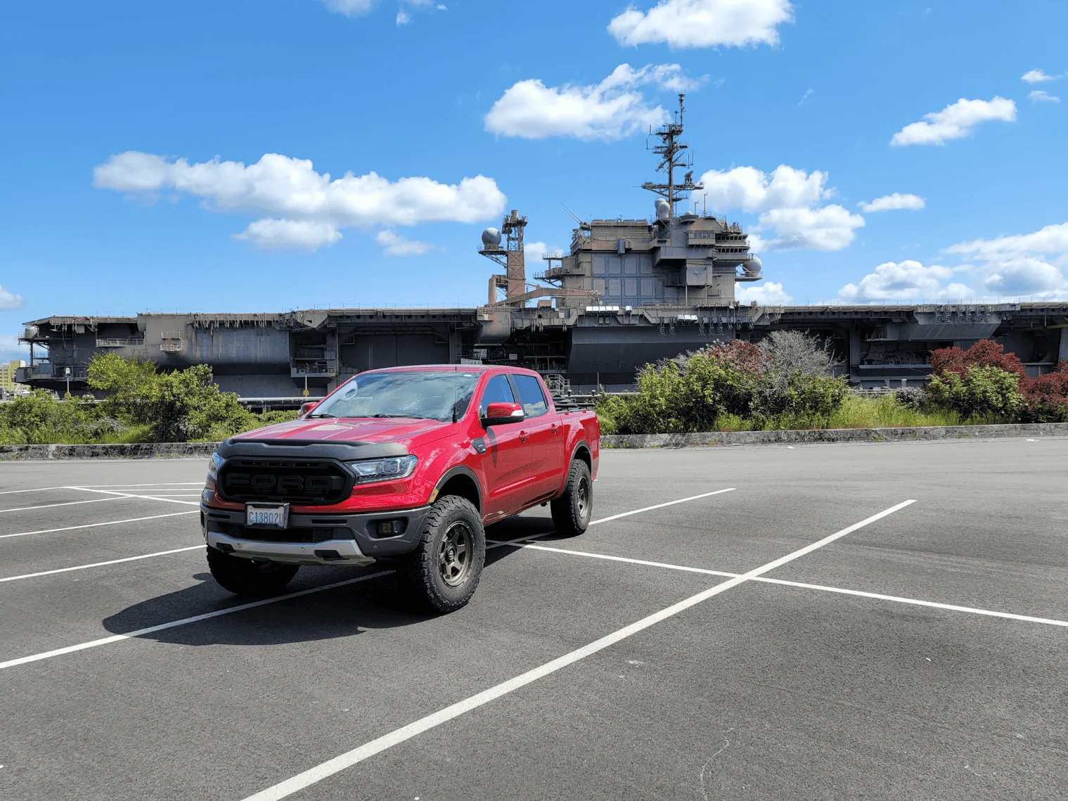

I bumped up tire size from 265/65 Hancooks to 265/70 KO2's
- MPG dropped from 22~23 to 16~18.
- I was pretty pissed. If you look at my other threads on here you can see me kinda poking that bear here to see if that was normal and if not, what to do about it. I've reconciled with it now but I was unhappy.
SECOND
I got the FPP tune. Now at 310 HP / 370 Torque (+/-)
- MPG improved a bit to 18~19 on highway or off
- off-the-line that HP/Torque improvement is very noticeable, as is the MUCH improved shift schedule
- but there was definitely an upper limit I kept hitting at speed. Hard to explain.
THIRD
I upgraded to 33in KO2's
- MPG variance changed more. Off-road I'm at 15~17 MPG. On highway (not climbing mountain passes) I'm around 20~22 MPG now.
- Overall drivability and handling much improved.
- the upper limit I was feeling before is largely gone. Pretty sure I was just hitting gearing limits with smaller tires. Tuned motor likes the bigger tires better.
I'm never going back to anything smaller than 33's on this truck. I might go bigger.
I also got a throttle controller from Pedal Commander. In town, in traffic, or on snow the eco mode get's used a lot. I almost never use it for anything but that. With the bigger wheels speed modulation is tougher, eco mode on Pedal Commander makes that more manageable. I def don't need Pedal Commander giving it more juice, faster. Turbo lag makes the value of that pretty non-usable in my opinion.
Unclear if I will go bigger still, but I might. It would def benefit from a brake upgrade. I notice brake modulation has suffered a little, which makes sense. If I go bigger than 33's I'll also upgrade the brakes. But I'm never doing less than 33's on this ever again.
I bought this truck new July 21, 2020 with 3 miles on it.
Today May 05, 2021 I have 23,309 miles on it, 9~ months later.
I'm not driving it professionally. It's not part of my job or my job description. I work from home. Those miles are fun miles. All of them. I like this truck. I like driving this truck. I'm driving the shit out of this truck. And I'm paying attention to this truck.
https://www.instagram.com/radiotrucksquad/
Get the tune.
Get 33's on it. Or get 285/70 R17 on it, which is pretty close (that's what I'm doing here).
I don't think you'll (or anyone would be) disappointed.

What’s the specs on your wheels? I also have a rapid red- I think the bronze looks good on them.

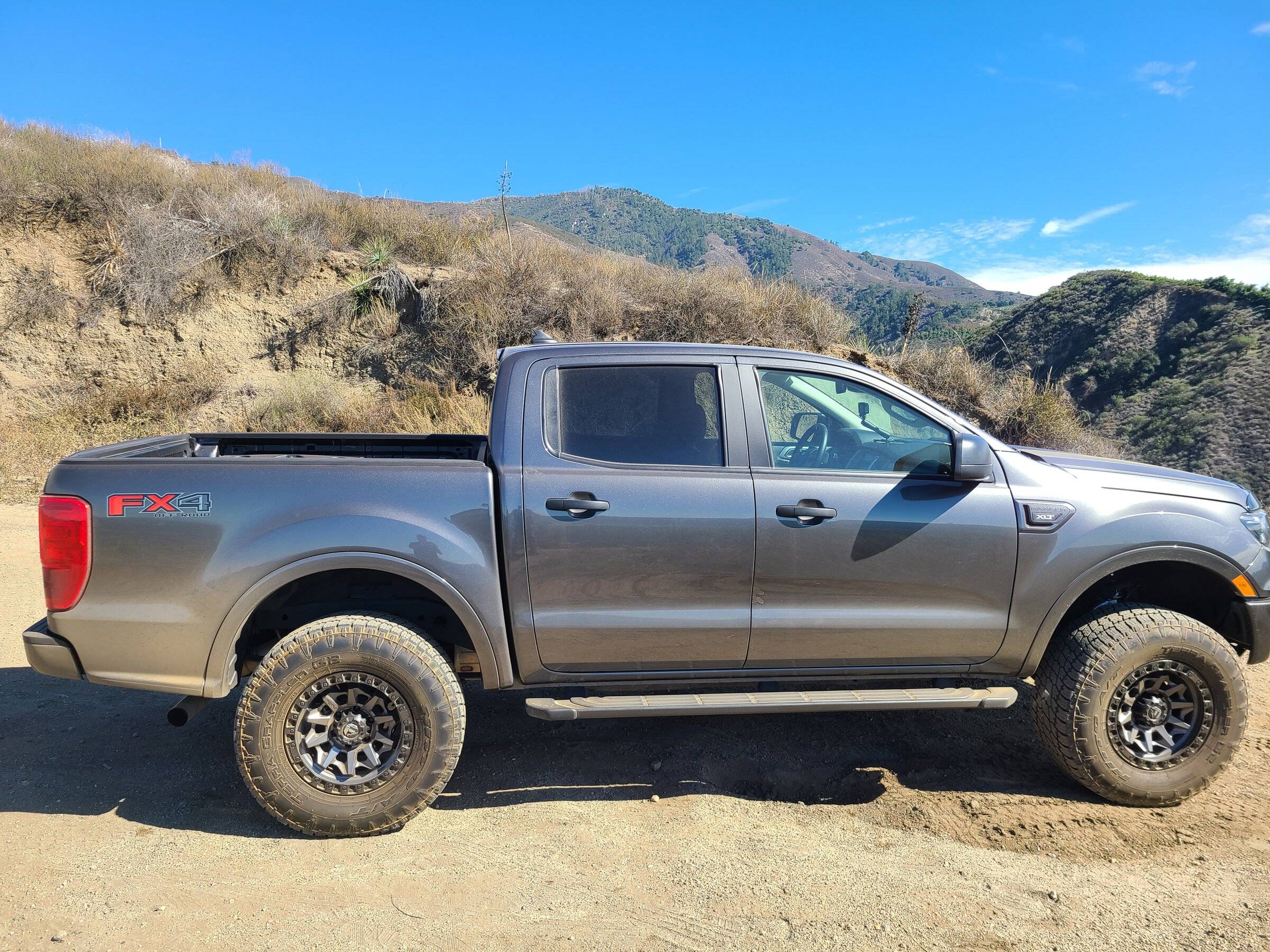

So I just replaced my Bridgestone Dueler Revo 3's(265/70-17) with Firestone Destination XT's(285/70-17) yesterday. I already have the tow tune From Livernois and that helps overall. Due to the speedometer beeing corrected I noticed my PowerBand took a small hit. I had a tire at 40 lbs each and now at 50 lbs each.
Getting up to speed? No real problem.
Holding speed? Well I have noticed it helps to keep a lower gear in certain situations.
Offroad? It does very well and I feel is just right with the Old Man EMU lift kit(I know most get annoyed when I mention it but it is true).
Do I feel regearing may help? Yes I do but unfortunately there are no kits for the front at this time that i am aware of.
Hope this helps

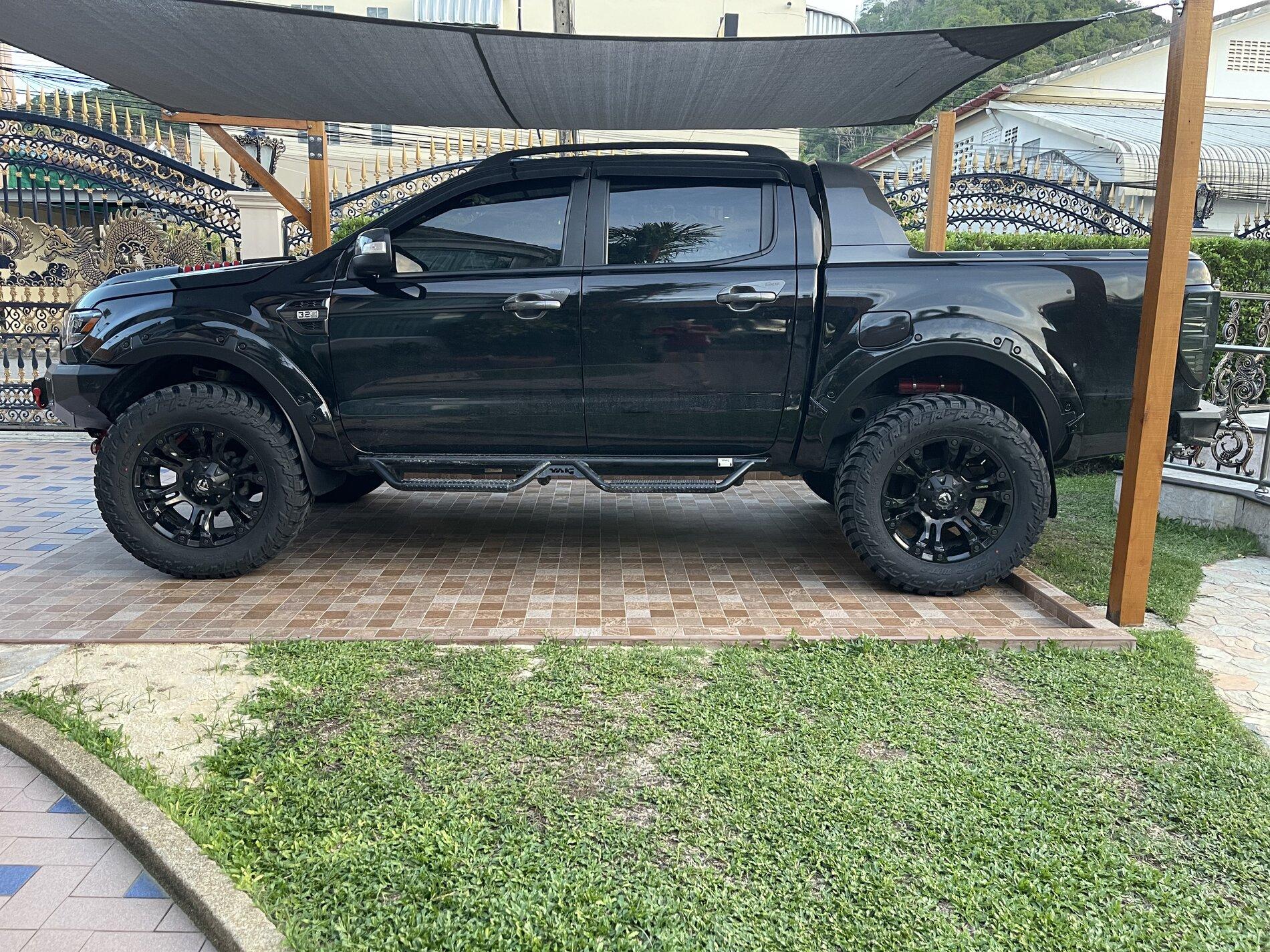

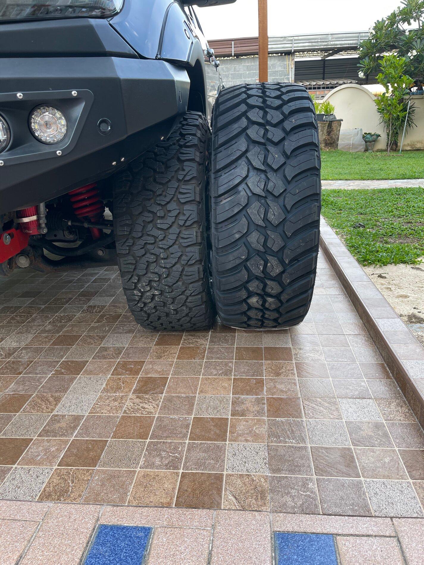

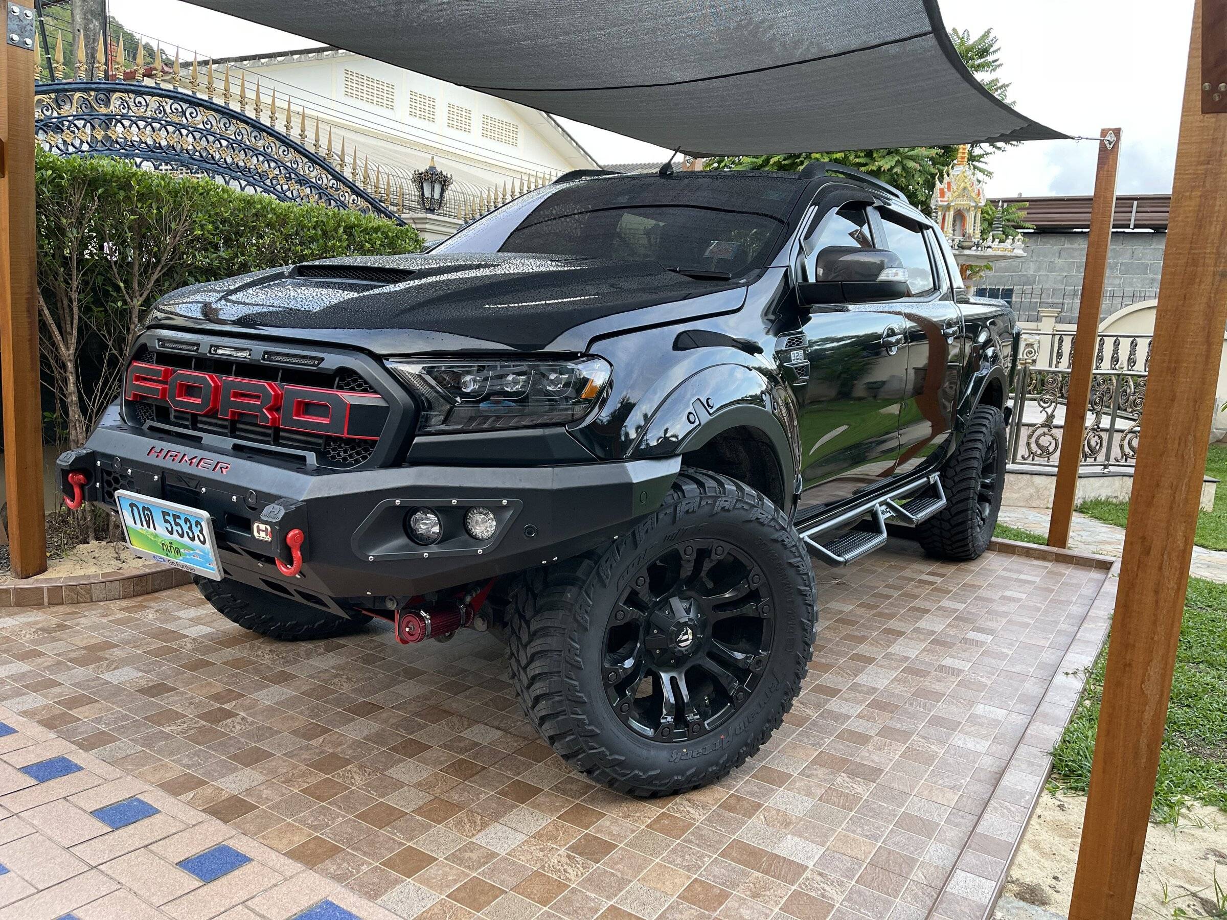

I would only go with the 33's as a stop gap before putting 35's on............we have a saying in thailand about having 33's....................translated into english means "big body short legs"
