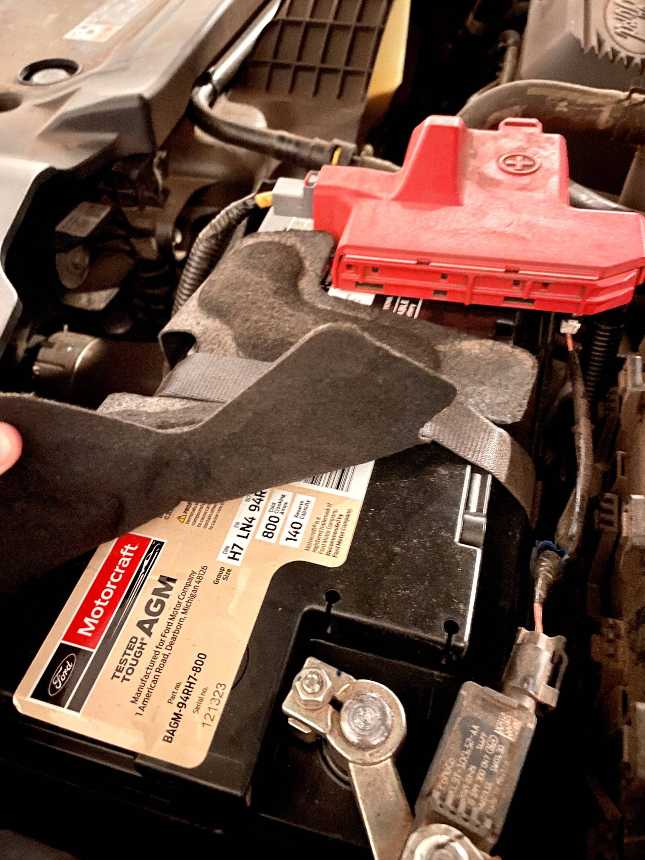

Took it right to the dealership and the techs and I tested my battery/alternator. Instantly their battery tester lit up red and displayed the battery bad message. The OEM lariat battery is rated for 800CCA and the tester registered close to 500CCA so that confirmed my suspicion. Testing the alternator we registered a 14.98 - 15.00 V on the terminals and we concluded this was rather high. The technician mentioned maybe I have a bad alternator, but I had another hypothesis. My hypothesis is that our battery management system was overcompensating for the bad battery and that was the likely cause of the high voltage reading. For now my hypothesis looks to be correct; after replacement it registered a nominal 14.30V reading.
My Ranger is a 06/19 build date so I think almost 5 years out of the OEM AGM battery is nothing to scoff at...We replaced it with a Motorcraft BAGM94RH7800 AGM battery with a 36mo warranty.
Lessons Learned:
  1. Ensure the technician actually plugs up the front connector (grey) back to the positive terminal box or else you will get a power steering dash light ?
  2. Ensure the technician remembers to reset your automatic windows or else you will be stuck back in the dark ages where you have to hold the button for it to roll up or down all the way (Going back to the dealership tomorrow to get them to reset that free of charge)
  3. Pay attention to any weird warning messages, it prevented me from being dead in the water this go around. ?
