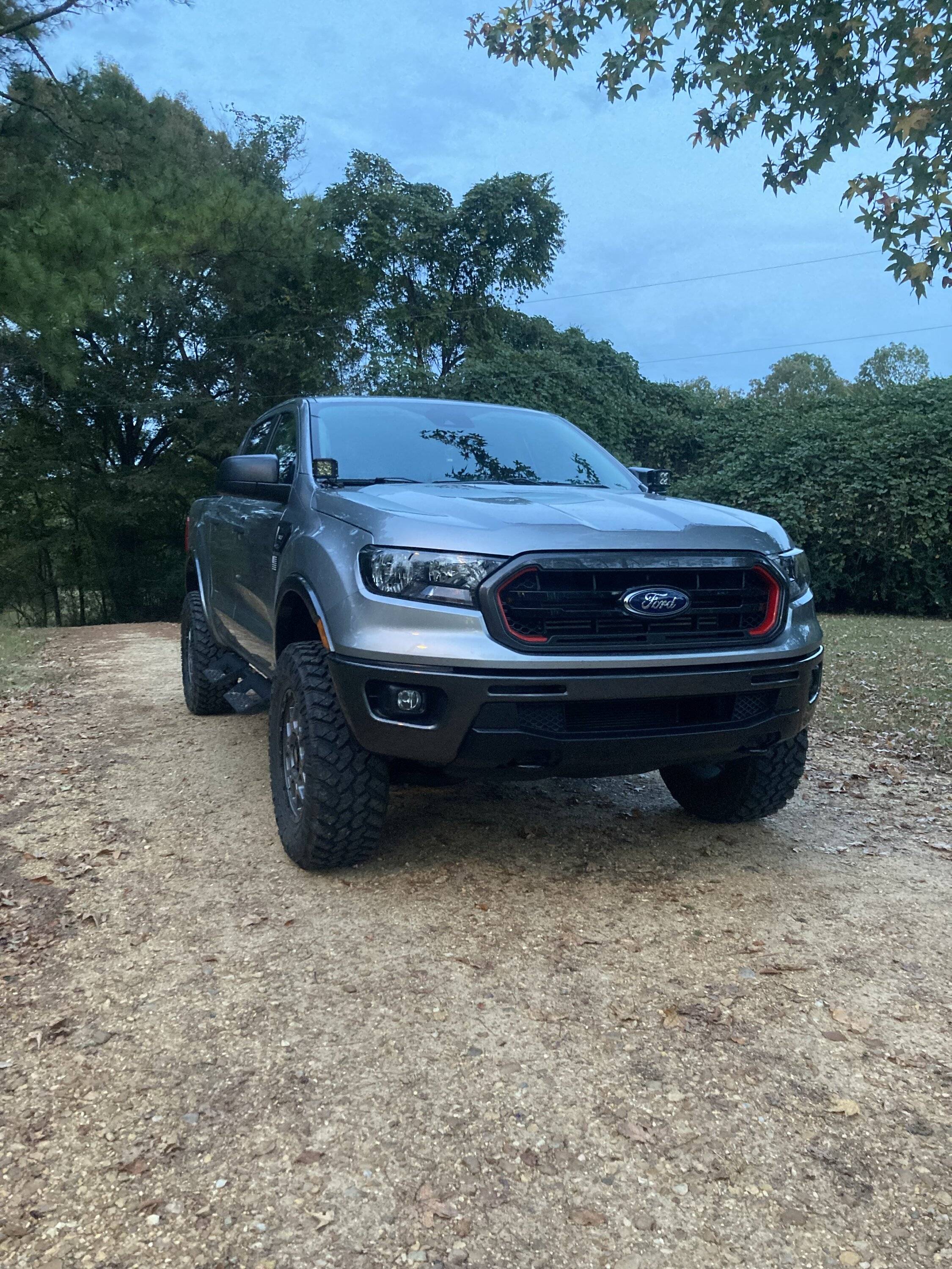

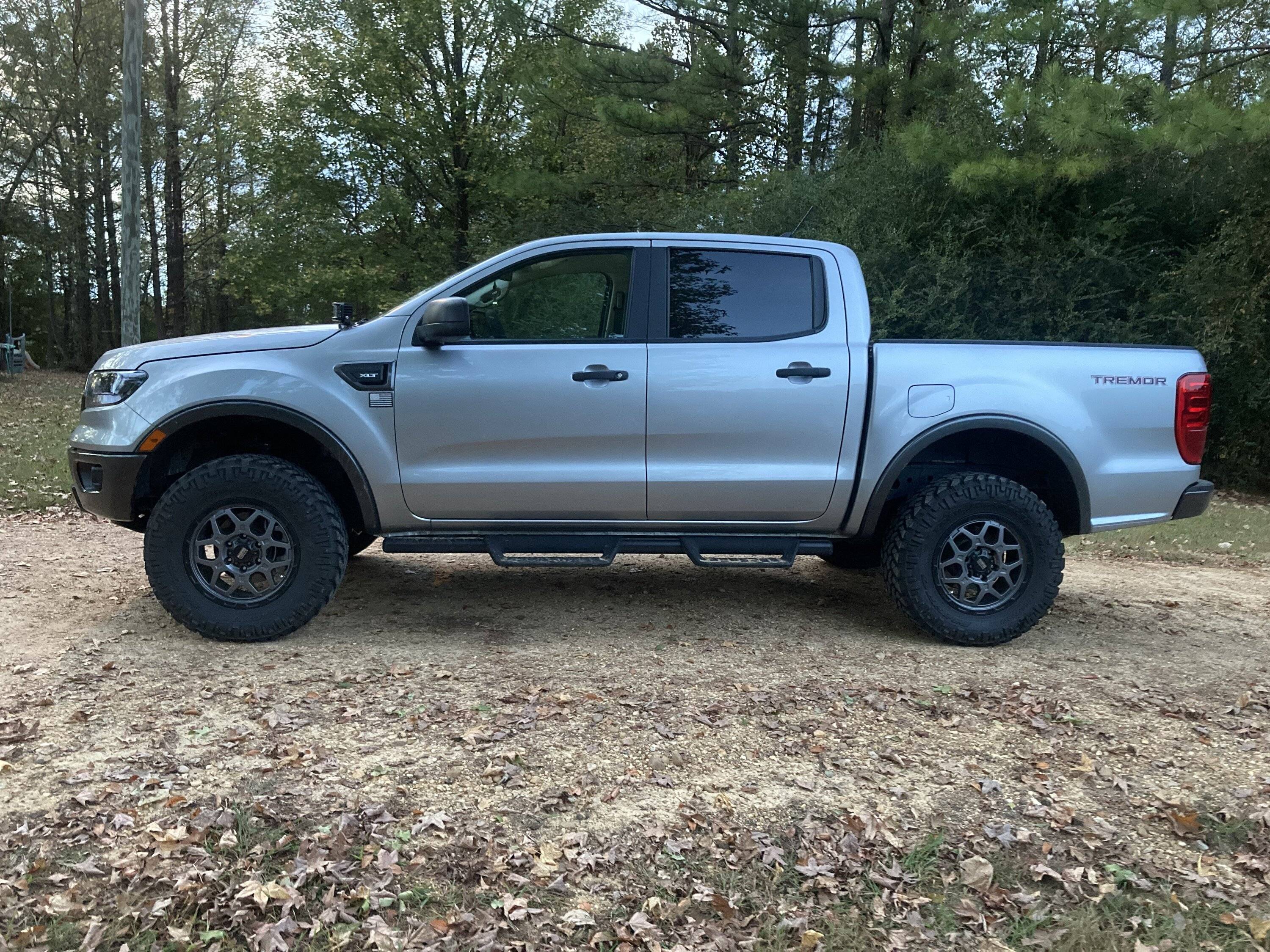

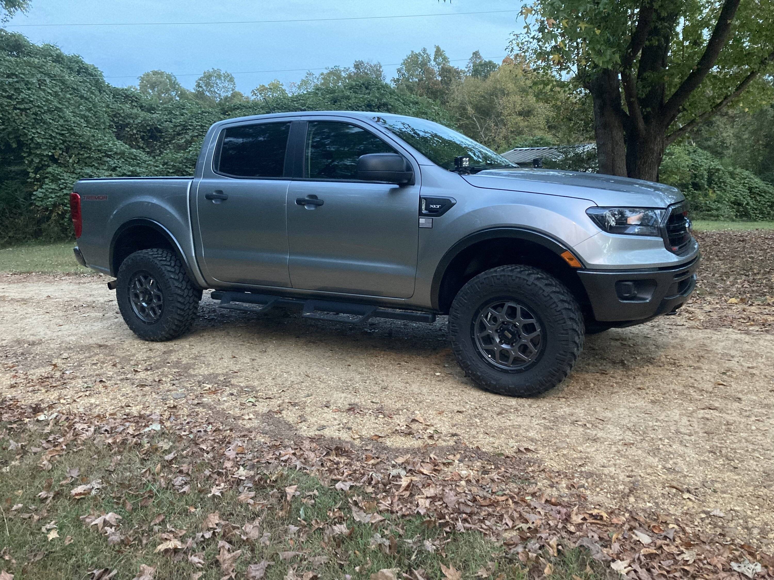

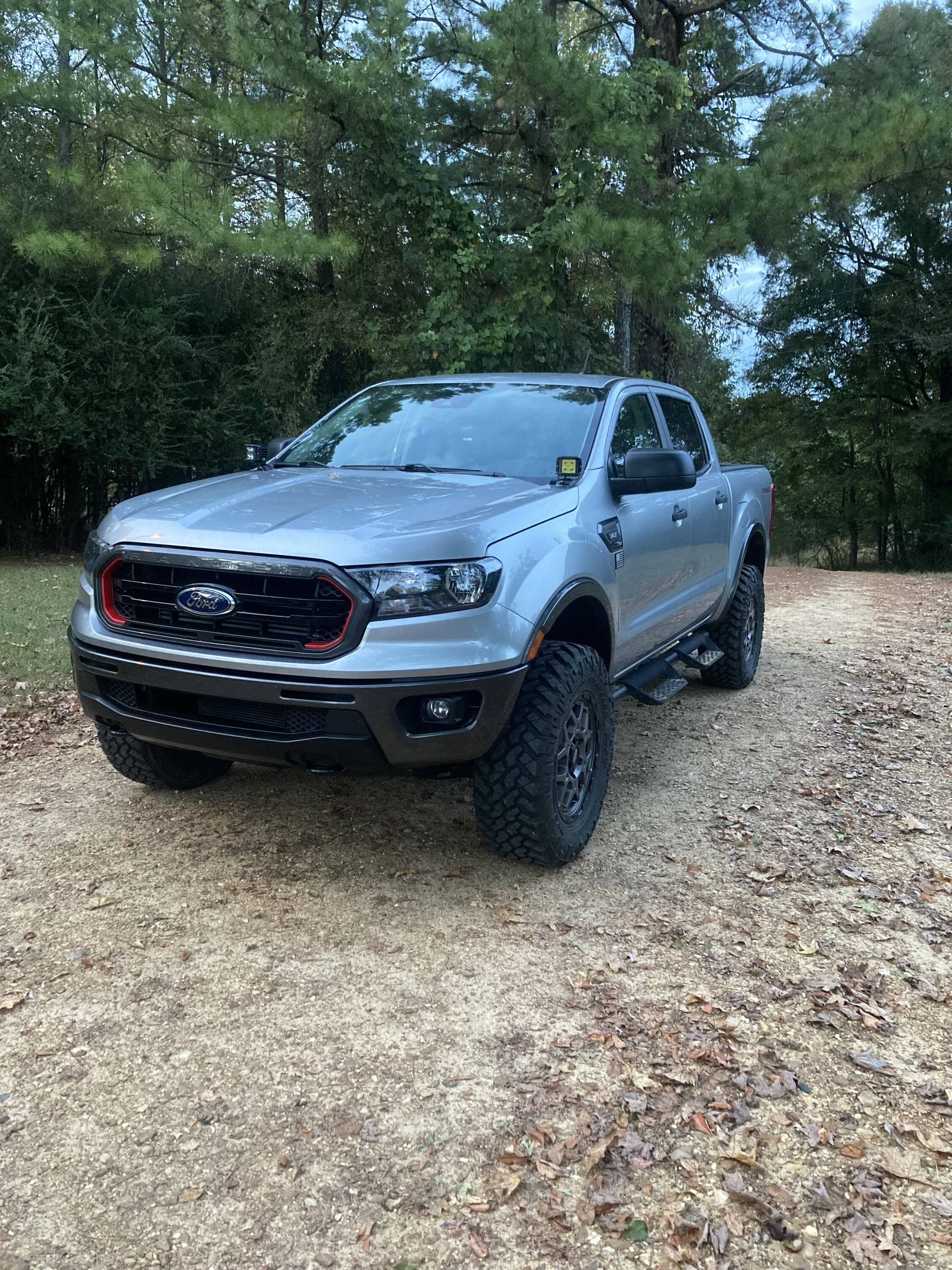

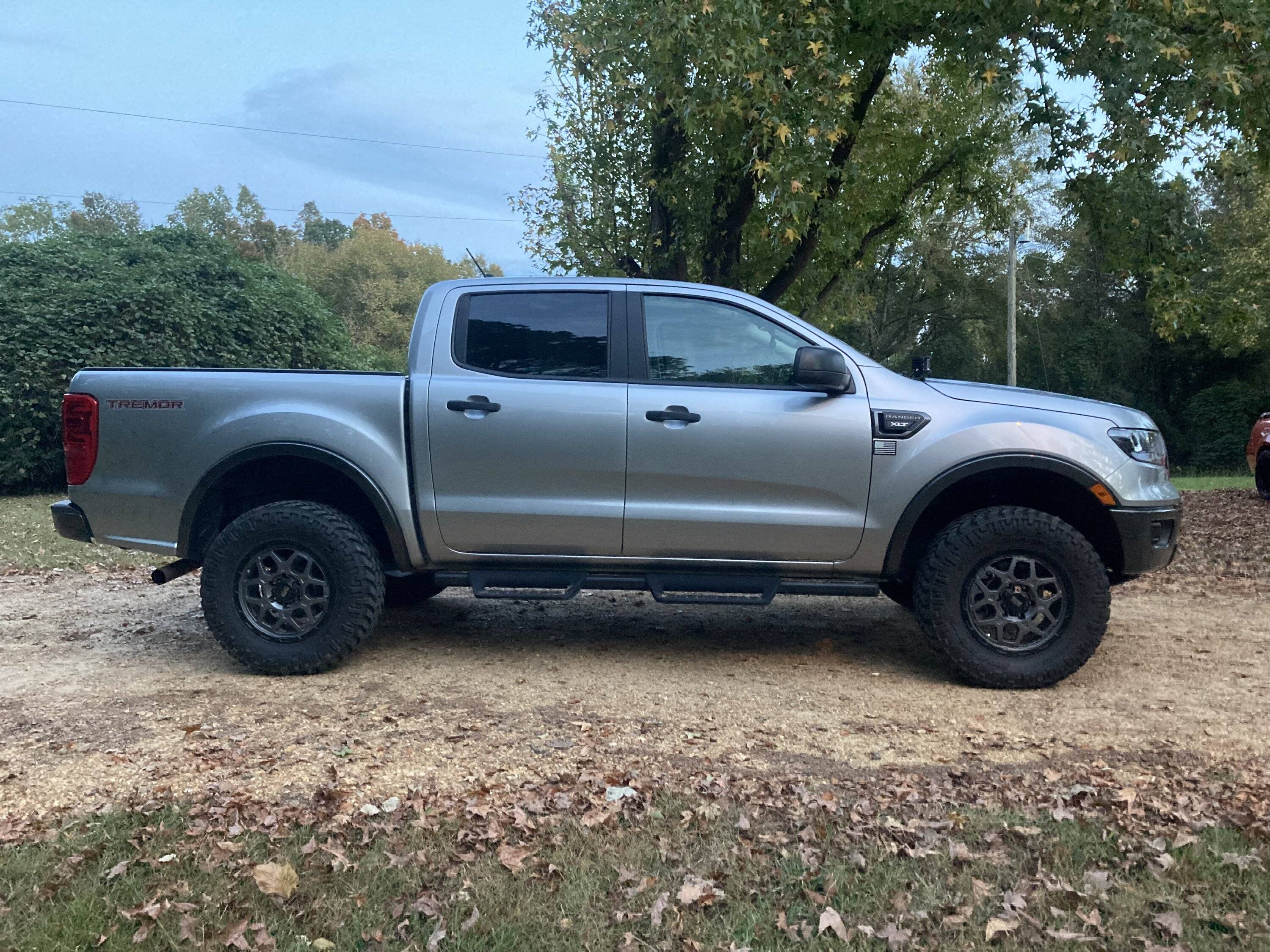

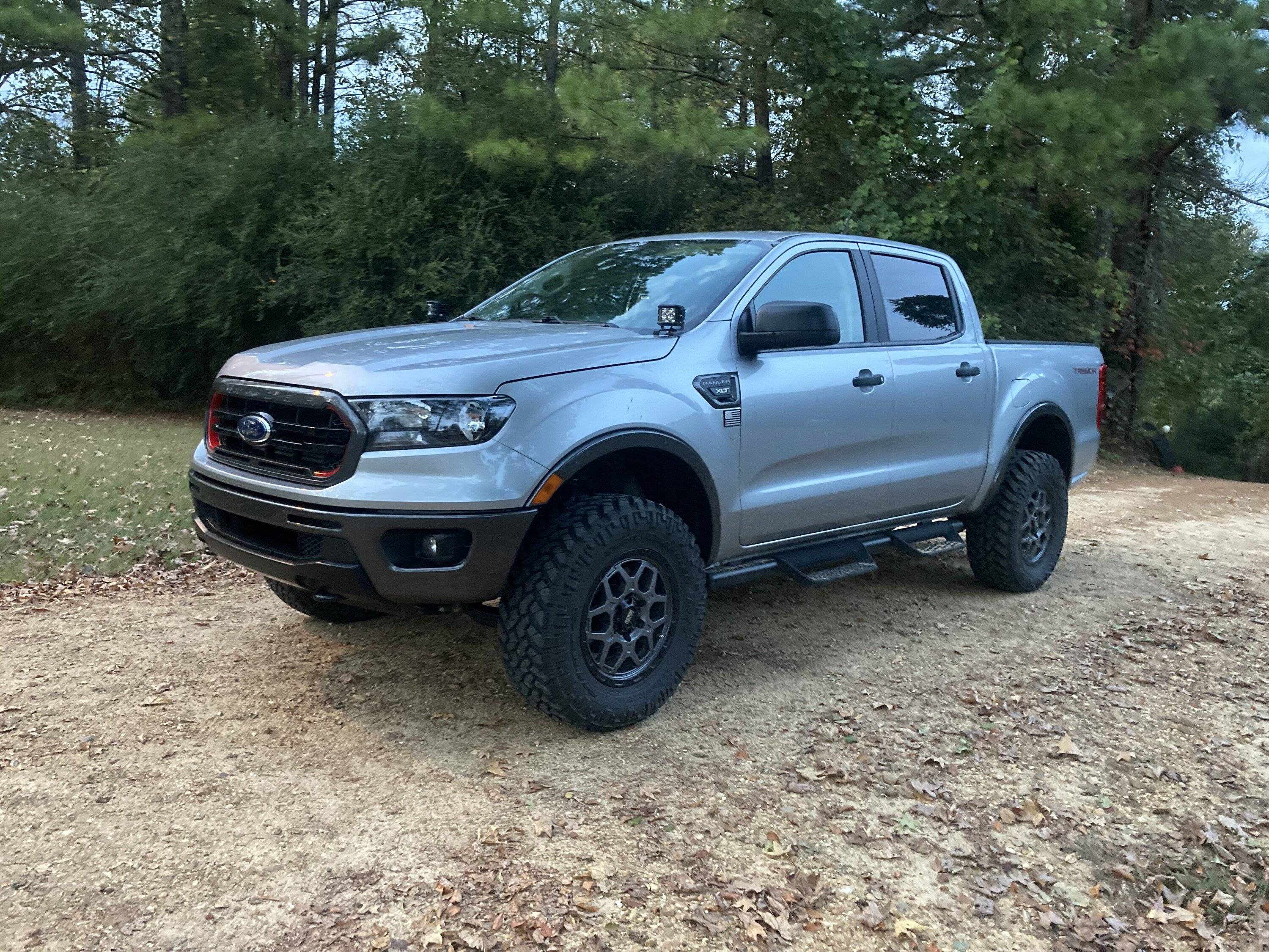

Just wanted to share my setup in case anyone is wondering about fit or looks . +25 mm offset Sport Terrain TK12 wheels , Faction Fab 1” wheel spacers , and 1” level kit from rangerlifts. Also I had to remove front and rear crash bars and will soon replace with the high clearance versions. Tires are Nitto Trail Grapplers 265/70/17. Added a set of ditch lights also but can’t remember the brand . My favorite vehicle to date for sure.

Great looking truck, Is it possible to get the tires in the correct offset so that you would not need the spacers?
Just assuming your referring to the wheel offset then yes absolutely. I wanted to go with a wider stance when I purchased new wheels so I went with the +25mm offset wheels. After mounting the wheels I realized I wanted to go a little wider so I ordered the 1" spacers . The tires did rub the rear crash bar but just barely after installing the wheels. And after adding the 1" spacers the tires were rubbing both front and rear crash bars pretty bad so I removed them. If you wanted to keep the stock wheel offset (stance of the truck) then you would just purchase wheels matching the factory offset and bolt pattern or just use the stock wheels.
