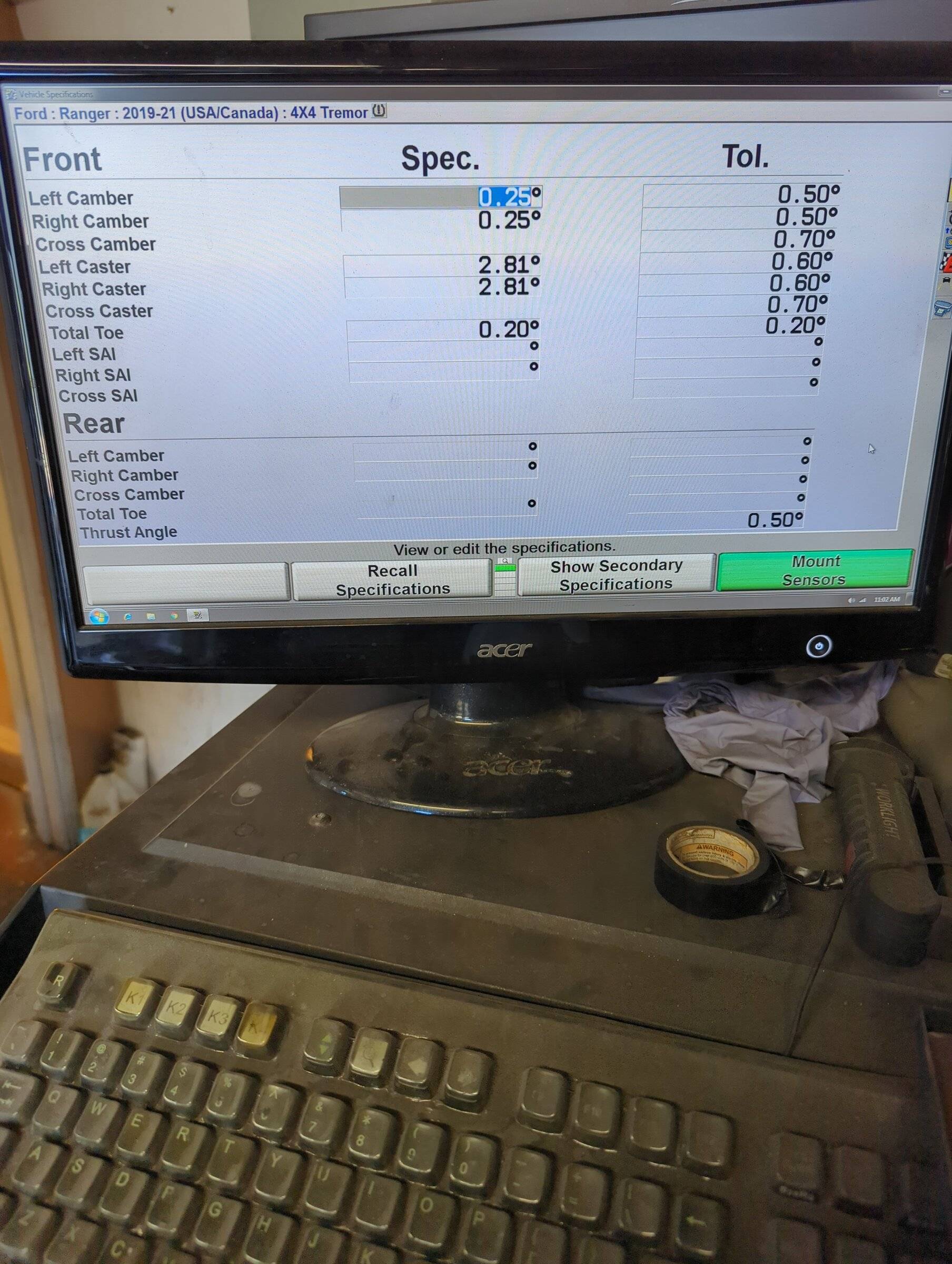

Measurements from a previous day were as follows at the center of the wheel well opening
Front 37.25" Rear 38.75"
Today, as parked on the street which would have been the same spot I measured
Front 38.0" Rear 38.75"
Even if it is only 0.75". I am ok with that. Looks good. Could be some front dip from when I parked but I wont be loosing sleep over 0.25"
I went to get it aligned this morning and the shop was having an issue with their sensors once they lifted their rack but baseline numbers were all green except the Caster was 0.3" out of spec in the red.
I will be aligning it at another shop tomorrow morning but I am not too surprised, drives straight. Just want to make sure things are more in the center of where they should be.
My buddy owns a tire shop in CA and he confirmed that the Tremor alignment specs are different than the FX4. He said the main difference was that the Caster calls for the same specs on both sides for the Tremor and FX4 has a different value on the drivers side.
