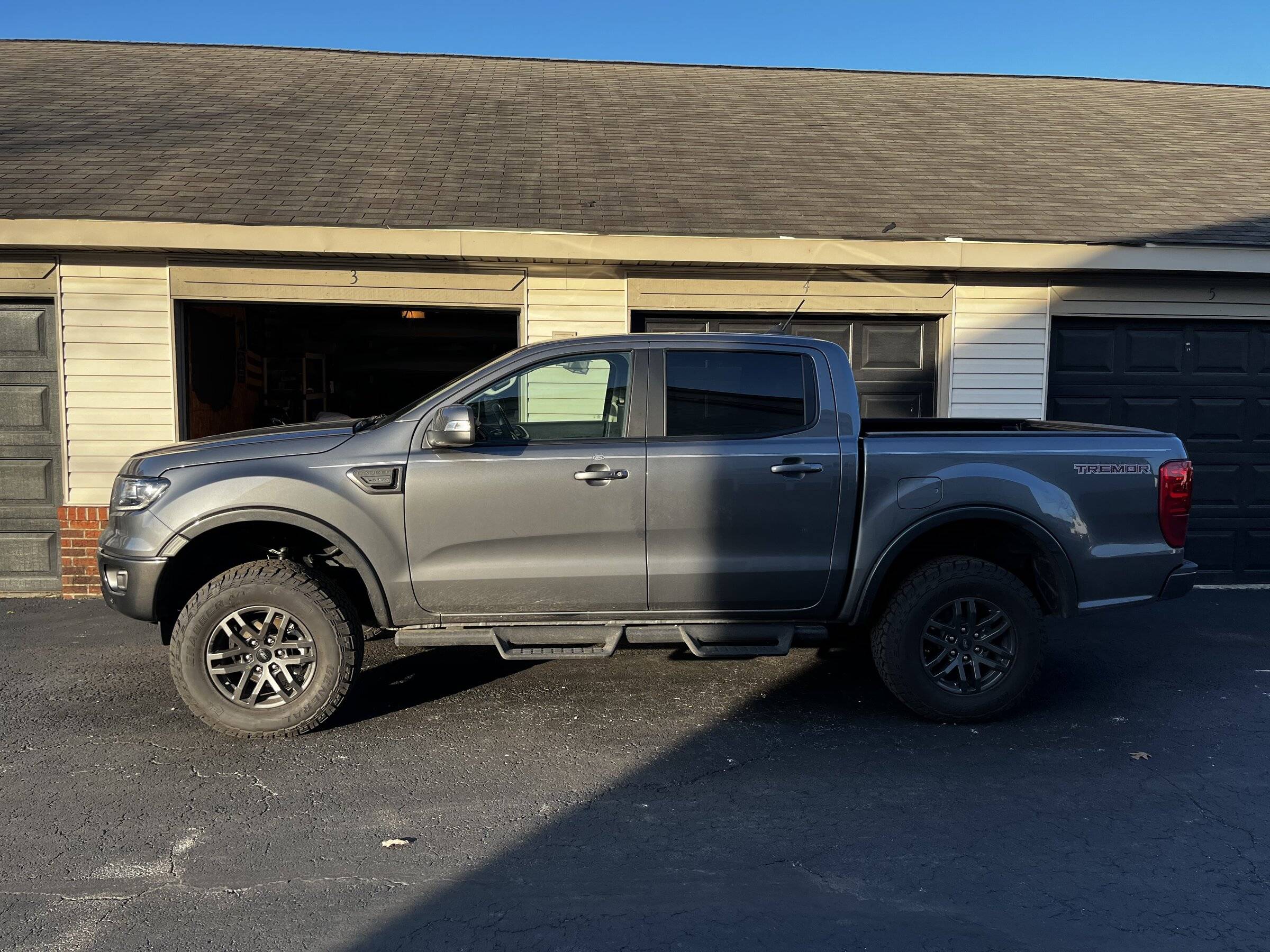

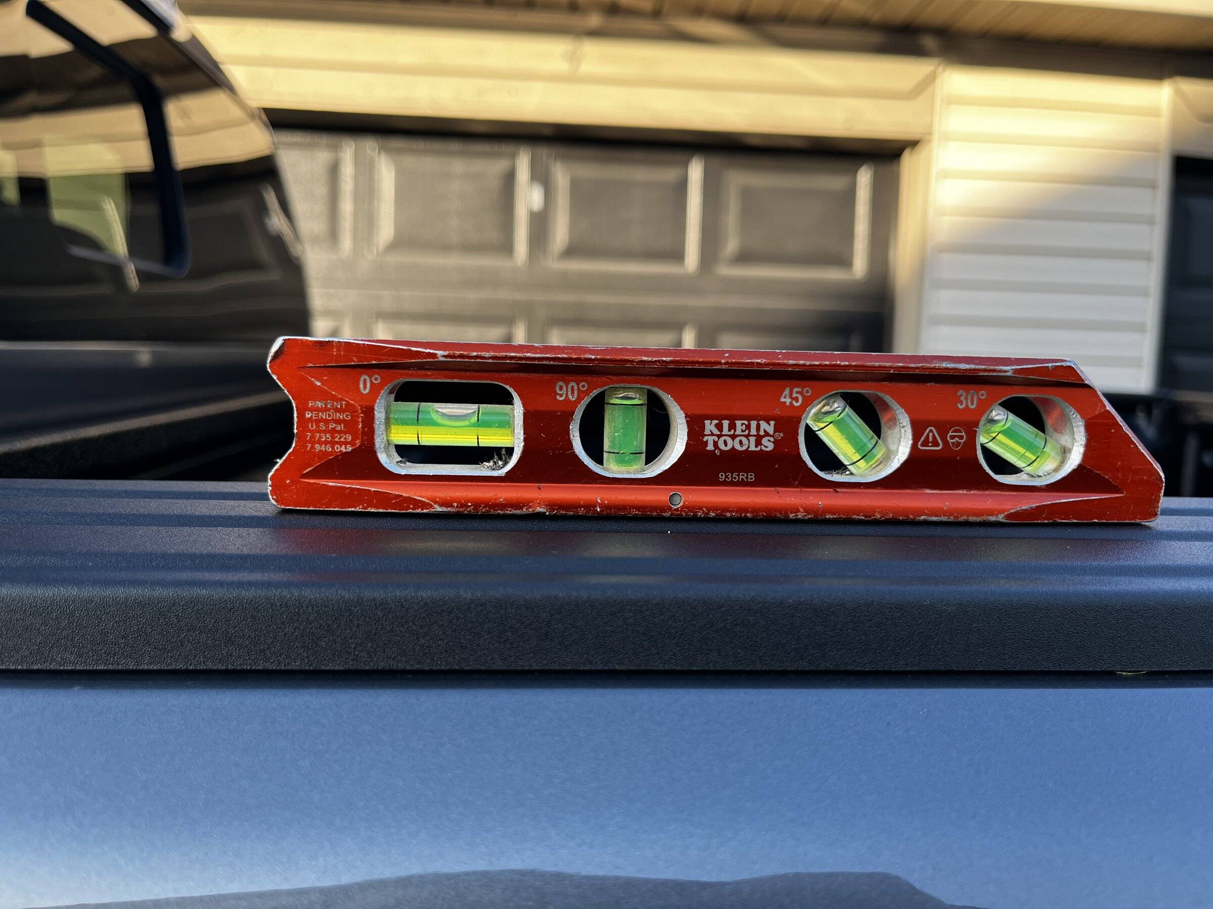

Tremor 2” level from ford ranger lifts.
Gr8Hortoni
Sep 12, 2021
80
227
Subaru, int in a 5G
Trucking
How does the drive with this setup? Any off-road articulation yet? Looks good!
Since I tow I initially was thinking about just the 1" front, but lately been thinking about 2" front with 1" spacer in the rear (along with 1" wheel spacers). Just don't want to mess with how good she tows our travel trailer.....so I am on the fence.
Haven’t had it on the trail since installed, will update once I get some feedback.
on road wise, perfect. I love the stance and the height, I’m hoping with pulling crash bars I can run a 285/75 (33.8”x11.2”, basically a small 34”), but I’m gonna run out the 265’s for a while yet, just spent a chunk of change on my next add on (589Fab mid rack). Make sure you get an alignment afterwards, but we were fairly close,they just had to adjust the toe a little bit. As long as you get it aligned you shouldn’t notice any difference really.

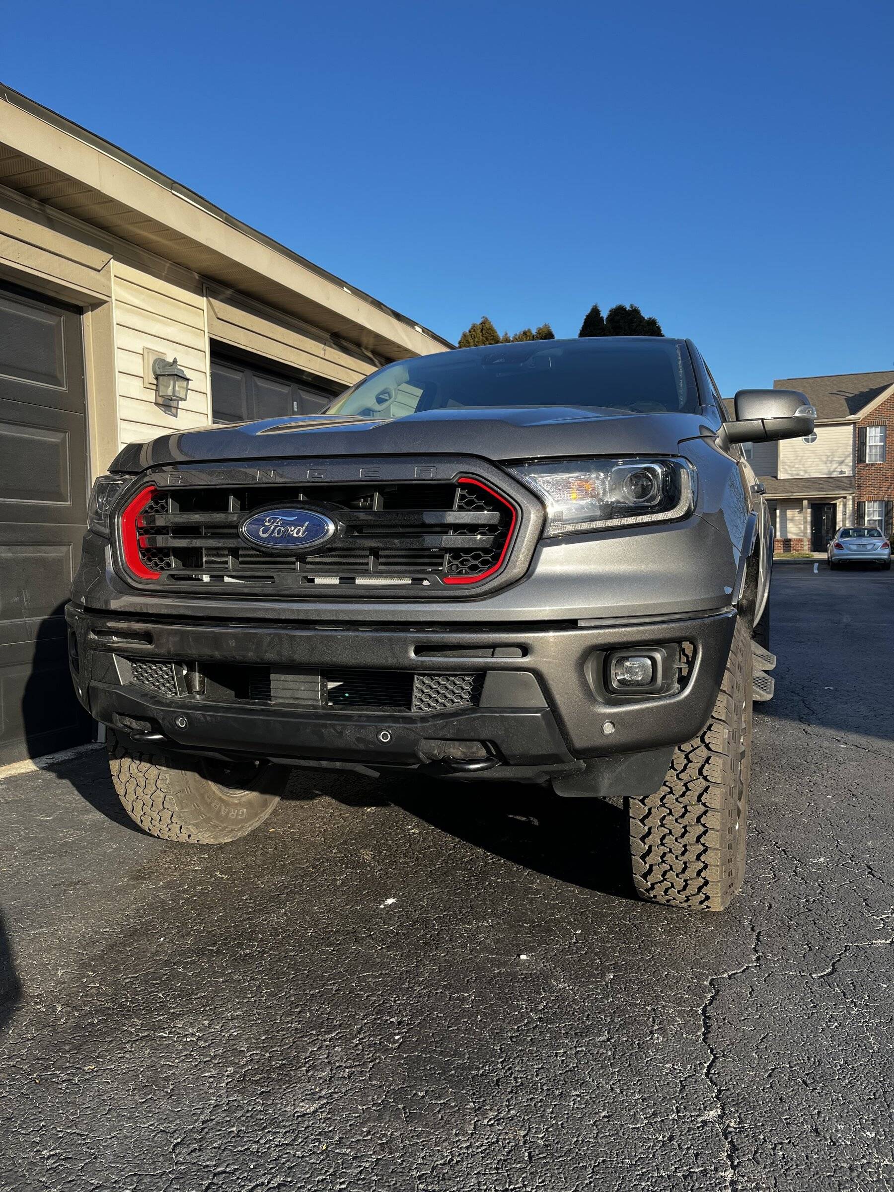

For sure on the alignment. Good to hear. Have you posted more pics in another forum post? Curious on some other angles. Nice that it is a Tremor, eliminates the guess work comparing with FX4 pics.
I haven’t. What are you looking for, I can get them. I took before & after of wheel wells just for comps.
Was curious how the front and rear from an angle looked like. I want to run the stock tires for a bit too and curious how it will look.
Appreciate any pics you can post.
