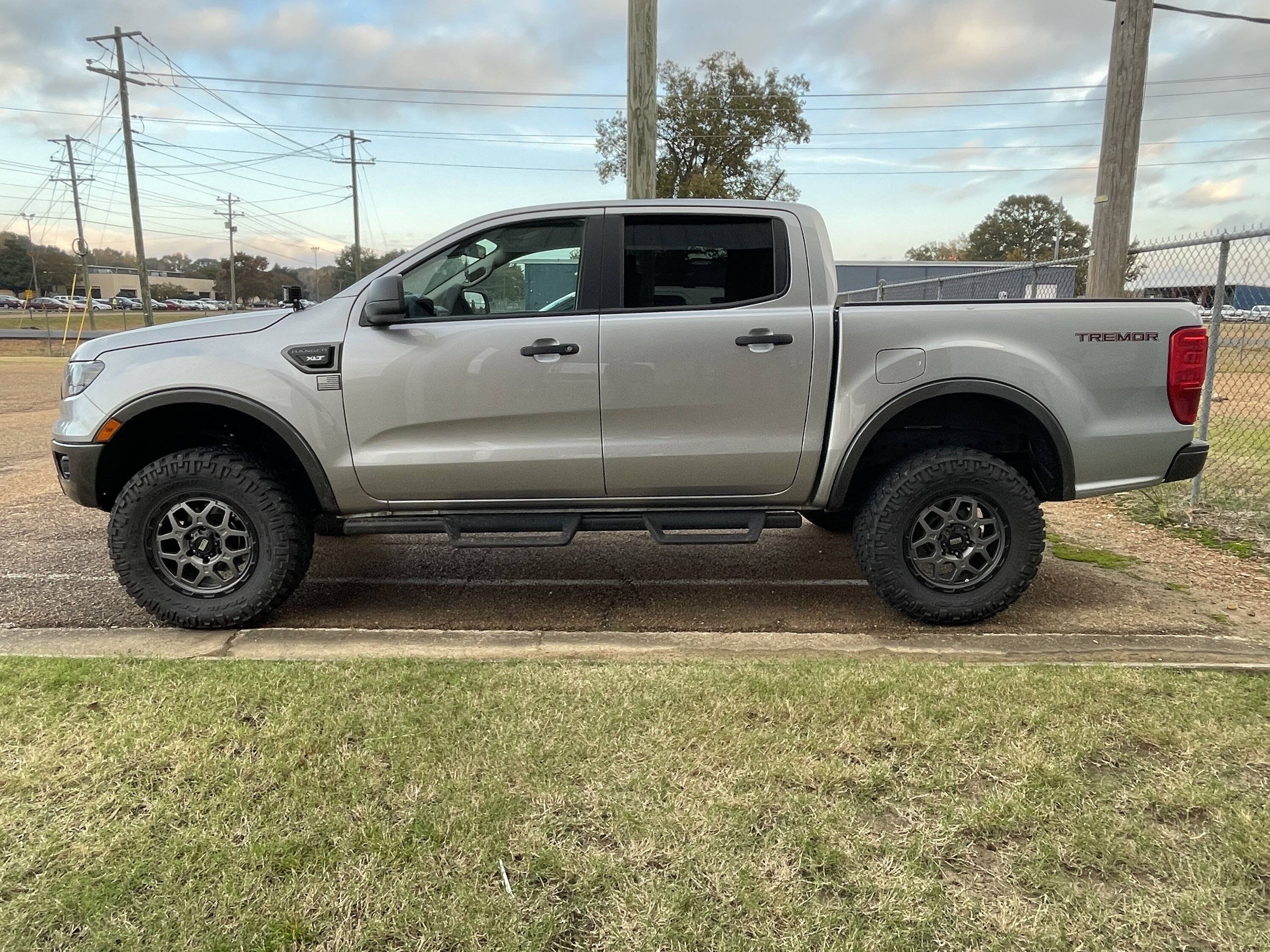

‘21 Ranger Tremor with +25 mm wheels and 1” level lift pics
EAC83
Erin
Dec 31, 2021
80
Pope, MS
2021 Ford Ranger XLT Tremor
The wheels are 8” wide . Since this picture was taken I’ve removed the 1” level lift and installed a 2” level and added the 1” rear BDS shackles. Truck looks the same just 1” taller front and rear . Also installed a diff drop up front to eliminate a subtle vibration issue .

What diff drop did you get?

I got this one from the suspension specialists.
https://thesuspensionspecialists.co...-2-3-lift-kits-fits-2019-2020-ford-ranger-4x4
I had my doubts about this kit but I’ve been running it for several months now with now issues at all . Took my front end vibrations completely away. Installed myself in about 20 minutes .
Awesome! Do you happen to have a pic of the current axle angle? I'm trying to compare this to the rough country 3.5 lift drop. The rough County involves cutting and more parts however
I don’t have any pics but I’ll try to get a couple and post them for reference . I do recall the driver side dropped more so than the passenger side . I believe there was 1/4” difference between the two . The rough country drop kit should accomplish a more even drop. I did have to drill a hole in my factory mount to install this kit but was a very simple process .

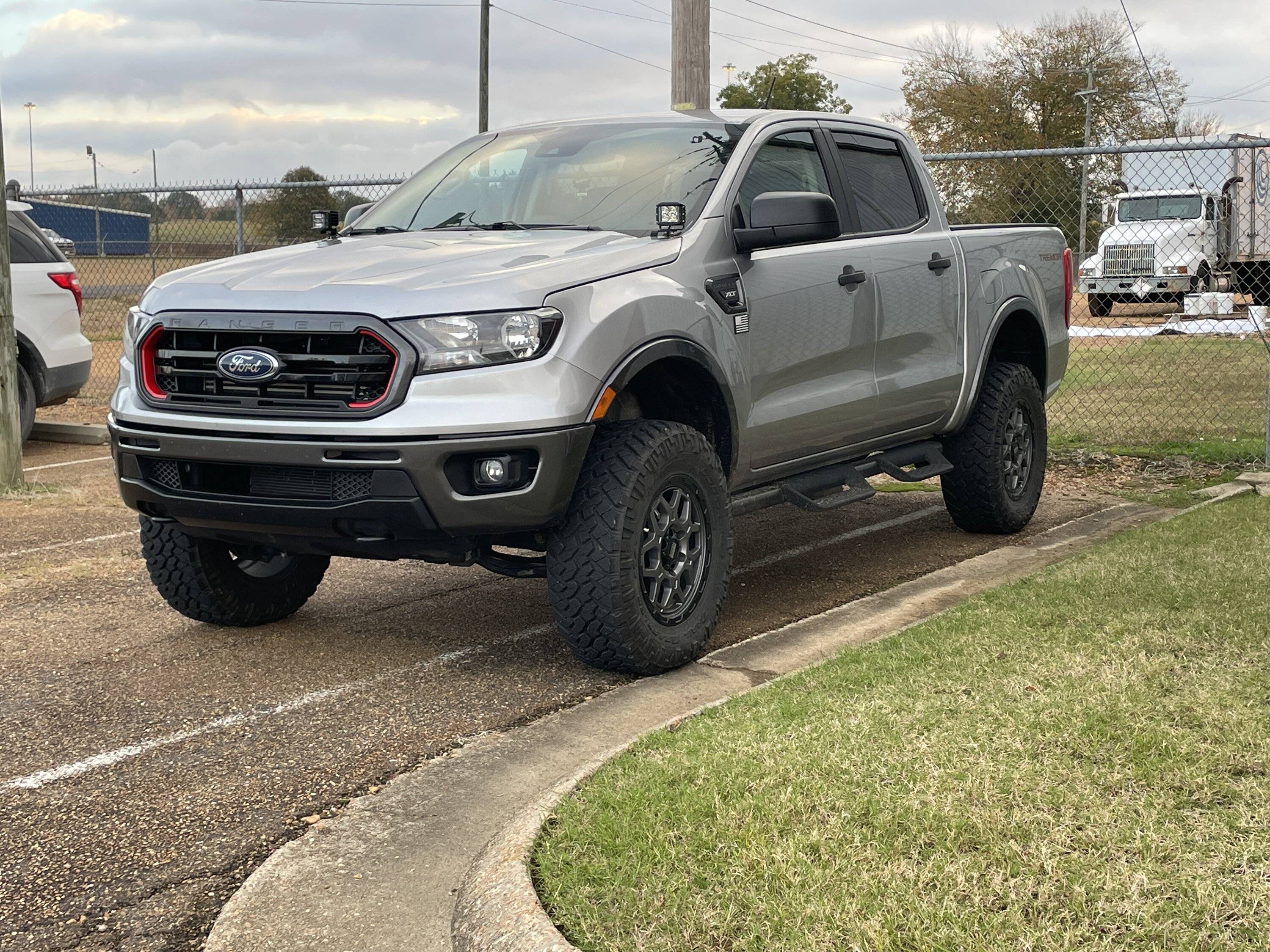

I like the ditch lights, do you get much glare off the hood?
Depends on the direction they are pointed. If pointed straight ahead there is “some” glare. If pointed off to each side slightly there is minimal to no glare.
Interesting. I'll have to look into them, going out to my rural property I'm constantly worried about deer just out of view of the headlights and those look to be exactly what I need
