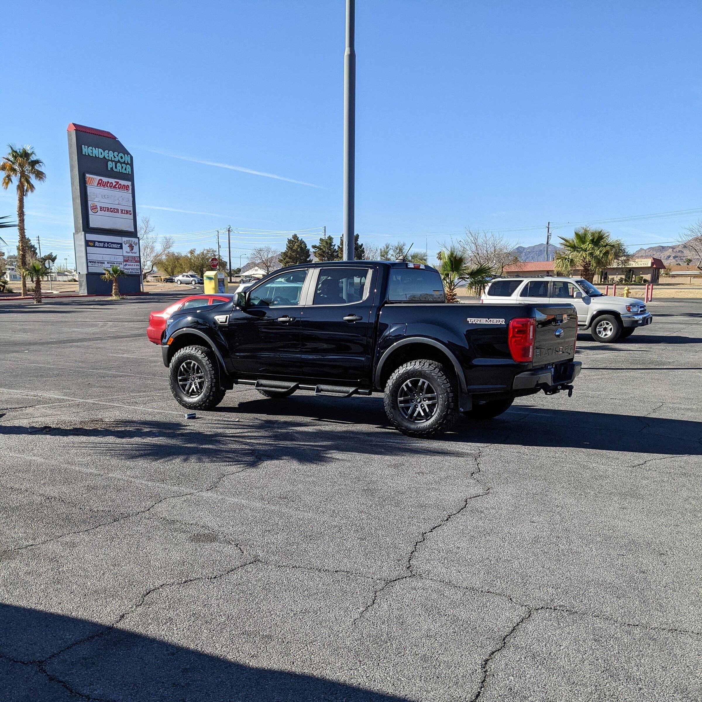

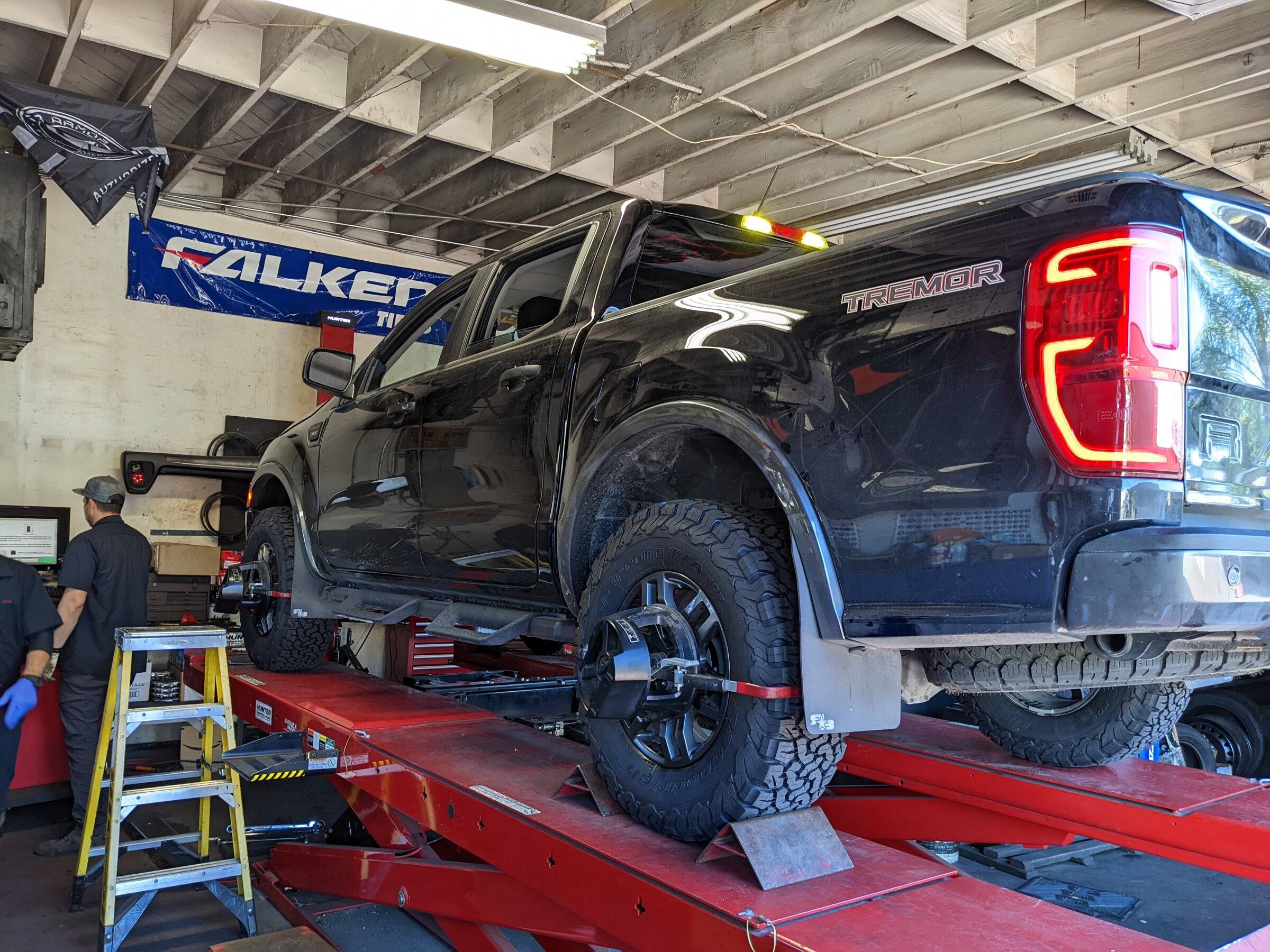

Well, figure I would update. The Tremor now has a 1" level and 285/70/17 KO2 tires.
Had to remove the intrusion beams, will get high clearance ones soon. Was kinda spontaneous, went to my buddies shop for an alignment after having two shops do a bad alignment after the 1" level. Next thing I know we are doing tires too lol

This is probably my next move.
It looks great!
Thanks man, I am totally in love with the setup. I have not articulated the suspension yet off-road with the new tires but zero rub on the street which was a concern for backing up our trailer. Took this quick snap of it when leaving the meat market this morning. Just washed it last night but hoping to get it on dirt this weekend.

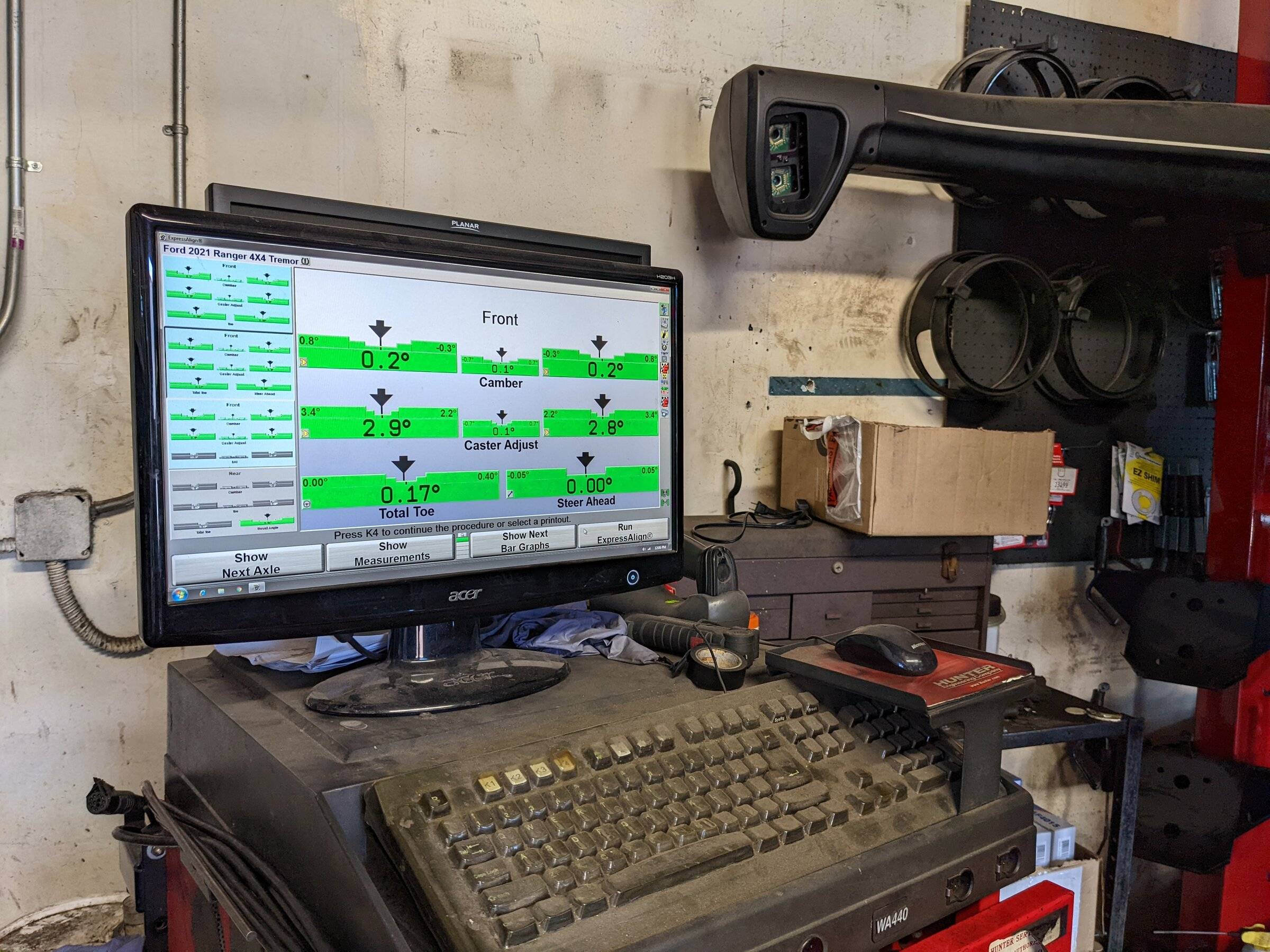

Huh, I had the rub you described only when I was at stock height. With the 1" lift it went away. I wonder if the caster alignment is off a bit. Either way, the high clearance bars should do it.
I made a thread with the Tremor alignment specs, I was surprised to see how few shops had 2021 vehicles in their system at this point, considering it is 2022. It is because they are not paying for their updates from Hunter, not because Hunter does not have them (one shop lied and told me that).

It is funny how much you can feel a difference by just being off a little bit. Also the care the tech does in placing sensors on and such matters a lot too. Verify they have the 2021 model vehicles in their system, Tremor specs are different. It was so noticeable that the truck drove better than the last alignment.
