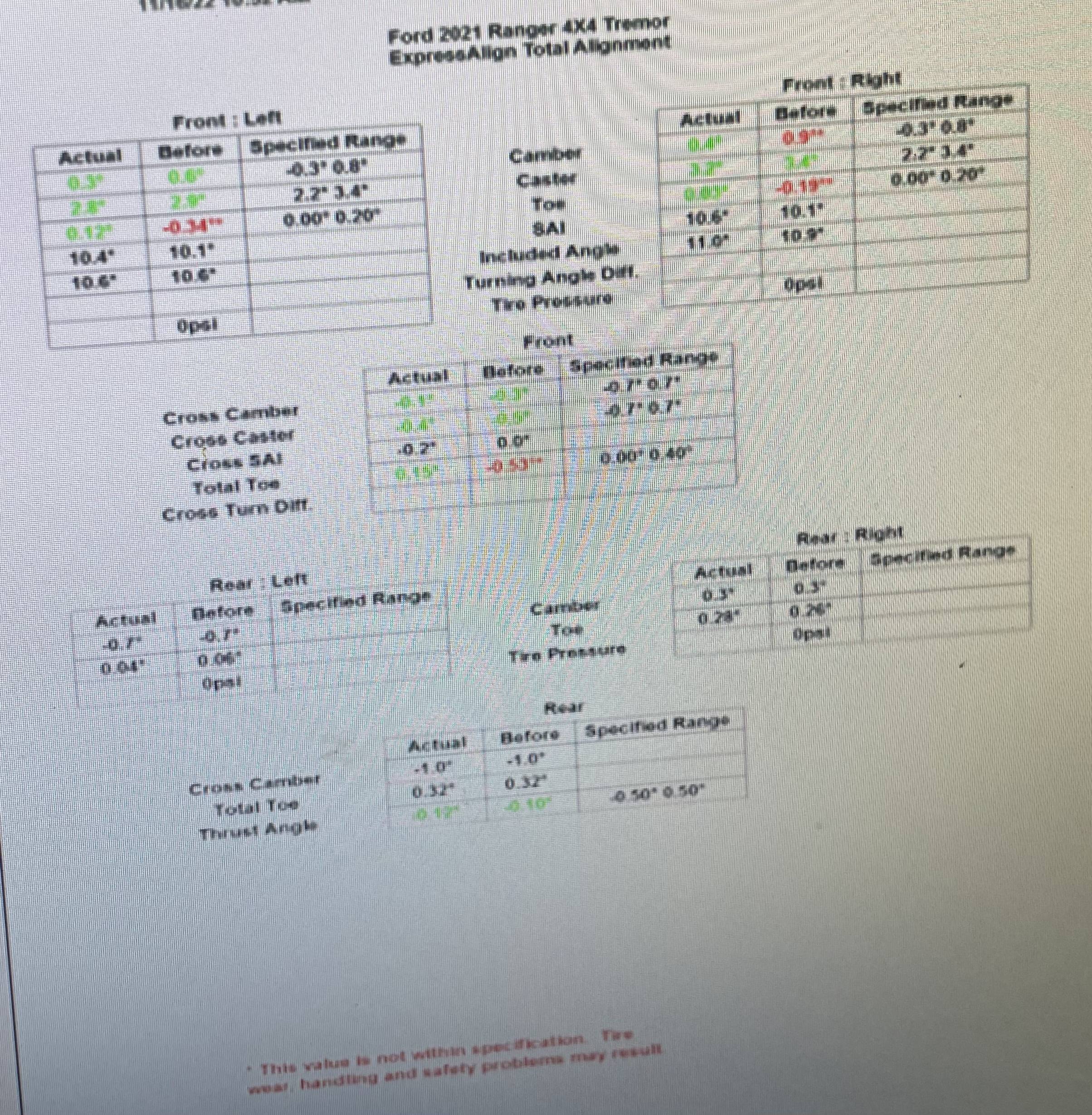

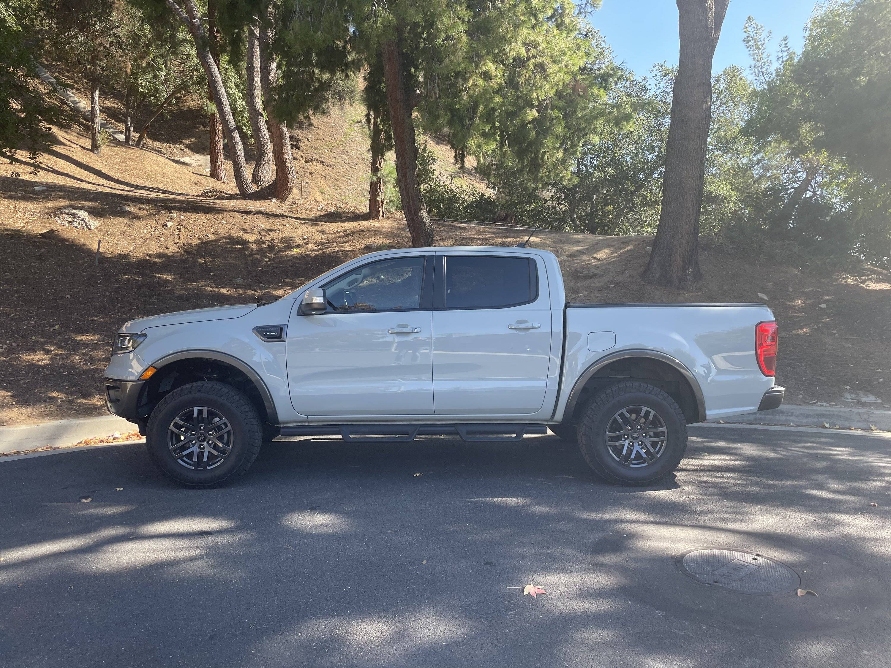

Just got the 1” level from fordrangerlifts installed.
I like the change - subtle but perfect in my opinion. Still minimal rake but much improved.
took shop 2 hours to install, including alignment. They charged $450 (including alignment) which I thought was a little high but they did a good job.
Off road kings in El Monte, CA.
Attached are alignment numbers - don’t know what they mean really but they did say they used Tremor Specifications.

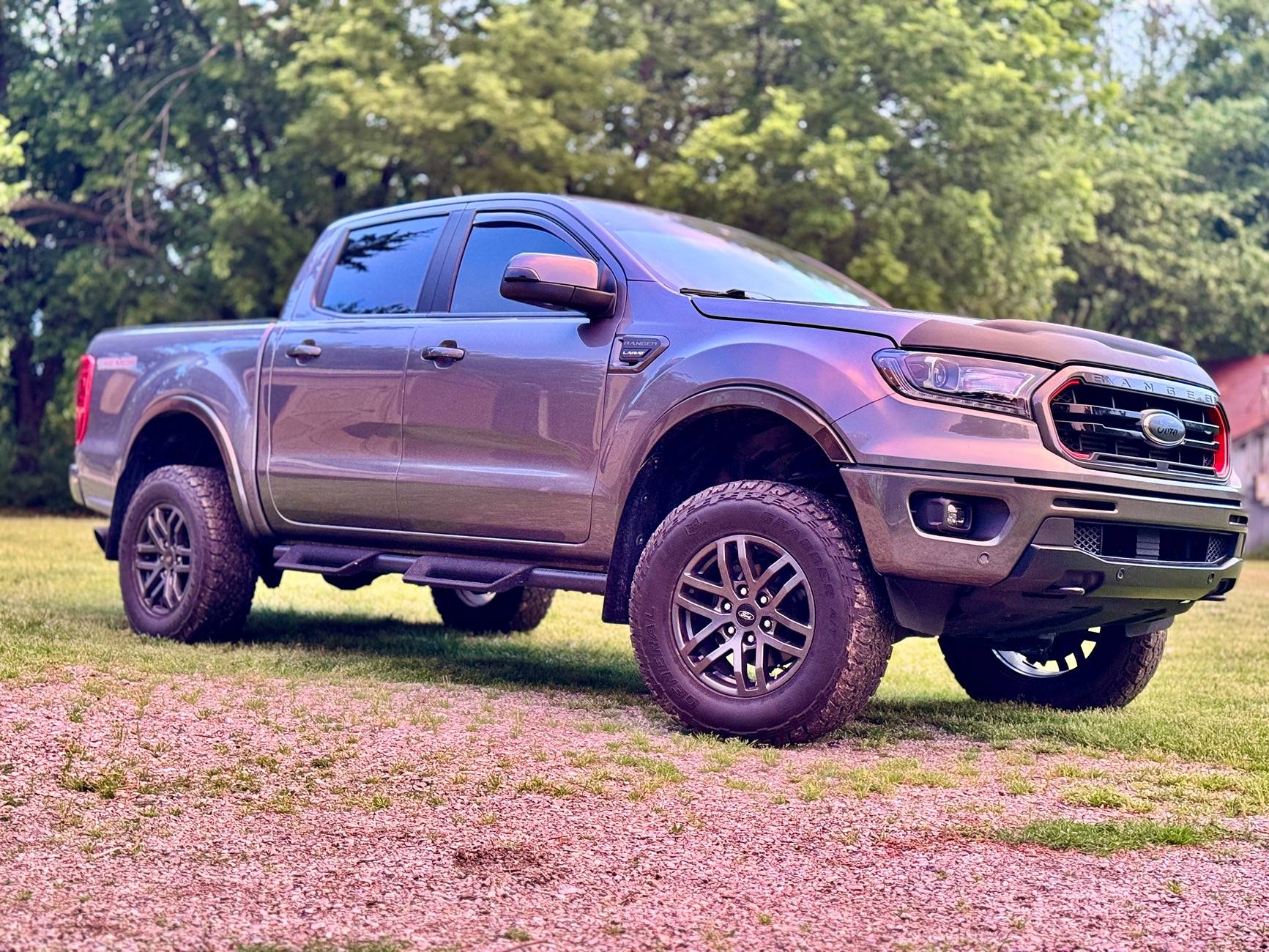

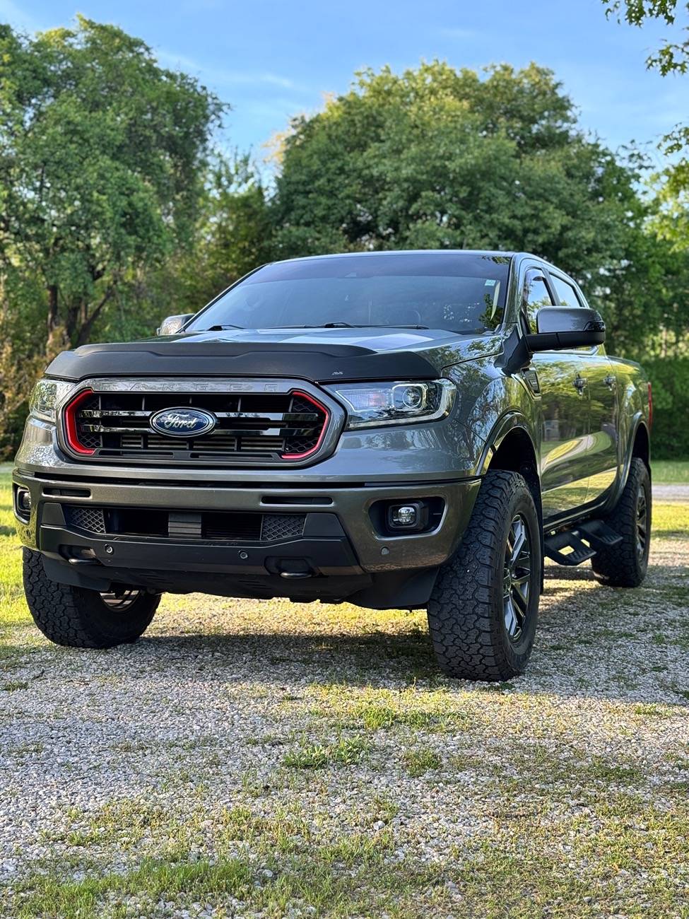

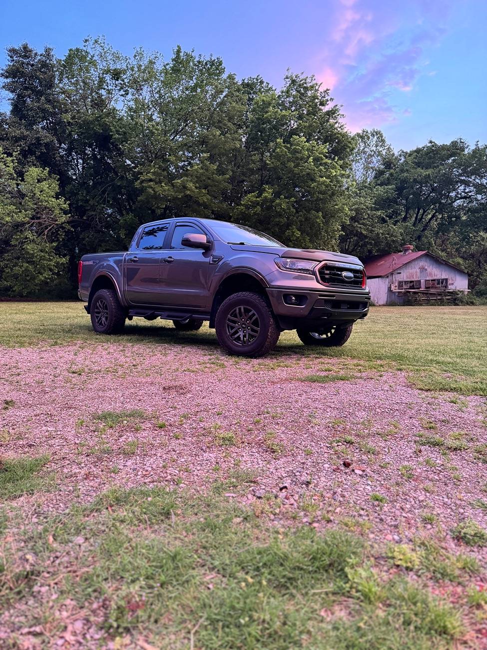

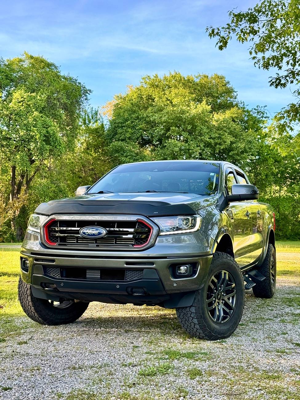

To those of you that’s gone with the 2” level kit, do the stock Grabbers now look too small? Like, do you get that annoying voice in your head that says “yep now I freaking have to size up cuz these don’t look right” Any of that going on with you fellas? I’ve always done a level kit to my Chevys when I drove a full size and that made them look so much better but I always just dropped it off at a shop and said please make my truck level and i never cared enough to ask any details on how many inches itit had to come up.
awd.nv
Anthony
Apr 26, 2021
30
1,264
2,394
Las Vegas, NV
'21 Ranger XLT Tremor
Computers
I felt that way with the 1" level lol

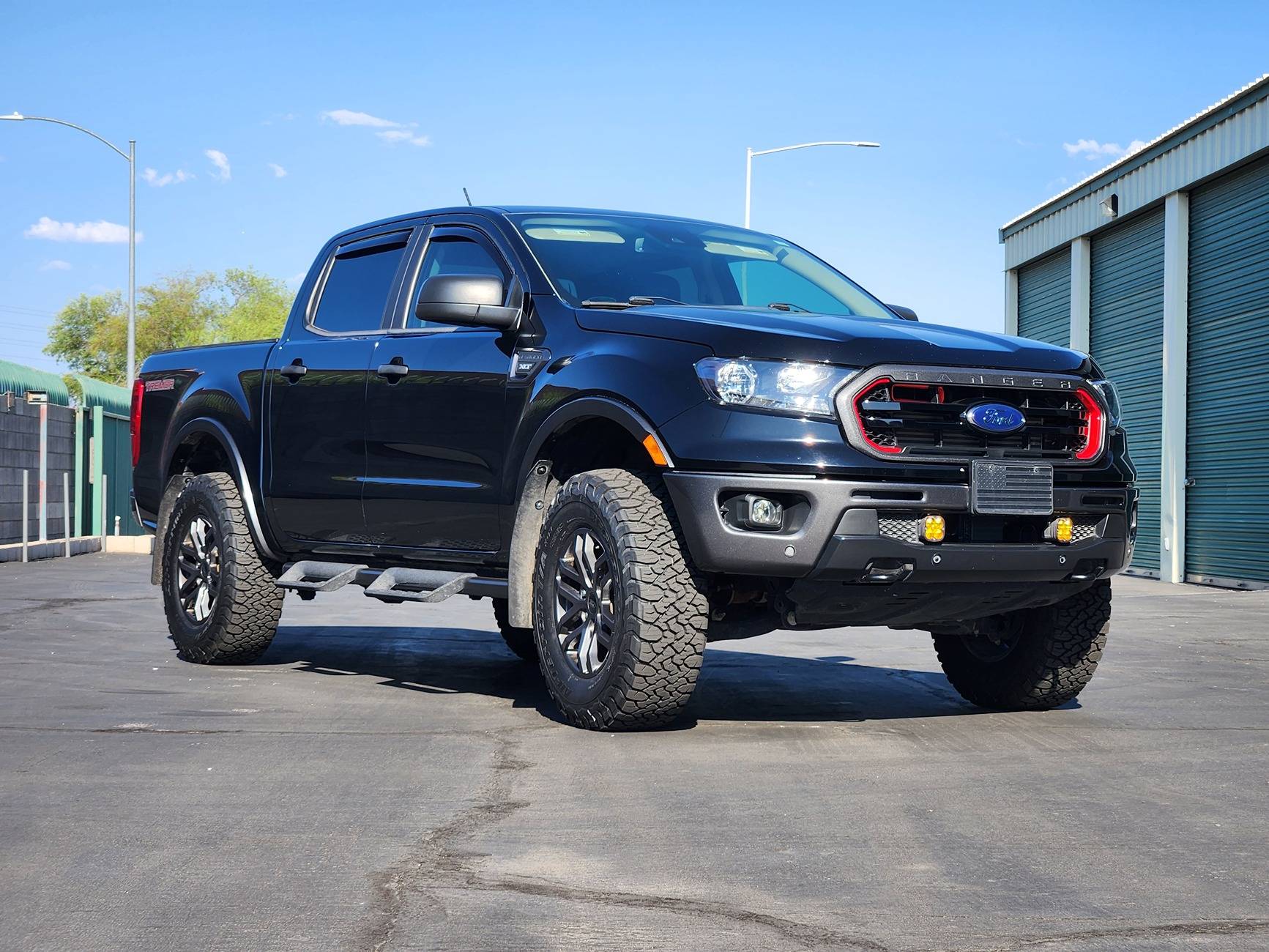

I went with a 1" level, 1" wheel spacers and 1" taller tire. It almost looks like the Ranger Tremor in the Ford app now lol

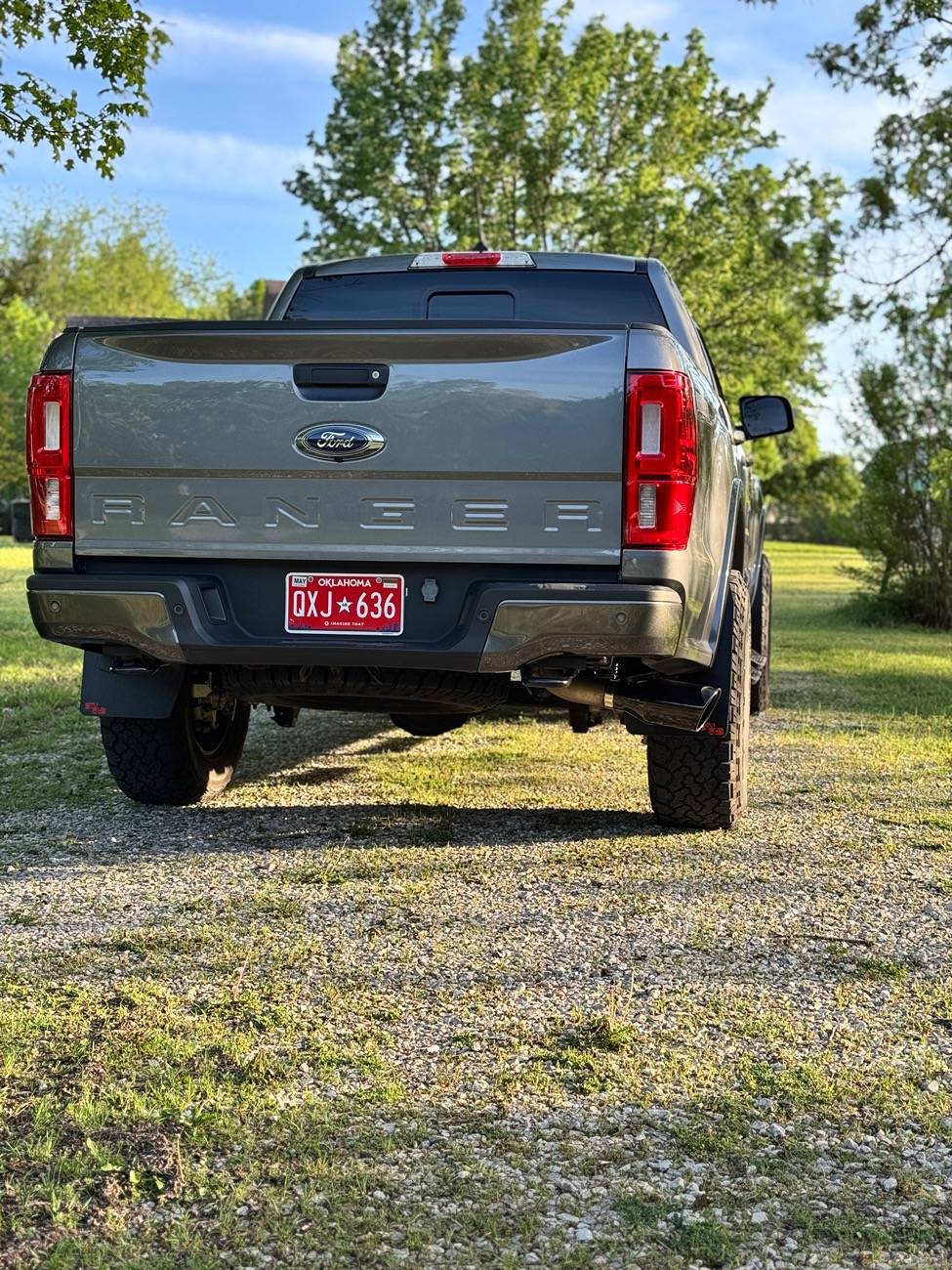

Can someone who had the sense to measure where headlights were before they got the 2” from FRL ? I forgot to do that before I had my level installed. Is there a rule or something I could look up possibly?
almost forgot..
OGMix376
Bryan
Jun 30, 2024
1,033
3,530
almost forgot..
Idk what the specific height is, but DOT I think is the beam top should be approximately 2-2.5 inches below the height of the headlight fixture at 25ft.. don’t know if that’s the top of the fixture or center of fixture or bottom of fixture though. So if you have a flat level area with a wall that can give you the 25ft away
jdamtb918
Jon
Mar 11, 2025
129
Tulsa
2021 Ranger Tremor
HVAC Tech
That’s just the info I was looking for. Thank you sir!

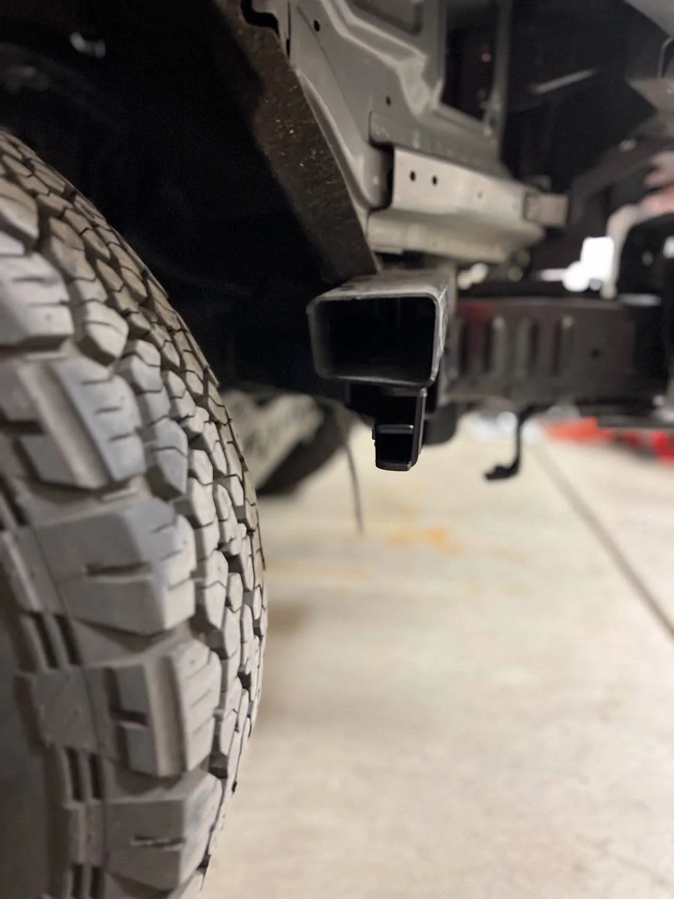

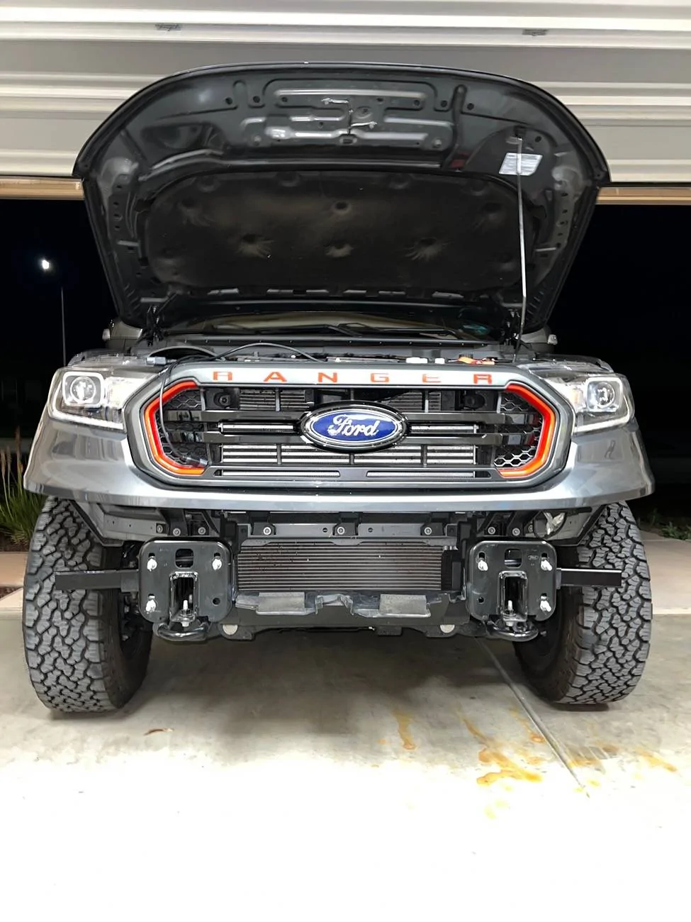

  1. 2 inch lift from Ford Ranger lifts
    • Shock travel remains the same so no changes needed obviously
  2. 2 inch blocks in the rear (irrelevant really)
    • Travel increased on shocks, so it gave me the excuse to put in some really awesome Bilstein 5160s (I think that’s the number)… gives another 2 inches of travel, has a brushed stainless look with a reservoir that can be mounted remotely, or on this really awesome looking piggyback clamp that’s black and went really well with the brushed stainless kind of look.
  3. Readylift high clearance crash bars
  4. The only thing I see potentially needed is to trim that front wind dam, which is right in front of the tires and off to the side of the skid/bash plate, and it’s secured by a little metal piece sticking out.
    • I ran 1.5 inch spacers, and just looking at it, except for that one part, there is a lot of room even with the spacers!
    • If you are running without spacers, you might not even have to trim or get rid of that little trim piece, because with the 2 inches in addition to the .9 inches
  5. And just to give you an idea, I will be running the exact tire size labeled as 33 x 12.50R 20. Those wheels will be 20 x 9, and will have. +0.00 offset
    • That should stick them out around 2”-2.5” on each side. That’s quite aggressive, I will admit for sure, but I actually am doing it on purpose, due to the look I’m going for which will require a part that will tame the overly aggressive tire stance
    • I am putting on fender flares and they are generally adding 1.5 to 2” of coverage on the width, which would put these tires probably at about .75”-1” past the fender flares
    • To me, it’s absolutely perfect and will give the illusion that the truck is actually wider than it is. The Raptors always have that wide look and it will be similar, except for I also believe they have a bit wider quarter panels and rear quarter panels or whatever they call them.
    • But the tremor has a wider track and I’m not sure if that has anything to do with the actual panels or whatever. I don’t really care, because I think I will be very happy with the set up.
The picture above is when I put on the dual 6 inch light bars that go in the little trim piece that looks like it should’ve included them in the first place. It gives a nice view of the high clearance crash bars from Ready Lift!
This picture shows the difference between the stock crash bars and the ready lift hi Clearance. You gain practically 2 inches… Maybe 1.5 inches in the front and 1.5- in the back.
also, with the high clearance ones in the picture above, where they are basically installed and the factory bars are just sitting on top of it, you can just see how much more stout they are! You’ll see the three horizontal pieces that are thick and extremely strong. The whole thing is much thicker and it’s going to protect much better! The other one is just big… It doesn’t necessarily protect and I have a feeling that it would be like a straw under any type of force. Not the ready lift model
So to me, the gist is that you will have plenty of room, and the only reason it was even tight was because of my spacers that kicked the wheels out and changed the geometry.
But now that I’ve added the crash bars and I’m ready to pull out that wind dam, it’s going to be plenty of room for wheels that are the equivalent of spacers along with the bigger tires!

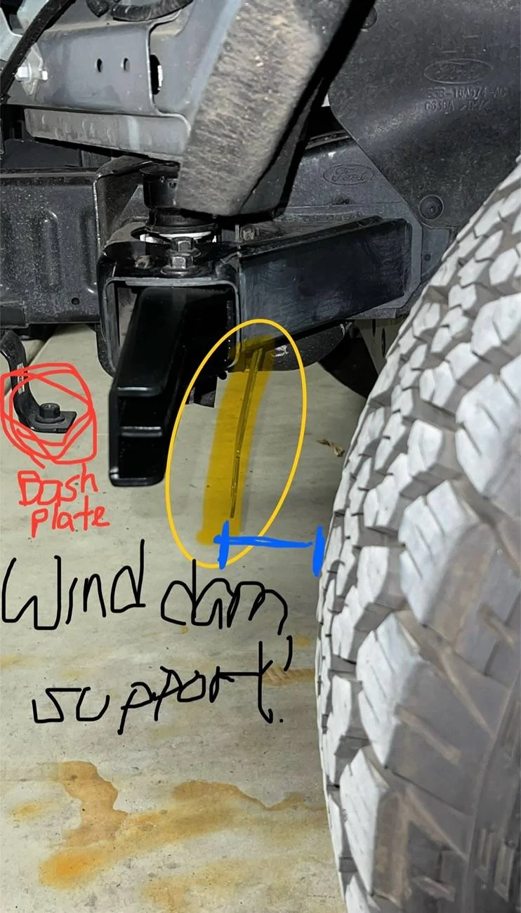

I marked out some of the pieces with different colors. The red is where the bash plate secures and as far out of the way.
The yellow circle is roughly where that little air Dam Goes, and the highlighted piece is a support piece so it doesn’t flap around. I’m pretty much planning on taking it off automatically and either cutting that support piece way up pie or if it’s bolted, That way.
As you can see, that ends up being the closest spot in the least clearance, so when it boils down to it, that might be the only part that needs to be changed. I really have a strong feeling that’s the case; especially if you are going with a factory offset! And maybe because of that you won’t need to touch it
but it’s also nice and I don’t have a picture, but the rear crash bars also free up a noticeable amount of space.
And if you look at the aftermarket crash bars, you can see that the metal is much thicker and has these horizontal support pieces that just makes it stronger. The factory is quite thin, and I would trust the aftermarket ones and the strength of them way before I would trust the factory ones! They feel like just hollow and weak after thoughts for (Direct) collisions to the tire, and then into the cab from there
I hope this helps!
